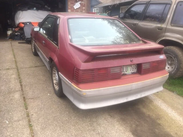

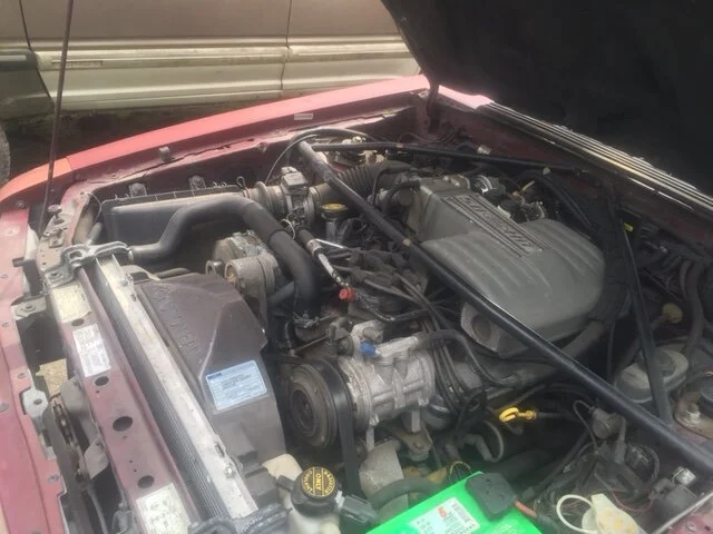

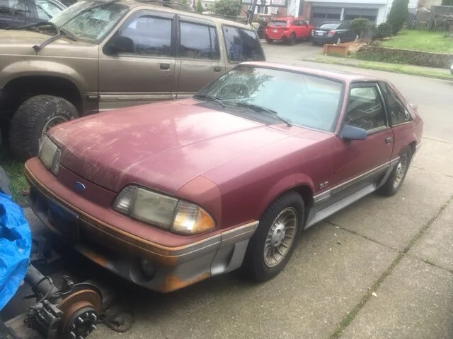

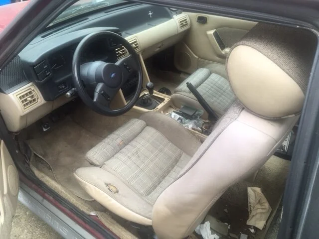

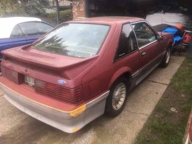

I got this car last Wednesday. Since it needs some work I figured I would start a build thread. I did a few on my Pinto's back in the day but never one for any of my Mustangs. Anyway, I picked this 89 GT up from one of my best friends. His father-in-law bought it new. Gave it to him for Christmas in 03 I think. It was my buddy's daily driver till about 3 years ago. Then he drove it off and on and then when all the little things wrong with it piled up he parked it. He realized he would rather focus his time and money on one of this other cars so he decided to let this one go. Gave me first dibs since he knew I would fix it and give it the attention it needs. The car has been sitting for over a year. I threw a charged battery in it and fired right up like it ran yesterday. I was surprised. Driving it the 4 miles back to my house proved to be a challenge due to drivers seat being broken. I had to hold myself up by the steering wheel and push the clutch in and drive at the same time. All and all it is a real solid car that needs a bunch of TLC. All the parts he had came with it.
The car is pretty much unmolested. It has a Tri-ax shifter, underdrive pullleys, and a strut tower brace. He bought 3.55's for it back in the day buy never put them in. Other than that, it has just normal wear items done. The plan for the car is to daily drive it. I LOVE driving my Saleen but there are so many idiots out on the roads lately that I am scared something is going to happen to it. I am going to mod this one and do some of the things I wanted to do to my Saleen and then didn't because of originality. I will try and post some pictures from what it looked like the day I bought it home. Not sure how many I can do. I use to use photobucket back in the day but not sure what else is out there these days. Anyway, here is goes....

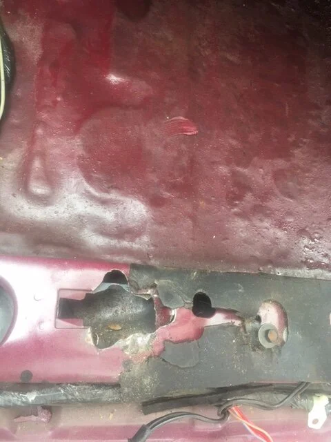

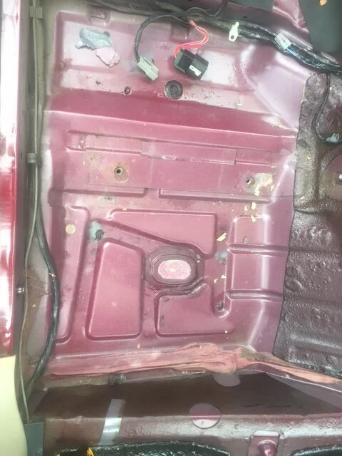

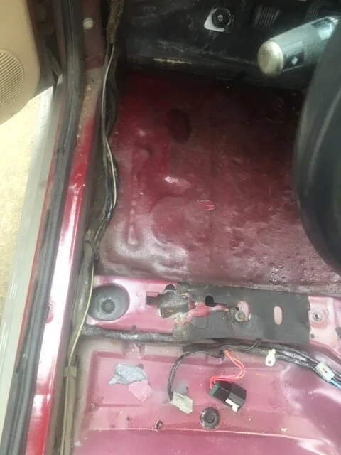

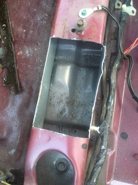

Instead of going back yesterday, I decided to finish taking out the interior of the 89 so I could assess the damage to the seat and floor pan. I know my 86 like the back of my hand but it has been a while since I have taken apart a 87+ car so it was a bit of a learning curve again. I got the carpet out and was presently surprised. I figured the floor pan would be cracked like the one on my Saleen was but I didnt see any issues with that. The front seat support channel is worse for wear though. I cut a pieces from one of my parts cars like 8 years ago and gave it to my buddy but he never got around to put it in. Carpet was a little damp on the drivers side though so I will have to look into that and see if I can find where the water came from. So far no build sheet.
My neighbor buddy was going to weld in the patch yesterday but it took me longer than expected to get the interior out. By that time it was too late so hopefully later this week he can do that for me. At the same time, I am going to put subframe connectors on it. I have a set of old school Kenny brown super subs that I was saving for another car. I am going to use them on this one instead.

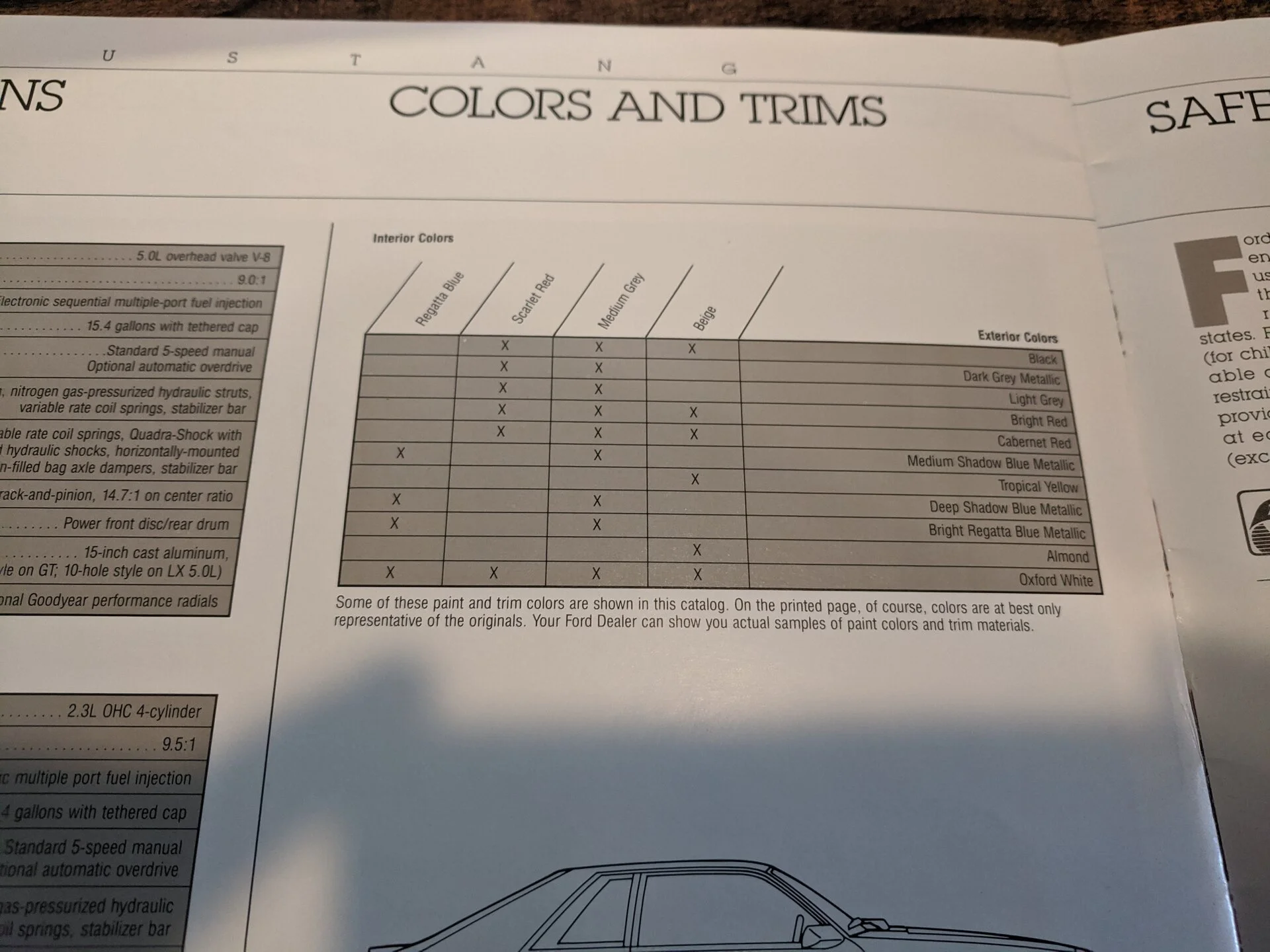

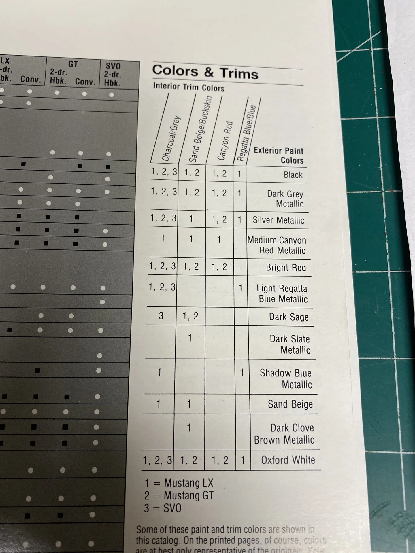

From the pictures it looks like that car has the sand beige interior. The only one I’ve ever seen besides my car.
Yes, sandy beige interior. I need to find a few things though. All the seat belt plastics crumbled. The ones on the rockers crumbled to a million pieces. There is nothing left. One of the door sill moldings is cracked too. Head liner got damaged when the sunroof leaked years ago. I have one out of a parts car I had but It is from a non sunroof car. Hope it works. Kinda worried where the dome light is on the non sunroof hatch vs the sunroof opening. Hope it is going to work. I work a couple miles from SMS fabrics so I should be able to get the vinyl for the headliner over lunch one day.

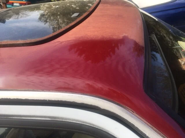

Worked from home today so I had some time this evening to tinker. Took some rubbing compound to the worst spot on the roof and then some wax cleaner. I think this paint is going to come back around fairly easy:banana: Then I went to my buddy's house when he got home and we fixed the floor pan where the seat mounts. It was dark when we were done so I just put the seat back in and did not take a pic of the repair completed. You get the idea though. Next up is the seat frame and subframe connectors. I will have to take the seat apart. Hopefully he will have time to weld both this weekend.

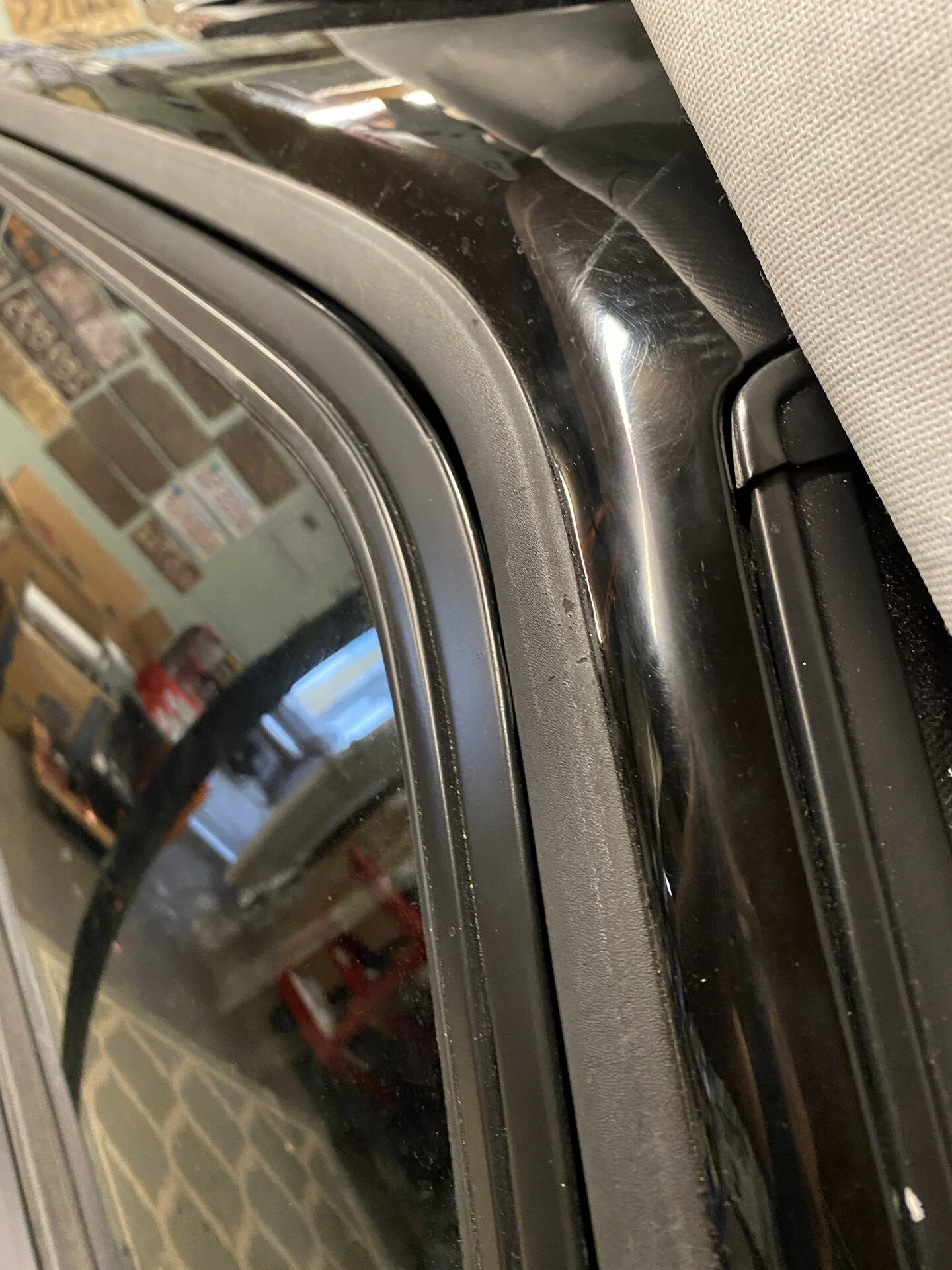

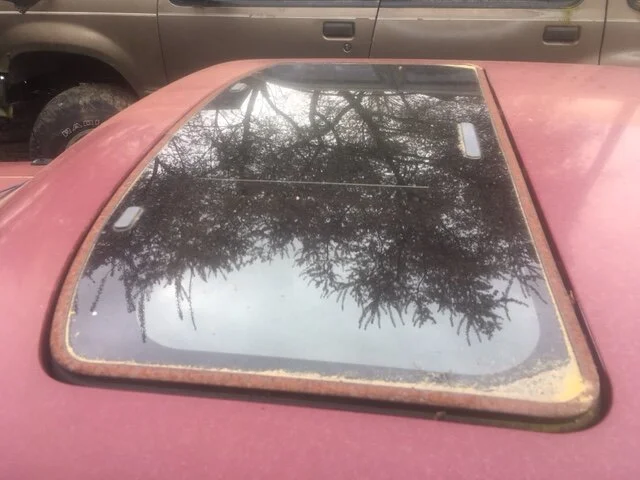

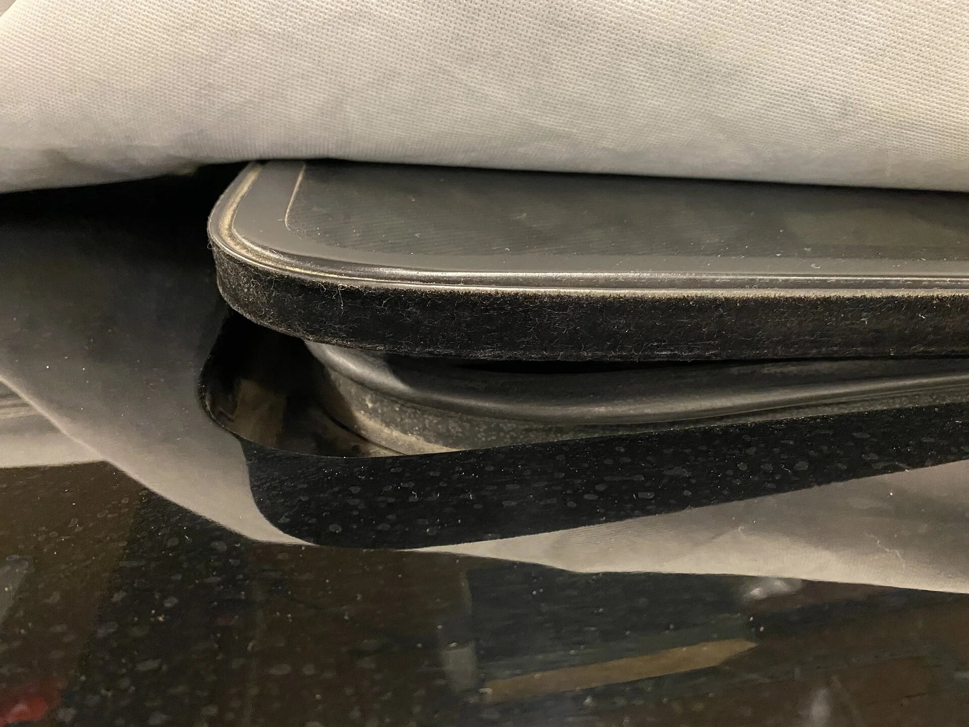

I am going to have to order a few things soon and have a question on the sunroof, is there a gasket or something supposed to go around the metal of the sunroof? Or is there supposed to be this much of a gap between the body and the sunroof itself?

Here are a couple pictures. Those are clouds reflecting in the paint not wax

There is a gasket around the sunroof. The repops are rather thin compared to oem which filled the gap much better.
