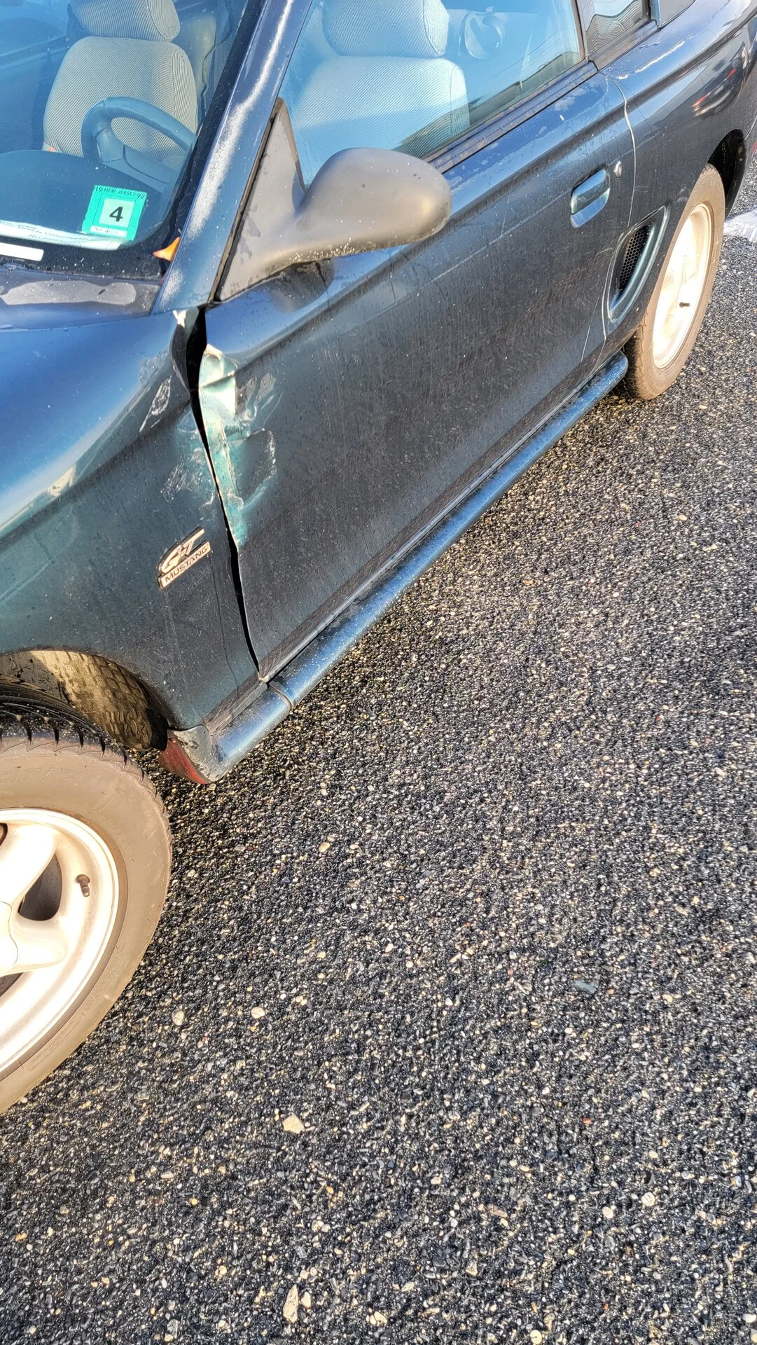

somebody banged into my 95 gt not too long ago, damage to the driver door and fender, right where they meet. I had to use a pry bar on the damage to be able to open the door.
their insurance is covering.
problem is, there arent any 'certified' suppliers of replacement doors and fenders so i would have to be on my own a little if i opt to get the damage fixed. the insurance company created the estimate based on used door/fender they located from a salvage yard.
apparently i may be over-worrying about getting something from a salvage yard because the boy shop would do the actual acquiring and if the parts come in and are substandard are not good enough to use, they can reject them and they can source better (and they would work with insurance if cost adjustment is needed).
regardless, i know there are several aftermarket sites that sell parts and such, but i dont know of any that sell doors and panels. is there someplace i can look to get such things, or should i just let the body shop find something suitable?
time is not a big factor.

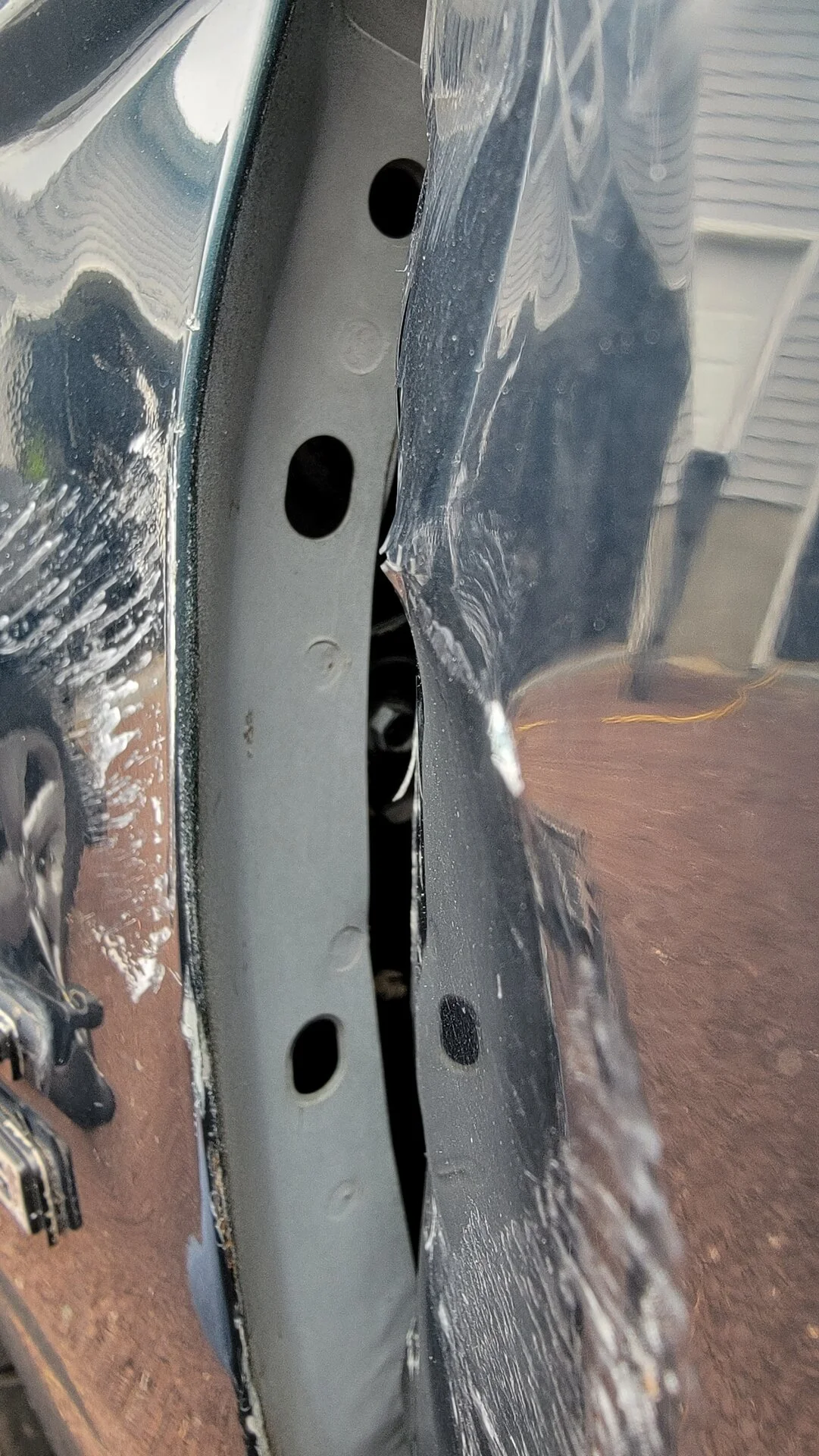

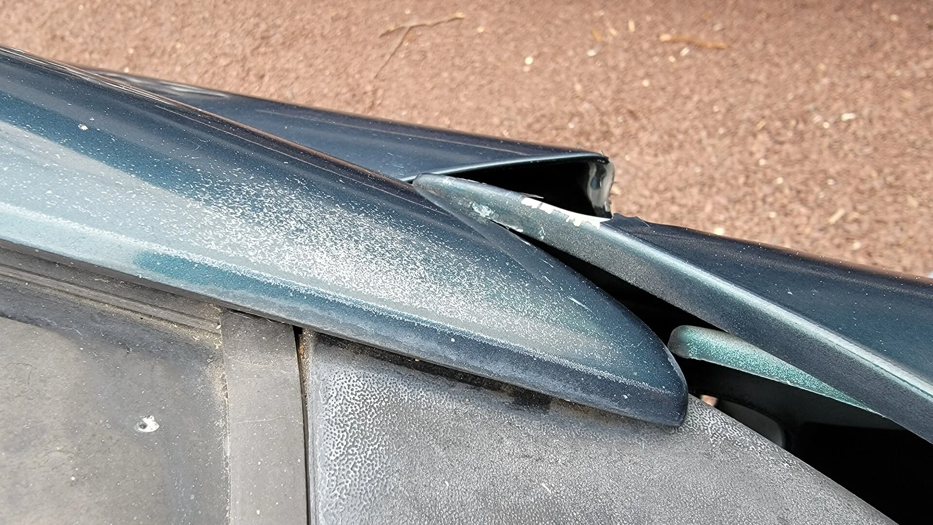

so i dropped the car off today, covered all the bases discussed above, no worries, but then the guy warned me that there is a chance that they find damage when they take it apart that could push the cost over the total value of the car. apparently if the insurance company totals the car, the body shop has to halt all work and they wont put the damaged parts back on the car, and it becomes a salvage title (which i dont think i care about either way really?). so now im worried about having to go through that hassle. it looks like the insurance has the car at about $4000 value and the estimate is $1750 or so. body shop saying if theres any structural damage the cost will likey go over $4000.
im no expert but when i look behind the dents, it seems the damage was in a perfect spot in that the damage is minimal and theres likely no structural. seems that the door and fender are simply bent in spots where there is nothing behind them. not sure if i am describing it well.
i told him to not do anything until i think it over.
i guess the only options are just leave it as is (and maybe pulls out the dents a bit) and just live with it (and pocket the $1750) or let them fix it and hope it isnt totalled? i really dont want to bother with sourcing parts myself, getting them painted, installing etc.
part of my thinking it over process includes hearing from you folks here.
what would YOU do (if you were me i mean)?
images attached below.
Thanks

he also told me that he took a look at the damage and he is thinking there will be some structural based on something or other. he seems to be on my side, and there is no benefit to him if there is structural damage because that would end the job.

IDK, I think the risk is low to them finding structural damaged based on what I see from the picture. There is a lot of metal in those A pillar / door frame sections and it takes a lot of force to bend that stuff in my opinion. The cowl cover and the drip rail molding look unmolested. Hope things work out for you....
