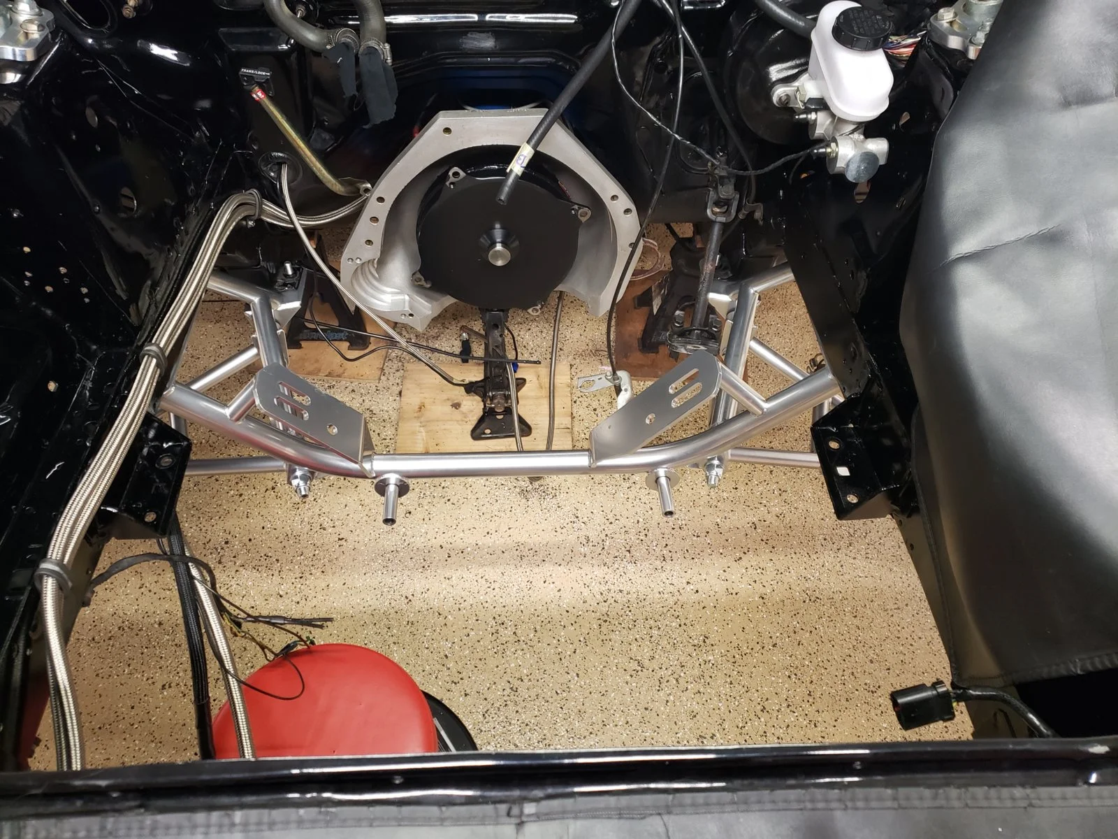

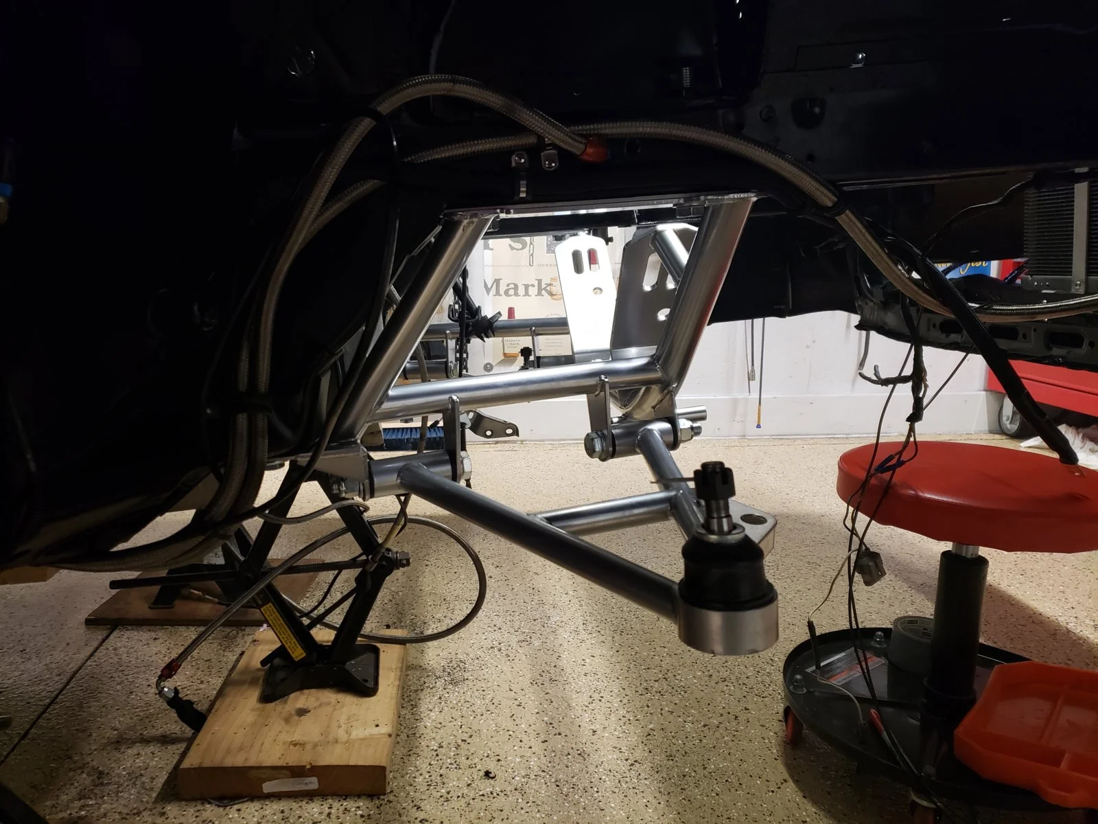

K-member and control arms are installed and squared. I'd heard the "horror" stories from people describing the process they went through to get the k-member squared, so I was prepared for a fight. Hung my plumb bob off the suspension points, made my marks on the floor, and did my measurements. Right off the bat the X measurement was only 1/8" off and the front to back was only a 1/16" off. A couple light taps with a dead blow and all was good.
I did end up making an 1/8" aluminum spacer plate to put between the frame rail and the top of the K-member. When I was mocking everything up there was between an 1/8" and 1/4" gap between the top of the k-member and the frame rail when the lower bolts were fully tightened. I didn't feel comfortable pulling the k-member up that far (it would have to bend at the lower mount) so I made a spacer to make up some of the space on each side.

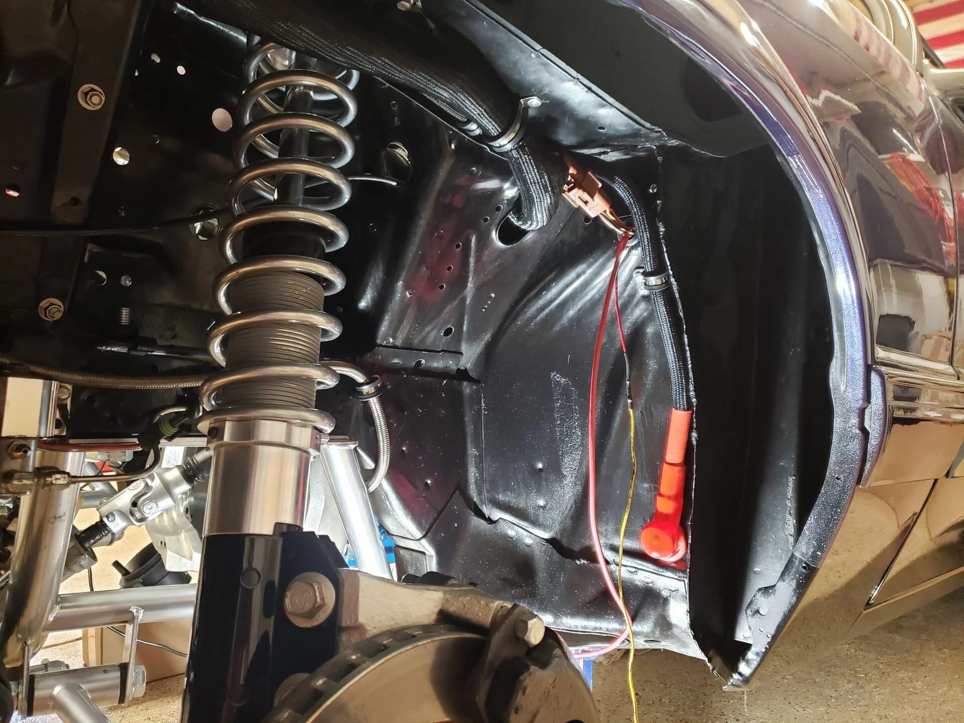

I've been concentrating on cleaning everything up in the engine bay, replacing all the steel screws with that were used to mount the cable/hose clamps with SS, fixing all the various firewall holes that were never properly covered, fixing the wiring and getting ready for the MS3x install, rerouting all the fuel/vent/cooler hoses, repainting mounts/accessories, ect ect.

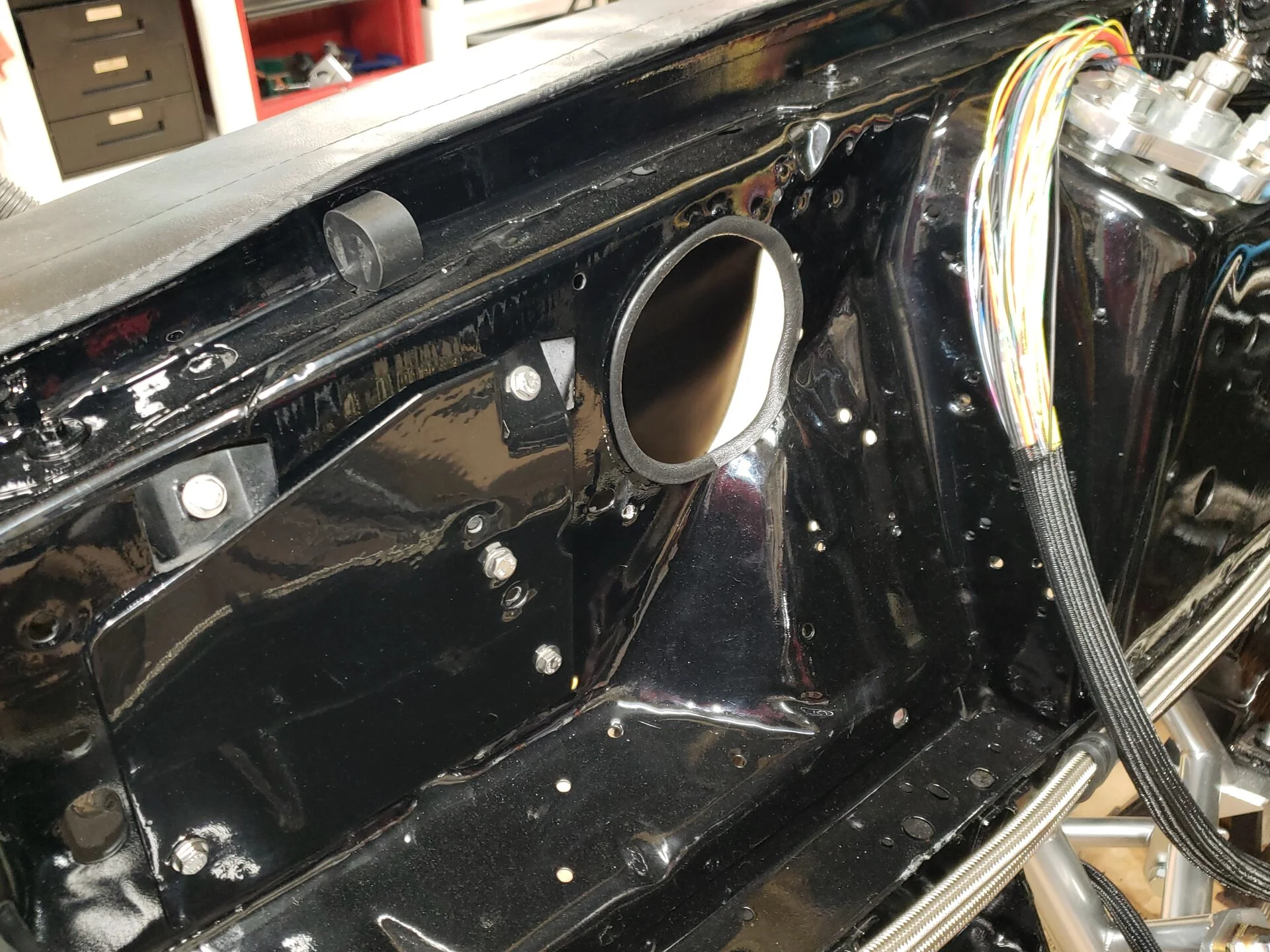

I opened up the hole in the firewall for the powerpipe and installed some trim. I did this will all the holes that were being used for fuel hose, brake lines, ect to provide some protection.

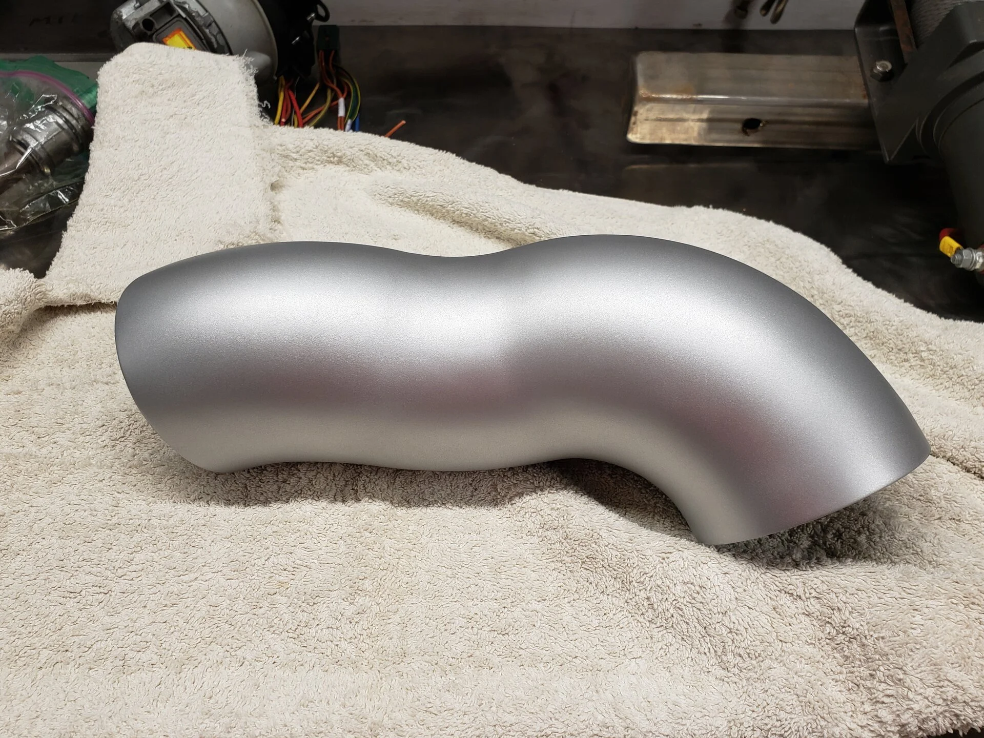

Cleaned up, smoothed out, and re-painted my power pipe. I couldn't stand the half-assed tig welds that were done on this thing. This is the color I've been painting all the accessory brackets, charge pipe, ect

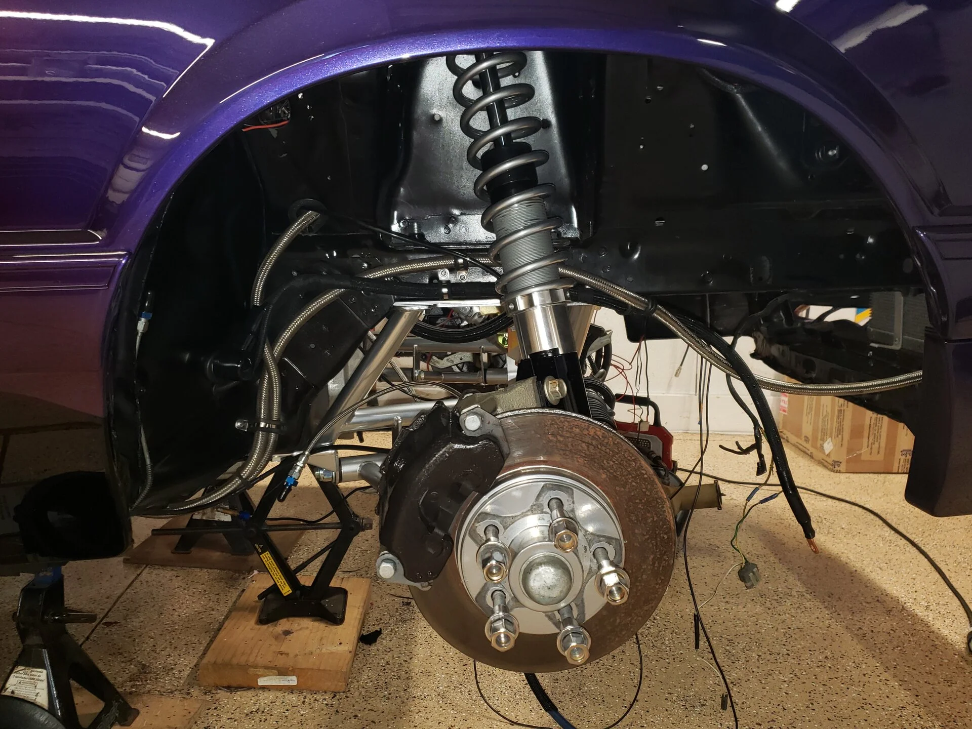

Got my new 10-ways and the rest of the suspension installed. Re-painted the brake calipers and replaced all the hardware. Also replaced all the hose clamps with SS clamps and rerouted to my liking.

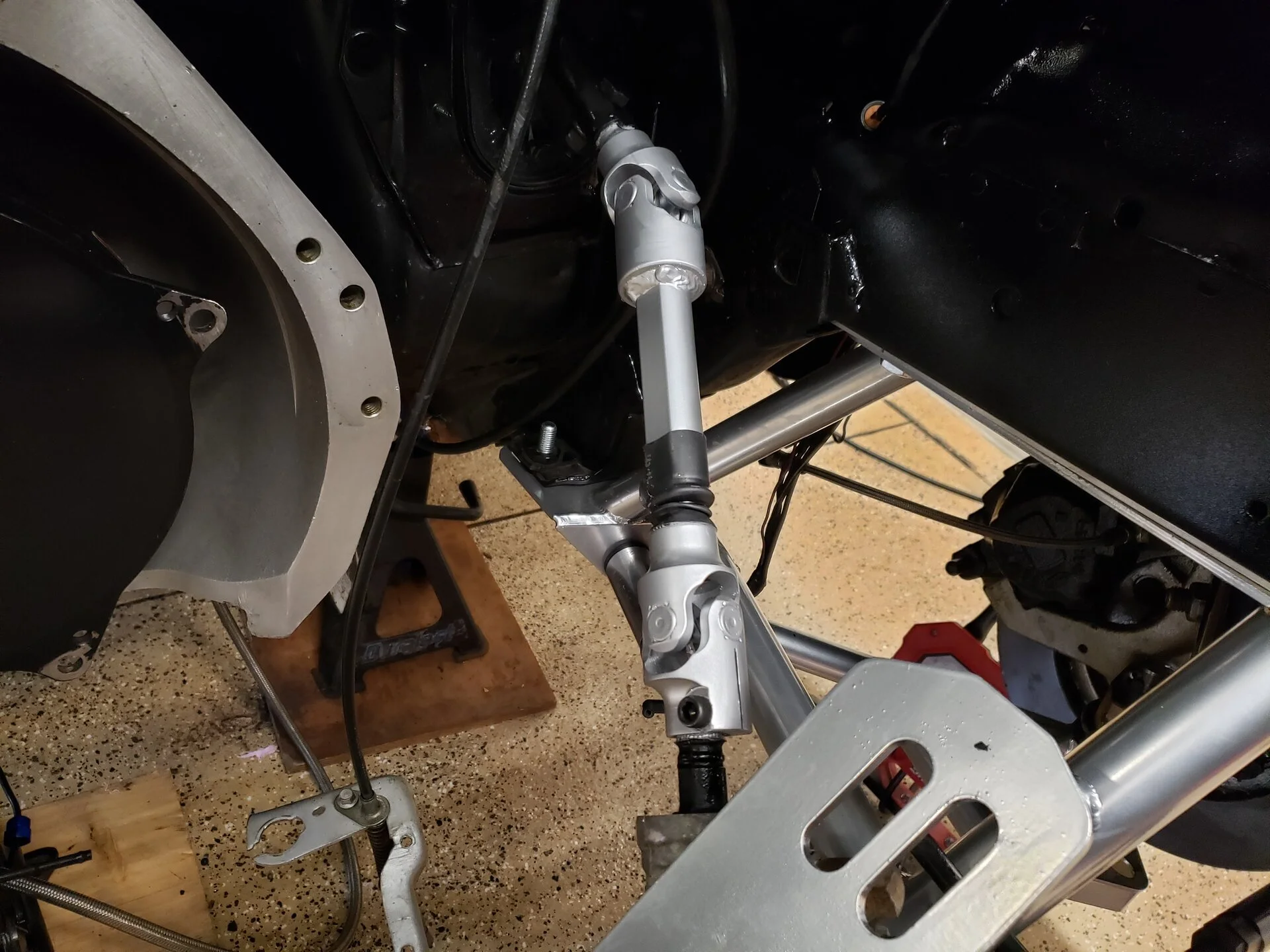

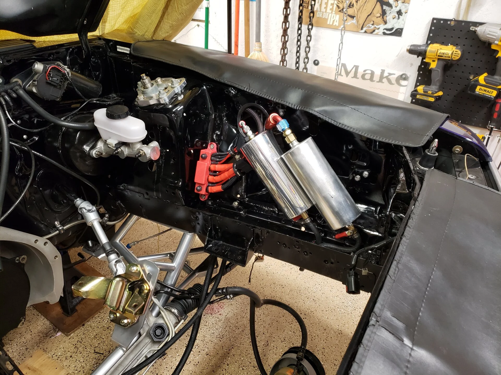

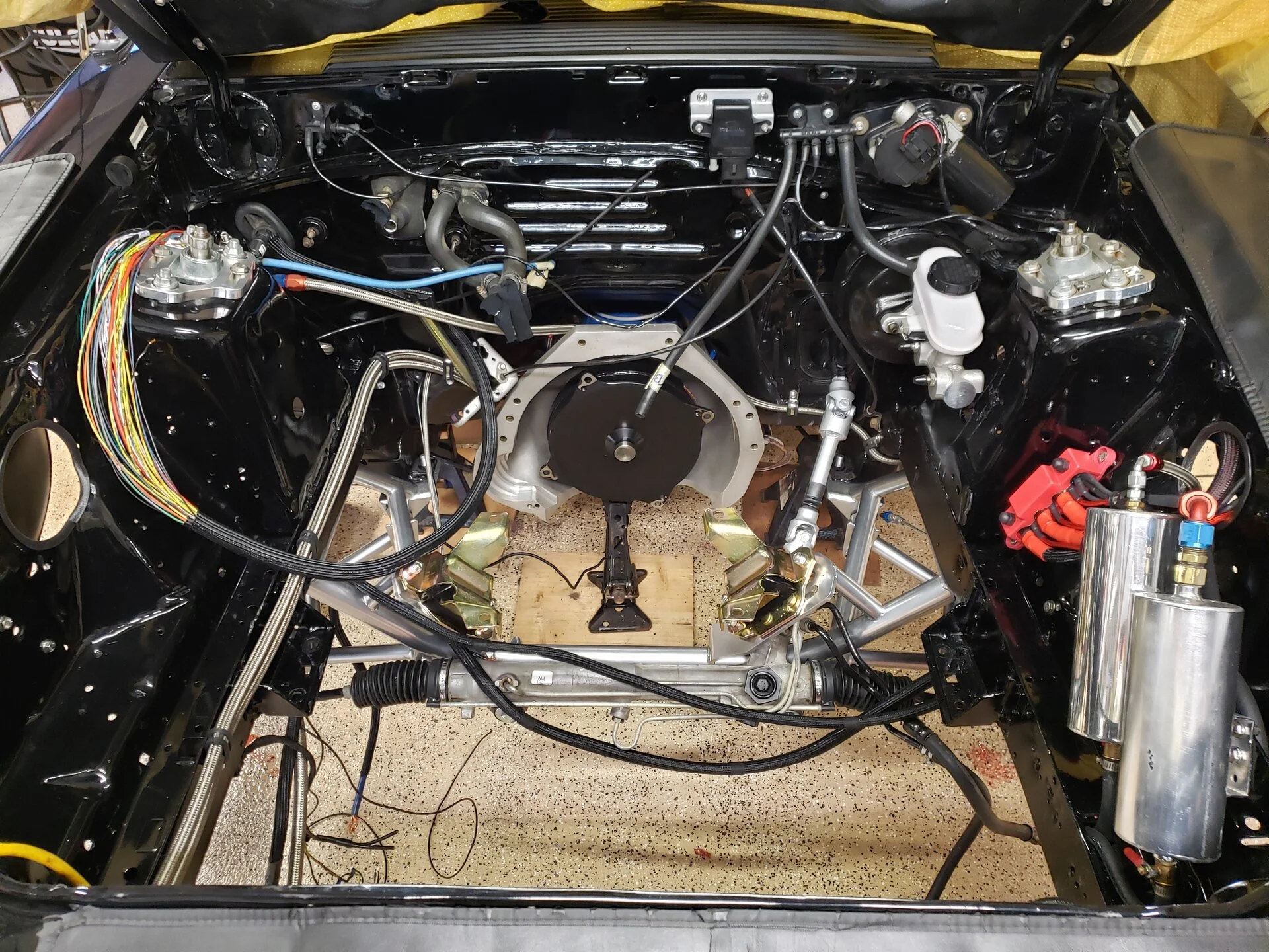

Got the steering rack, my MM bump steer kit, and MM steering shaft painted and installed. I fit the new engine mounts, made a new mount for the catch cans and mounted them, made a cover for the clutch cable hole, rerouted the hose, replaced all hose clamps with SS ones, replaced the throttle cable, ect, ect
Ignore the closest catch can. I've never had aluminum that wouldn't polish, but no matter what compound or technique I used, I could not get that catch can to polish up nice. The other one polished up really easy. I'll replace it down the road but I want to keep things rolling forward.
Also got my main power distribution block and wiring finished.

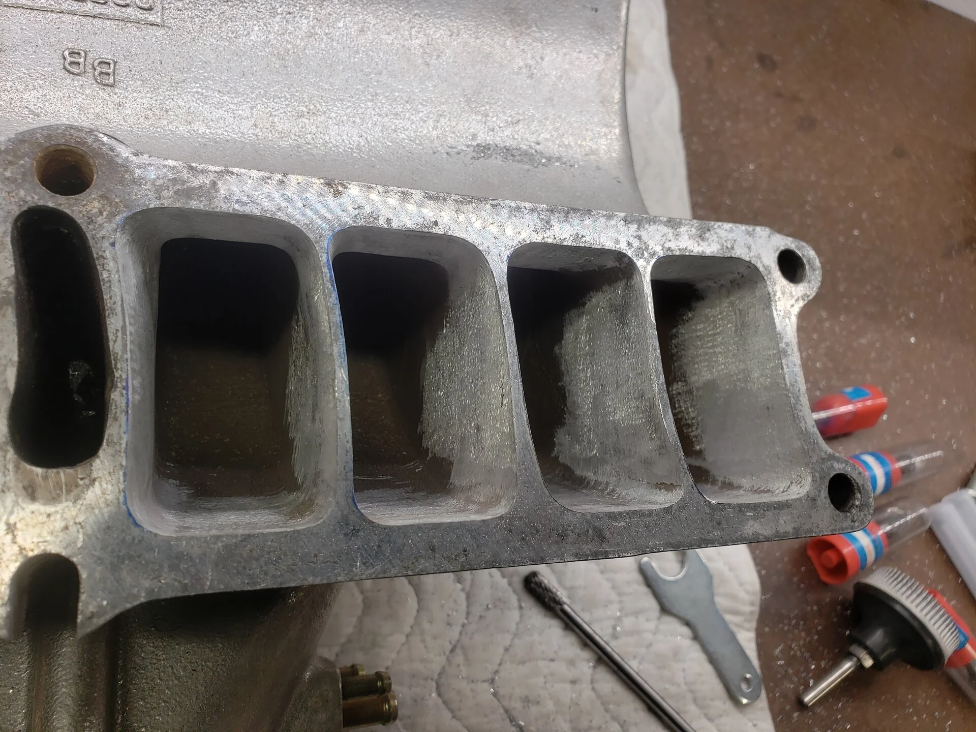

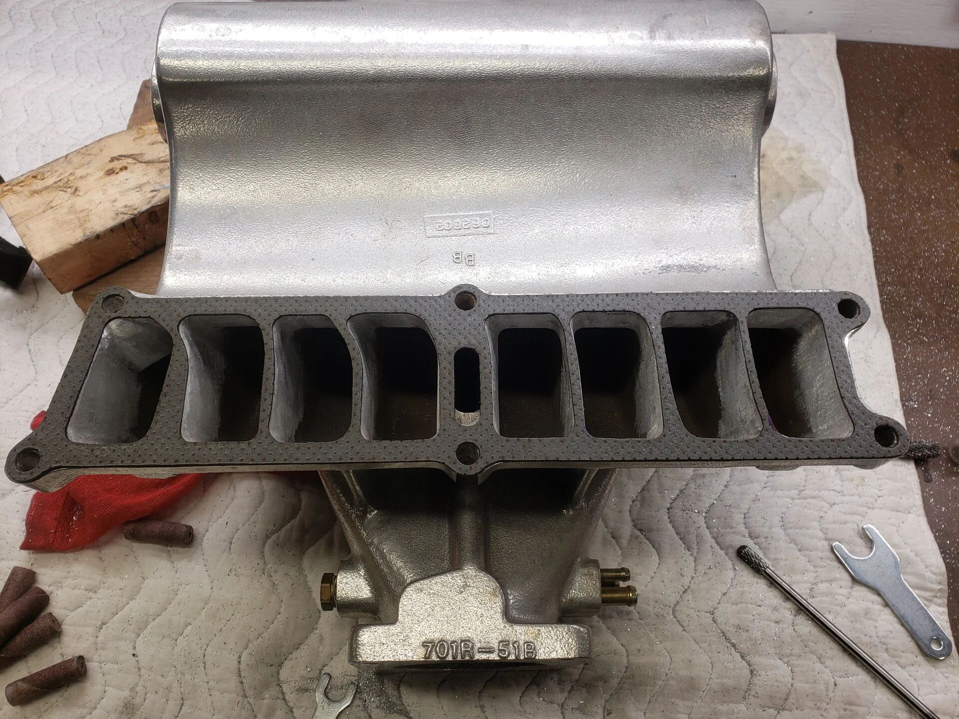

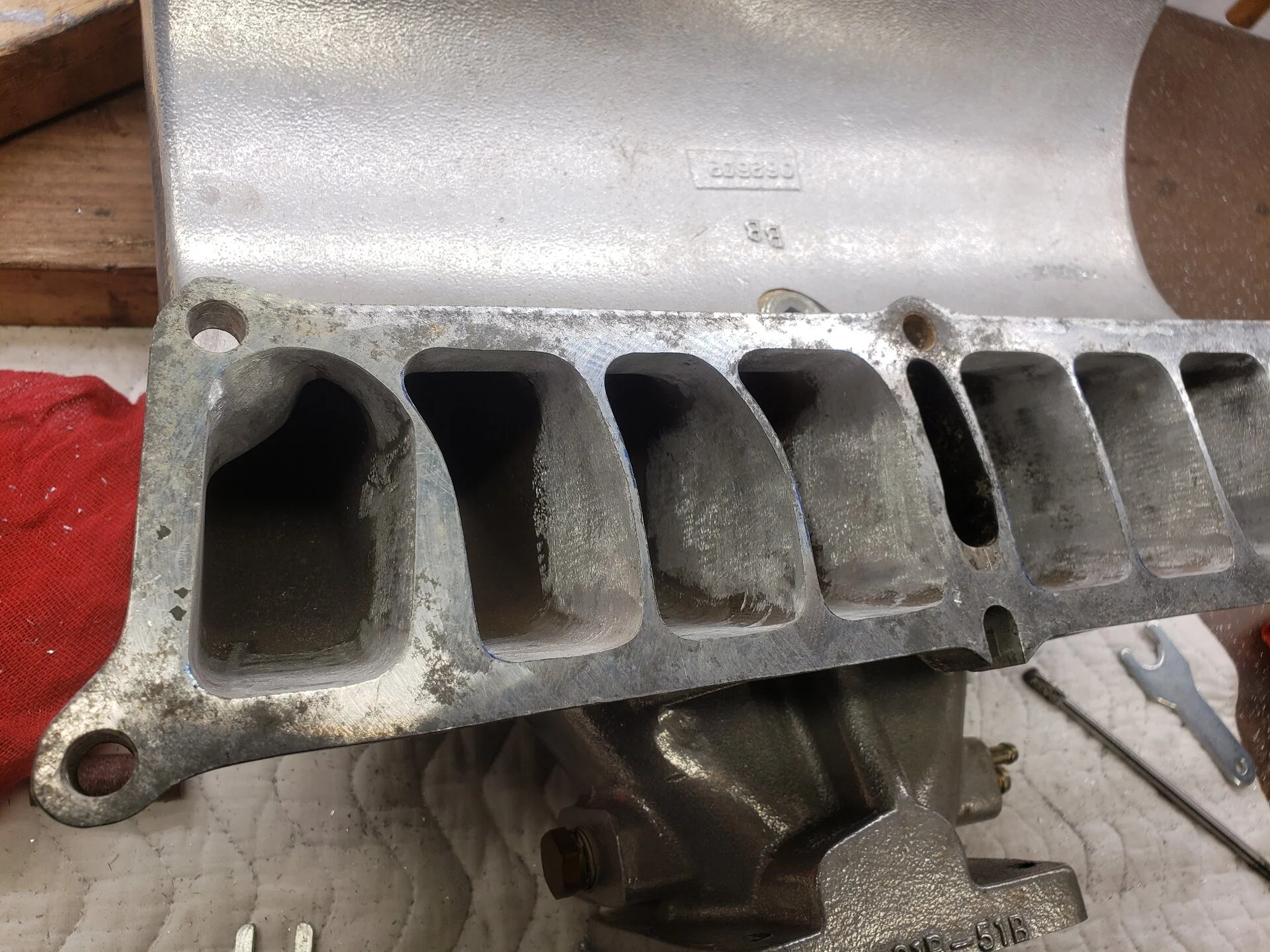

I was still surprised at how much core shift there was between the lower intake and the upper intake on my Systemax II, so I got the porting kit out and did some work on the lower portion of the runners. I didn't touch the upper portion of the runners much since it didn't seem they needed any attention.
I forgot to take a before picture of how the ports aligned with the gasket before I started porting, but like my earlier picture of inside the ports showed, there was quite a bit of shift. I had to take quite a bit of material out. Here is the final result with the gasket on.

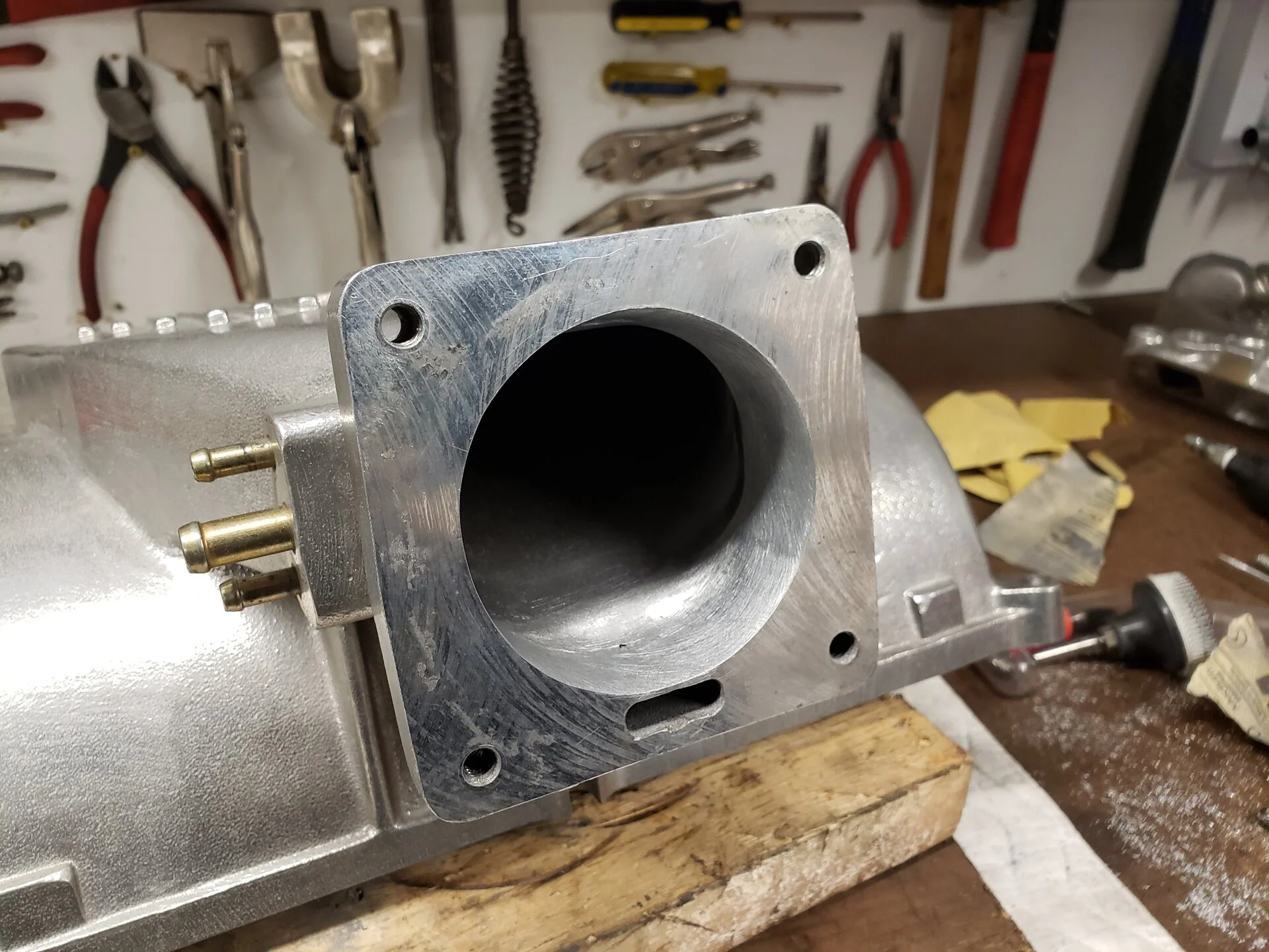

I opened up the TB to 80MM for the new throttle body. And yes, I broke through the floor of the intake throat here. I barely touched this area before I broke through so it was really thin to start with. Shouldn't be a big deal but I'm going to get some Moroso A&B epoxy and fill it in.

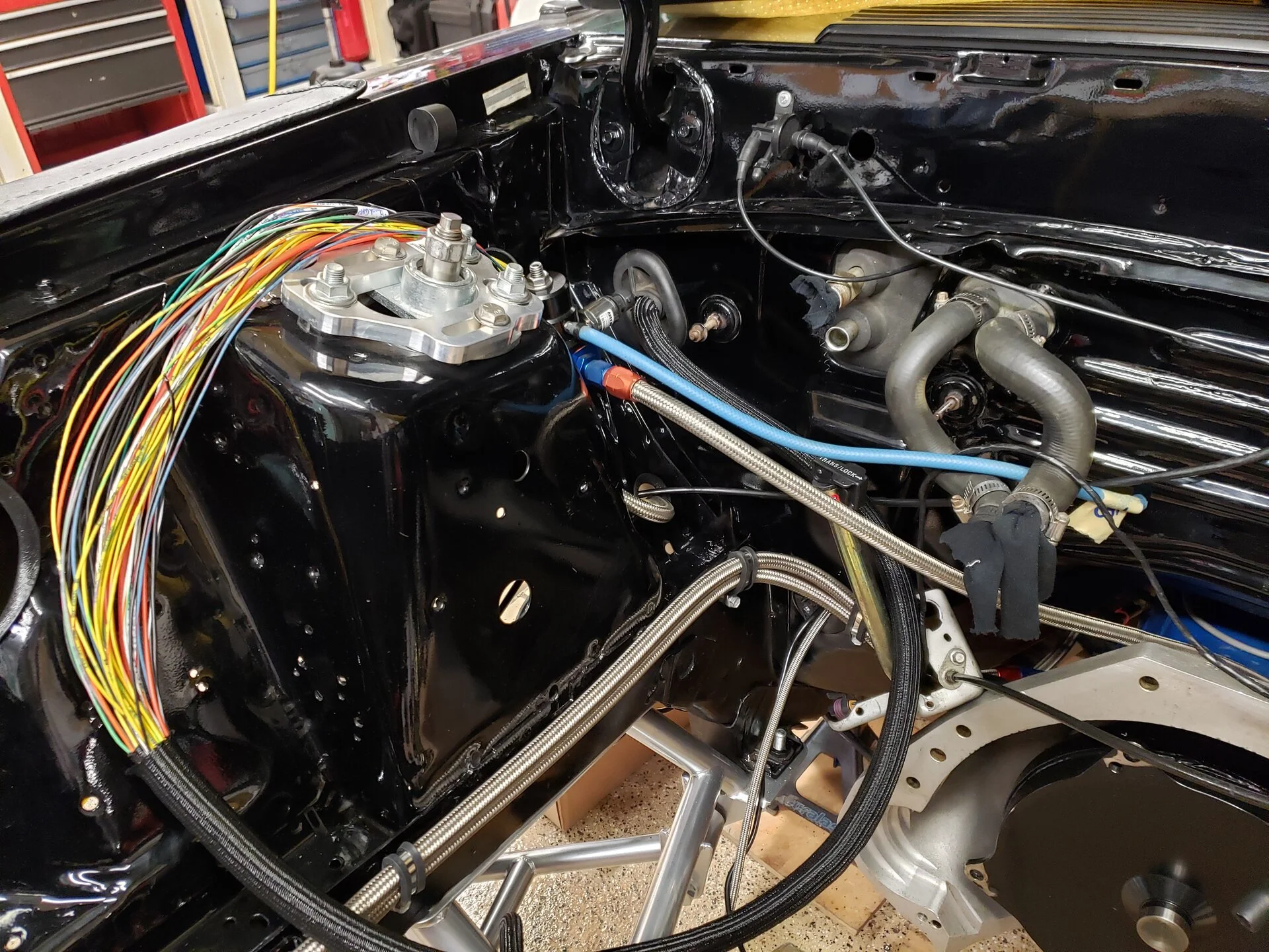

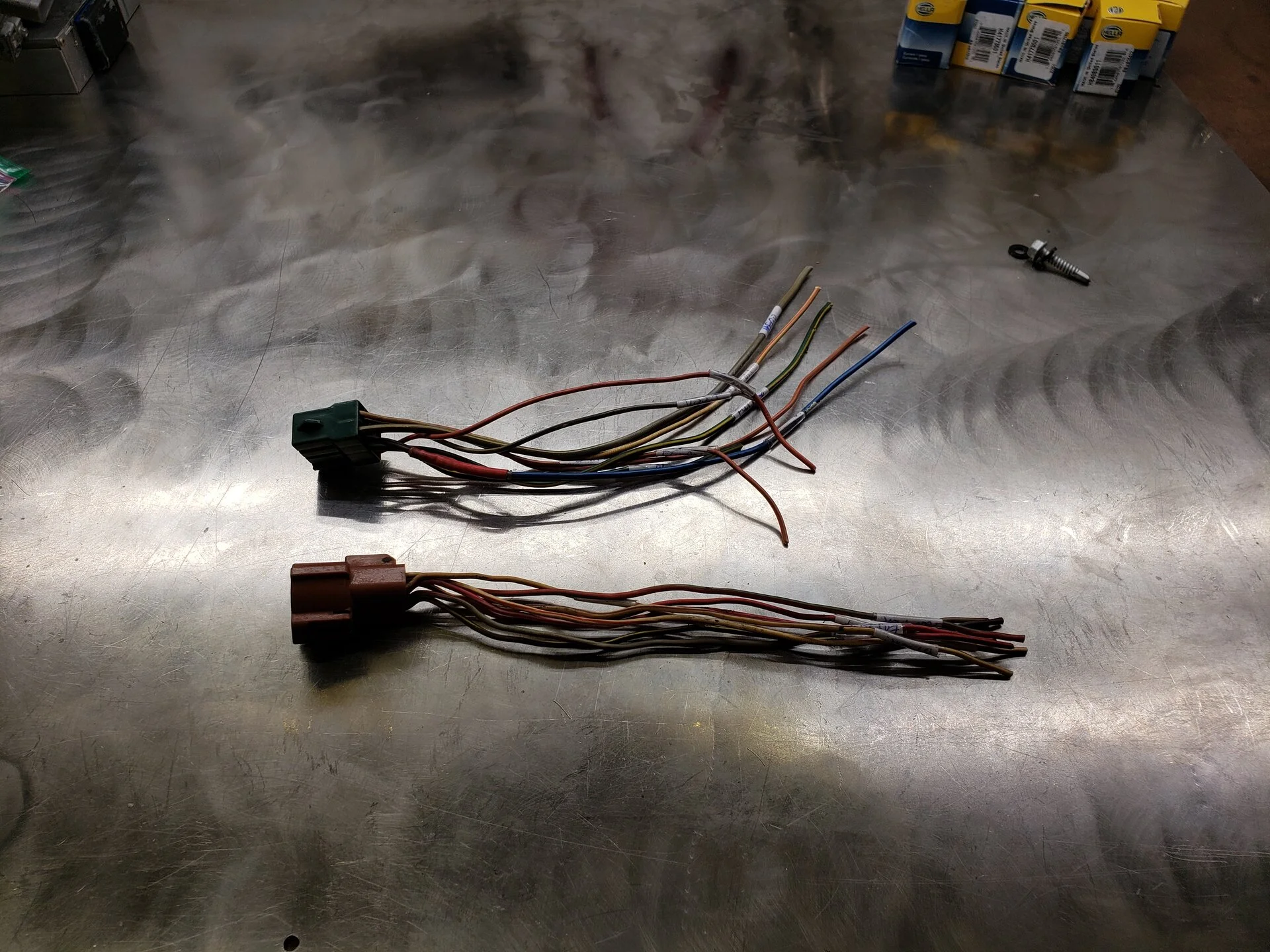

The PO did a really good job of integrating the aftermarket ignition system/ect into the existing ECU harness so you didn't even see the mods, which is great for aesthetics, but really sucked for figuring out what all was modified. Plus, he wrapped EVERY factory harness under the hood and in the wheel wells in electrical tape which was a bear to remove. I got it all taken apart, figured out, and rerouted since I needed to take the factory fuel injection harness and ECU out for the MS3x install.
Since the fuel injection harness was already hacked up, I hacked it up more and reused the factory firewall grommet to route the MS3x wiring into the engine bay.

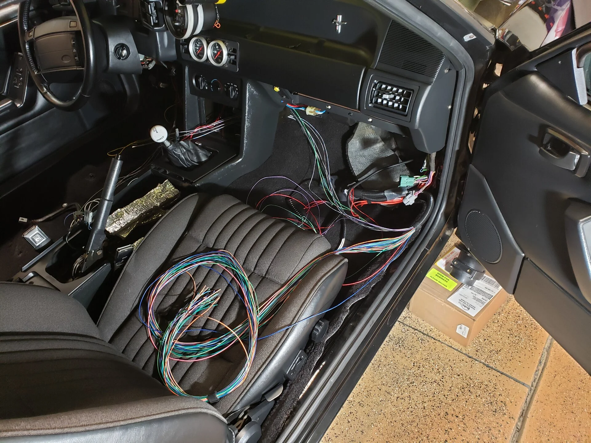

Lots of wiring to do with the new ECU. I'm trying to keep every wire that I don't need to go into the engine bay, out of the engine bay.
I'm integrating with the factory harness to drive the stock tach, get key on power for the ECU, get a VSS signal for the ECU, ect to keep everything as clean as possible.
Trying to keep all the non-engine related wiring hidden or in the wheel wells.
