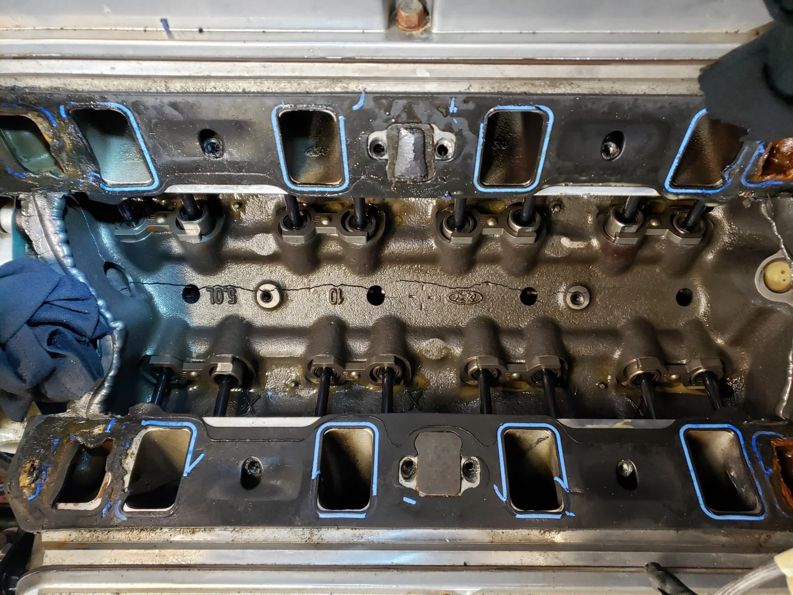

Finally moved the car into the garage and pulled the intake off. The bottom intake came off wayyyyy too easy, and this is what I found:
No question, definitely split the block. Looks like water pump is the only thing holding the front of the block together at this point. I'm curious to see how bad the rest of the block is and what might be able to be salvaged.
Got to dig a little deeper today. Surprisingly, the rotating assembly spins overly freely (and smoothly) and everything I can see without pulling the engine appears to be in good condition. Just hoping I'll be able to get a few bucks for the bottom end parts.
And obviously the question about head studs is moot. This thing already had ARP studs with MLS gaskets.
Maybe those intake gaskets contributed to the demise of the block. Imbalanced or otherwise lean condition can cause excessively high cylinder pressure resulting in.....boom!
Man that intake gasket looks nasty. Those must be the non steel ones.
The other side wasn't any better. Looks like where the coolant passages were, the gasket was getting gummy and was squeezing into the intake runners slightly. Nothing was port matched either, a couple runners had a fair amount of gasket intruding on the port.

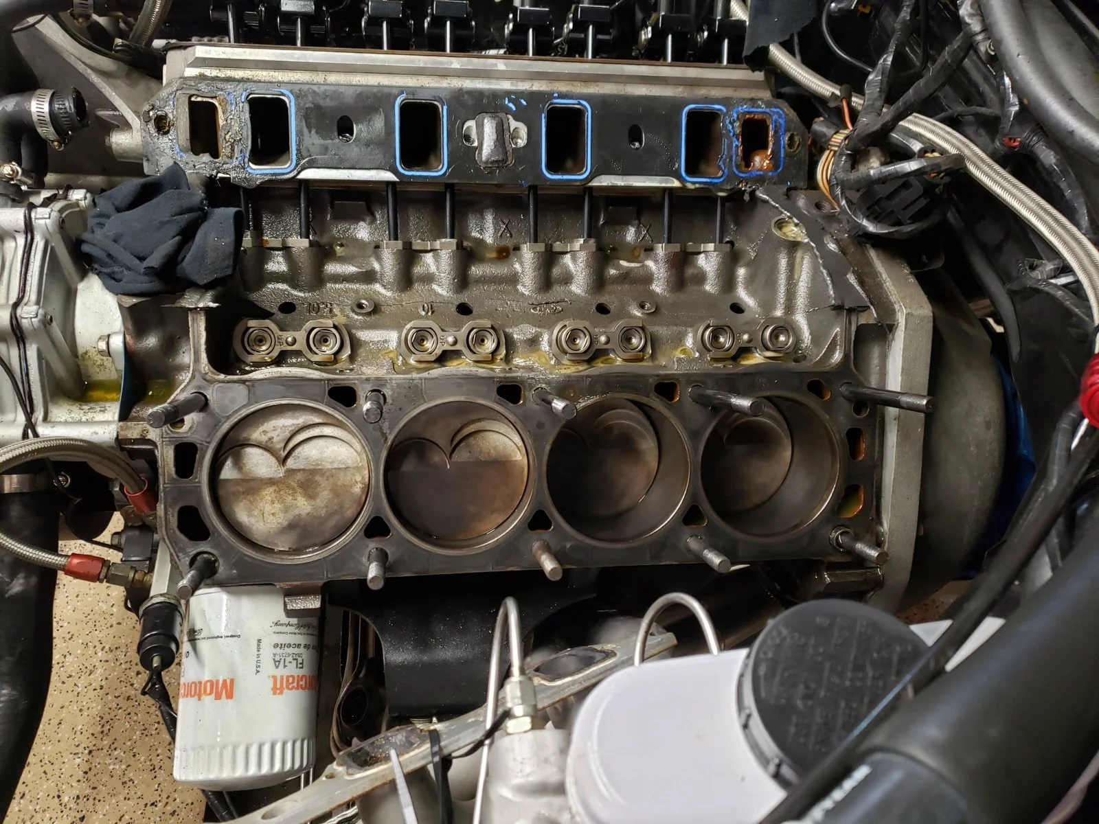

I was hoping to see more evidence of how she was running when I pulled the drivers side cylinder head off. Looks like everything got pretty well steam cleaned when the block split though. I'm going to get the other cylinder head off today and see how the passenger side is.
