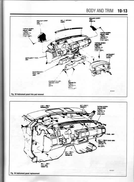

Yanking the dash is easy as pie. It's just a ton of screws. I think you'll need an 8MM nutdrive and also maybe sure you have an angled screwdriver or a low profile screwdriver for the screws on the side of the dash and above the gauge cluster.

I'd just take it out. It's pretty straghtforward. An 8mm nutdriver makes things easy. Center console comes out first, then the glovebox, speaker grills, gauge cluster defrist trim and then you can start removing the 50 screws holding the dash in.

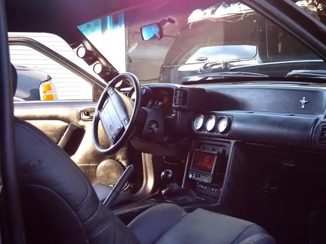

Ooh back from the dead... S&B was a huge help when I did this. The rear quarter trim and kick panels are colored plastic, only certain parts of the dash are painted. I removed all of the grey paint with cotton pads I got from the chick aisle in Wal-Mart and some Graffitti remover. Needless to say, there's black plastic underneath! The finished product (note: my rear quarter trim plastics are now painted, steering column complete, and there's a florida 5.0 gauge cluster in the dash :D):
