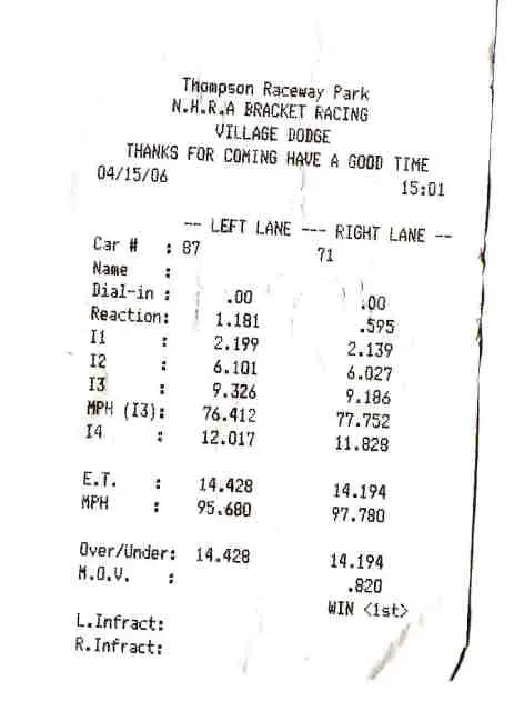

Here's the timeslip - I'm on the right (#71)...
BTW - what does M.O.V. stand for?

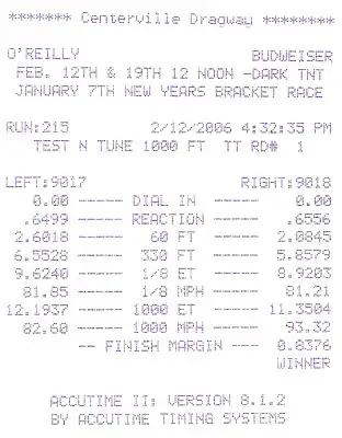

Heres my best slip to date. This was with the following mods:
4.10s
O/R X and SLP Loudmouth IIs
Accufab 75mm TB/Plenum
MGW short throw
K&N w/ passenger side headlight removed (do this, it helps and only takes a minute)
SCT Safe Tune (unkown timing, etc because my tuners a turd and didnt send anything telling me what parameters were set to w/each tune)
245/45/17 Sumitomo HTR+ all-seasons
Removed front sway bar
1 110 lb passenger
Track prep was so-so at best, but the air was cool so that helped. I only spun the tires quickly to clean them up before staging. Launched @ 2500 rpms, feathered the clutch, took it to about 4500-5000 rpms in 1st before nailing 2nd, then let her rip, shifting between 5800-6000 rpms. I'm # 9018 on the right. Heres a vid of that run: http://media.putfile.com/113504
Im gonna go through some older slips and find some with similar times as yours and do a little comparison. Im probably just gonna tell you to keep practicing, because I ran terrible times my first few times at the track with most of these mods, 4.10s included.

I think an MGW, Tri-Ax or Pro 5.0 shifter would serve you well. I was looking at some old slips of mine andcomared the to the one you postd. You were quicker through the first 330' by .15, and by the 1/8th we would be even, and by 1000' Im .2 ahead of you.
Now, not knowing exact power output of each car doesnt help, but looking at that trend makes me think quicker shifts has something to do with it considering our mods are similar.
I'd make an MGW your next mod and just keep practicing :nice:
MOV (Margin of Victory) is the actual amount you beat him by, you combine the difference in your reaction time and your quarter mile times. So basically you beat him by .8XX seconds. You really kicked the crap out of him :rlaugh:.
