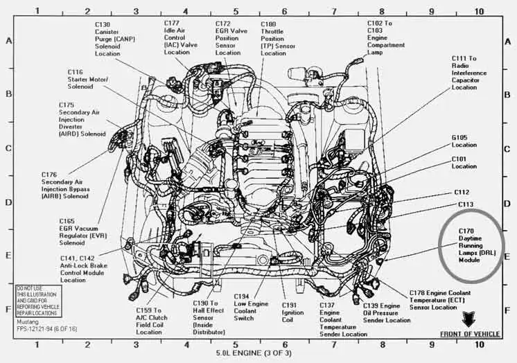

Hey gang, I'm a moron and don't know where the daytime running module is in my '94 so i can unplug it :(
i've looked, and it's in a different spot than my '92

It only came on canadian cars. Sorry I don't have a clue where it is but there is a relay for it under the hood I believe. If you look in your owners manual it should show a drl relay. Just unplug the relay and that should do it.
Here's a pic of it's location. The connector has 8 terminals.
