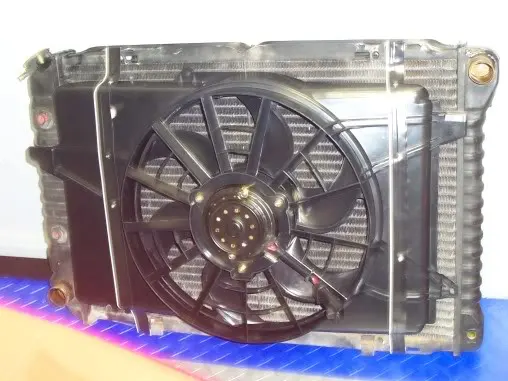

For mine I used aluminum straps attached to the shroud and hung on the radiatior and retained on the rad both sides top and bottom.

Brilliantly simple! Is that the stock radiator?

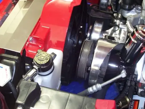

yup..old rad was for test fit, perfect time to spend 100 bucks on a new 2 core from the autoparts store if your's has some time on it. Then reworked the stock shroud to accomodate the Efan and the overflow bottle, total time to install fan...1/2 hour, total time to install DCC controller...1 slow paced easy hour (90 degrees in there keeps ya slow movin)

Is that your engine bay??? Its ummm clean. I like how part of the fan is painted to match.
VERY NICE!
