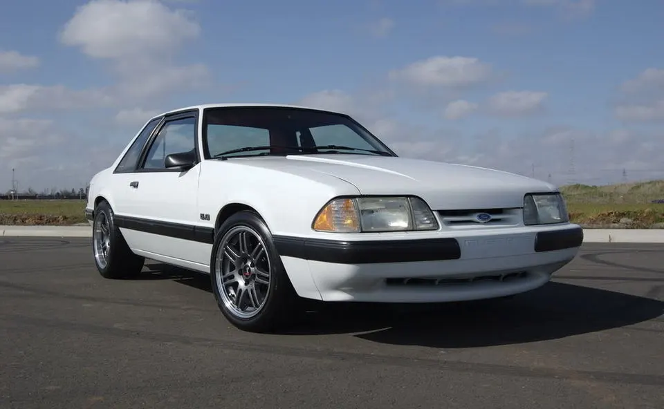

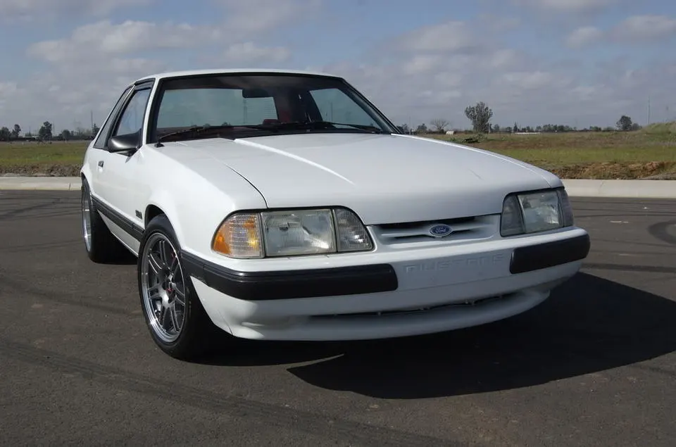

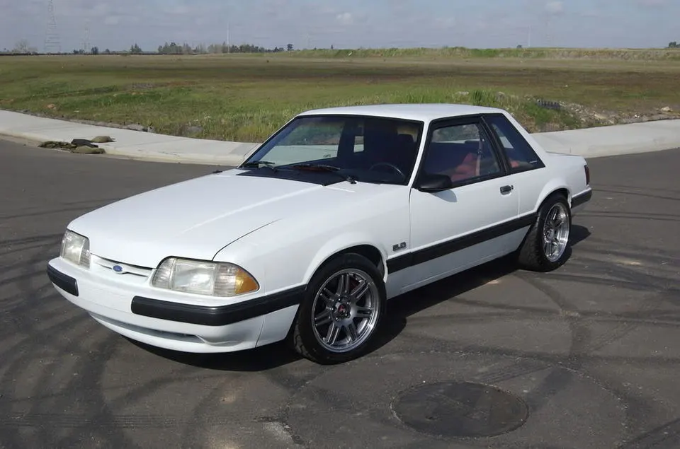

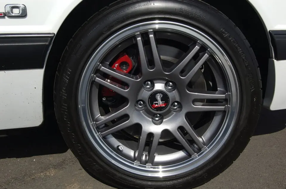

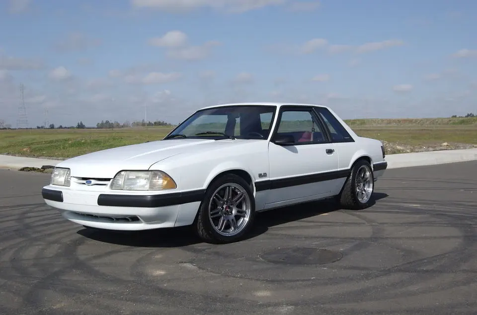

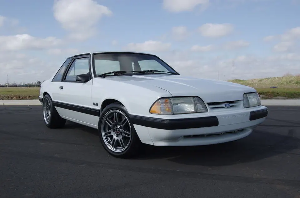

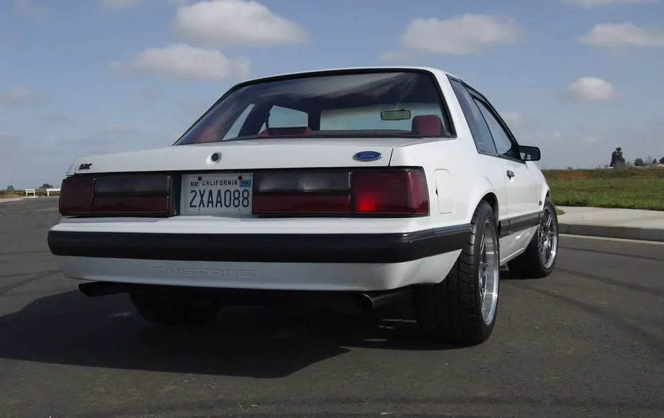

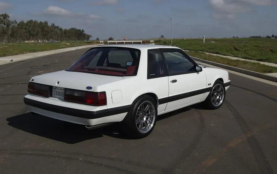

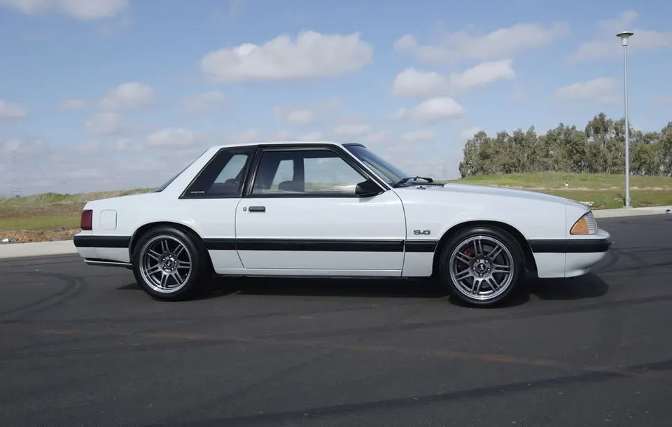

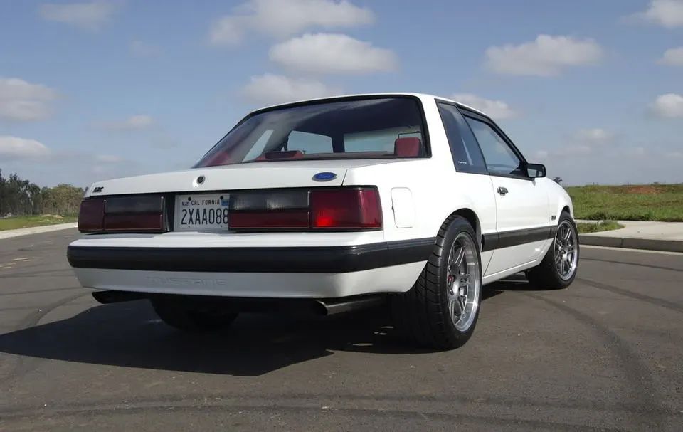

FINALLY got the deep dish 10th anniversary replicas mounted up on the Notch last night...
It was a long time coming, but well worth it. As u can see, I also did a 5 lug swap, Cobra brakes, Bilstein's, & 3.73's @ the same time...

blueink said:
damn that bish is bad!! post tire wheel specs asap! im too lazy to go look for them on the other thread!

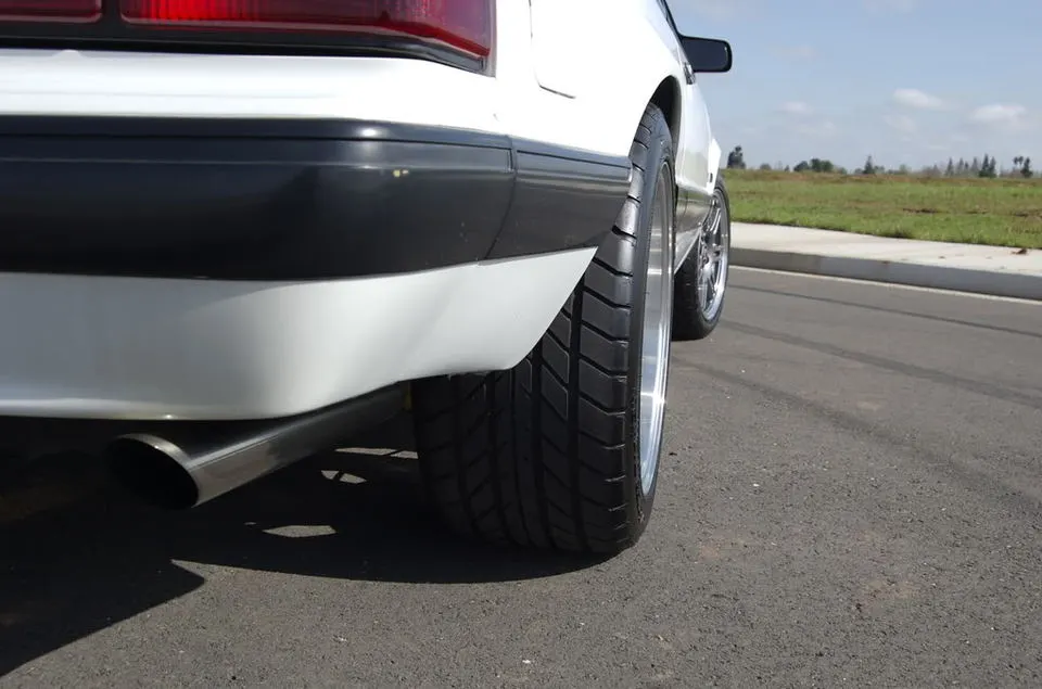

The wheels are 17X9 (20mm offset) & 17X10 (24mm offset), & the tires are 255/40/17 BFG KDW2s' up front, & 275/40/17 BFG KDW's out back...

Thank u... It feels completely different. The ride quality is waaaaaaay better, but the gears, OMFG!!! They are great!!!

Thanks... It's completely different than before, I don't have to give the car as much gas to get around in traffic, but I have to feed the car much more gas because I can't keep my right from hitting the floor

Thank u, & yes I do have iso's in front. I realized that I need to remove them though now because the front sits too high. When my car was bone stock with the AOD, A/C, & smog pump, the front sat perfect. But after the aluminum heads, 5 speed, smog & a/c delete, the front end came up about a 1/2". The old wheels had a taller tire in front, so the gap looked smaller than with these current wheels... I want it about 1/4"-1/2" lower in the front...
