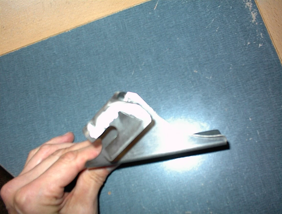

Ordered a CDC Dead Pedal last weekend ... it arrived today and I installed it.
Note that 2011 is again slightly different from the CDC pics of 2007-10. Obvious difference is the absense of the Fuel Pump reset switch, so the wiring is routed slightly different. However, the carpet now goes all the way to the side sheet metal and has formed bumps molded into it that the base of the kick panel sits against. In order to "form and tuck carpet around the factory dead pedal platform" as stated in the instructions I had to make a slit in the carpet just in front of the dead pedal bracket.
Also, the wiring harness is not very well wrapped as it passes the dead pedal so you will want to add some protection here (short pc. of wire loom or wrap with heavy friction type electrical tape). Also the back edges of the pedal bracket were somewhat sharp so some sanding and wire-wheeling these edges where it comes in contact the wiring harness is mandatory as well.
I also planed on getting a set of Lloyd Carpeted Floor Mats with the tab of carpet that covers the dead pedal platform. However top of Dead Pedal is tilted as far back as it can go, but needs to tilt back a bit further to be more parallel with the carpet platform so the mat can sneek between the pedal & carpet. Looking at it a bit closer, it would take some serious modding to get pedal to tilt back more so maybe I'll have to resort to shaving the styrofoam platform under the carpet a bit instead.
Doug
Took a sawzall to the back corner of my dead pedal's mounting flange to see if this would allow it to tilt back enough to get the carpeted floor mat under it. Modification was a success as I was able to tilt pedal back so it is now is parallel with the carpet and not touching it at the bottom edge.
Will have my Lloyds floor mats next week so I'll let you all know if it slips under the dead pedal or not.
