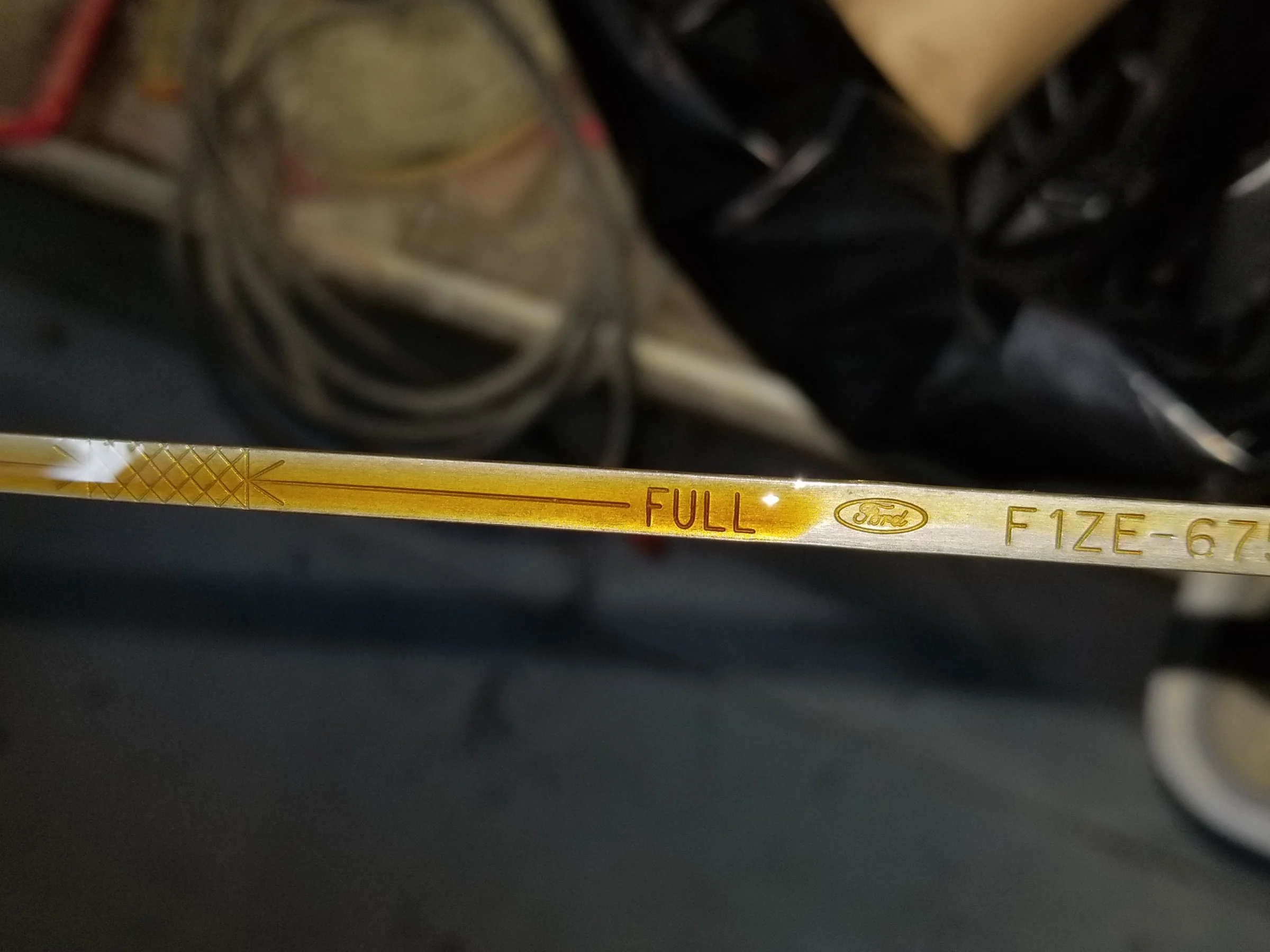

My dipstick is reading higher than normal after a Ford dealership oil change.
Now with so many screwy new cars out there, and their bizarre foreign requirements, dealerships can actually MISS stuff like the TWO BUNG HOLES in my 1992 LX 5.0 oil pan that is separated by a tie rod (which I caught for them this time)... and which would have left a large part of one dirty quart still in the engine...
... as well as them putting in 5W30 instead of my usual 10w30...
... and thus giving me the fits with the low oil pressure reading at warm idle...
But on page one of the receipt, they state that 5 quarts was used, and yet, in comments on the second page, he's typed in 6 quarts were used...
Will that mess up the car? The oil stick is not as it usually is...
The oil stick, far from reading up to the usual FULL fill line of the ADD cross hatched area, it now reads fully up to the F, way up the stick, and even trails a snot trail of oil beyond that... after sitting for several long hours.

The Service Manual states that the Dipstick can read as high as the "F" and be considered normal. I hate letting anyone else mess with my vehicles as you never know what the heck they are doing.
I read that, as well, but in my experience of doing it myself, I seem to recall that it never went higher than the full side of the cross hatched grill... with 5 and a new filter... If I recall correctly...

What's wrong with 5w-30? Most people don't even know what the first number even means. If you don't live/drive in freezing temps then it matters NOT. As far as 6 qts goes, if you're so concerned then drain it and put 5 qts back in. Most Ford 5.0 dipsticks don't read accurately anyway. I put 4 qts in and scratched a line on the dip, then added the fifth quart and scratched that line too. Now my dipstick will read correctly with 5 qts.

Many Foxbody dipsticks were wrong from the factory. On both my 92 and 93 the full mark on the stick was in the wrong place. After an oil change with 5qts I remarked the sticks about 1/2 inch higher up from the factory full mark. So they may have used only 5 qts but your stick has been wrong all along.
Reactions: BiminiBlue92LX5Ohhh
You have the same dip stick as I do, same part number and looks like mine also, I did the mark 5 quarts on the stick thing and mine is about 3/8" above the hash nark, yours is WAY past that, again I say take that back to the dealer, it's your car and your money. Go back and demand they put in what you want, like others have said, you could leave it alone and be ok too.
Just my opinion.
Learn how to change the oil and filter yourself with 5 quarts of the lube of your choice and mark the dipstick like the others have said. Then repeat the process every 3,000 miles.
