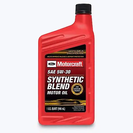

The gauge is not accurate.
10W-30 is getting harder to find.
5W is fine; My Toyota takes 0W
I've switched to 5W-30 Motorcraft Synthetic Blend.

Thanks! And I just read that MOBIL 1 says 5w-30 for my 1992 LX 5.0 with 79,000 CAN be used on their website, as RECOMMENDED!! So maybe the needle dip is not any big deal!!
Also it never went completely out of the normal range...
So you like the MOTORCRAFT better?!
