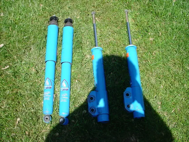

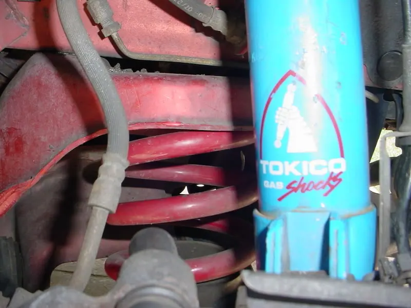

i run hp blues with sportline springs rides nice and stiff... a little bit 2 low i bottom out a little... its stiff enough that i dont scrape my 315's in the back im content with the handling and stance... i picked up mine almost new for $150 for the whole set. im running the fox's up front...

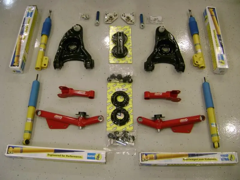

I am installing these right now on #58 and keeping the stock Saleen springs. This is one time you really get what you pay for. After it's all said and done for me it's worth a few extra hundred for a great ride....and they have a Lifetime Warranty. I could have gone for the stiffer MM version Bilsten but I wanted the best ride quality possible AND Performance so I went with the HD's.
I'm also installing 03/04 Cobra front arms, J&M arms with 3 piece bushings, Steeda CC plates, MM bumpsteer kit.
