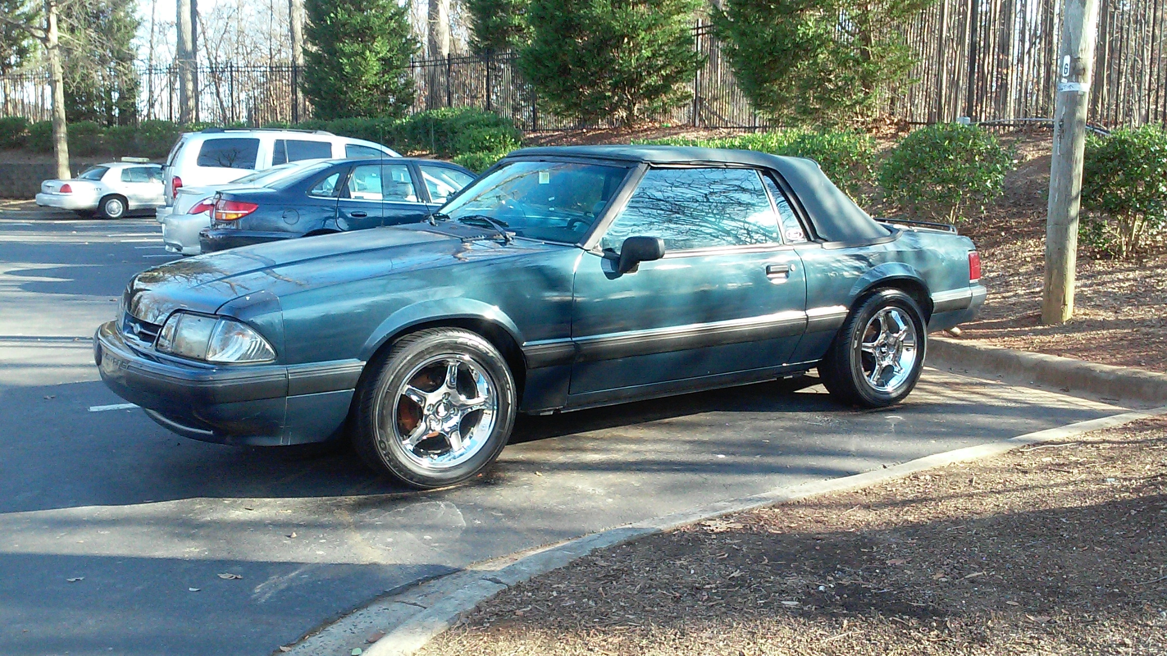

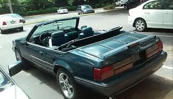

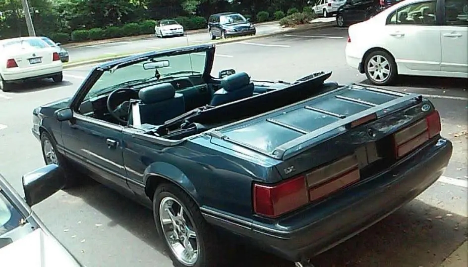

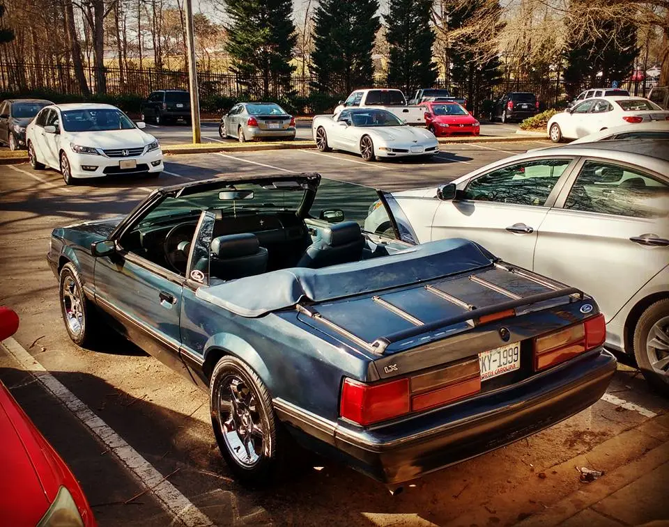

Hey guys I currently have a 89' lx convertible 4 cyl 5 speed car that I am looking to do a v8 conversion on during the upcoming summer. Im doing this on a very tight budget as I am a college student so I am looking to get opinions on the best setup to go with. Not looking for a racecar setup but just something reliable and fun to cruise around with.
