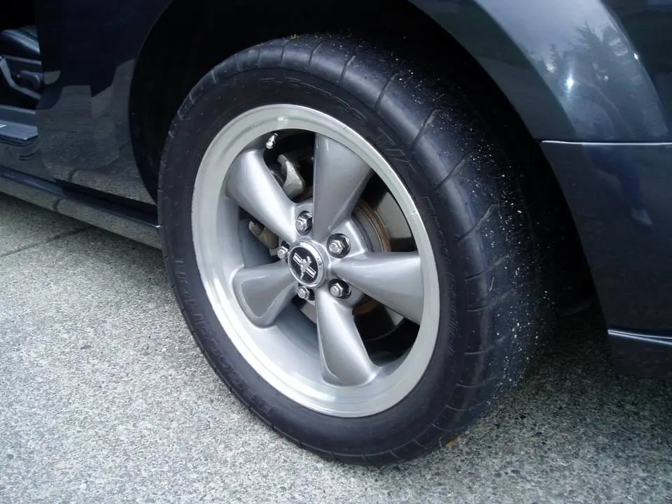

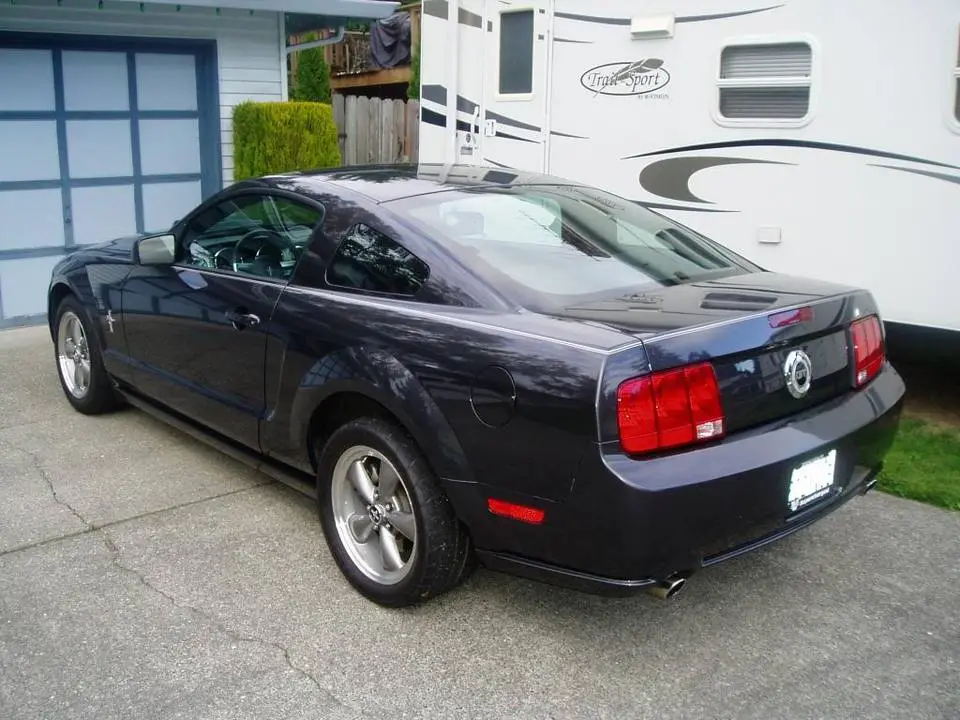

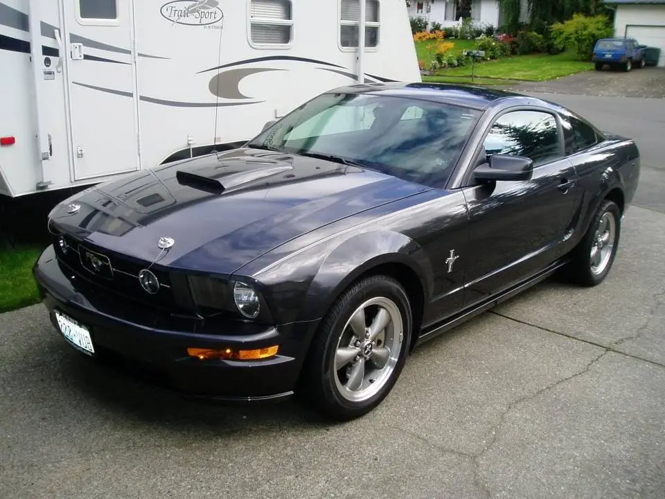

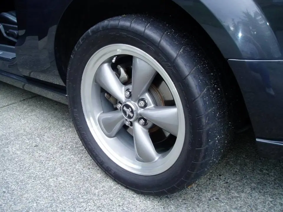

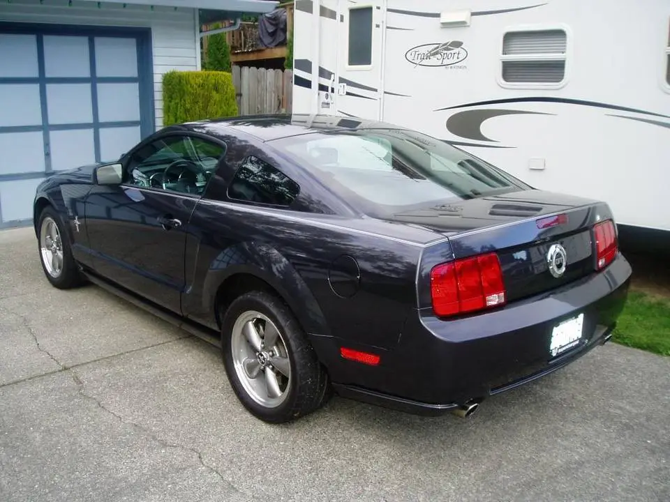

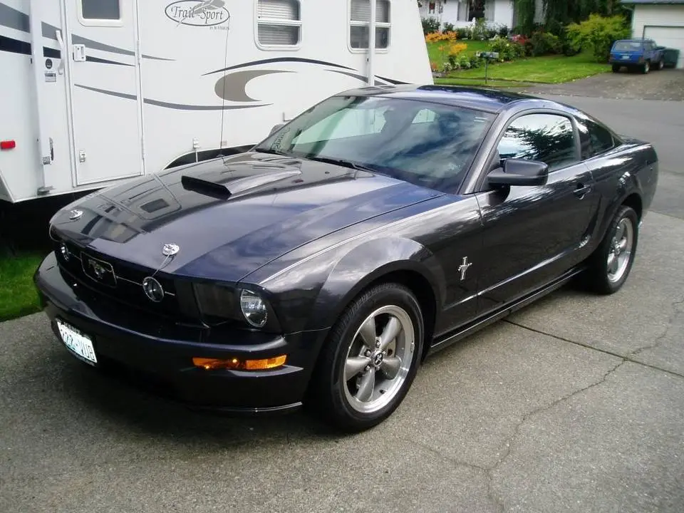

I'm cheap. So, I bought a set of four 17x8 Charcoal Bullitts from an 06 Mustang with factory Pirelli's for $250. Replaced that rear rubber with 275/40/17 BFG Drag Radials. I use this set of wheels/tires for drag days, and use my factory 18" fanblades for street use. The 17's work great and traction is spot on with 18 psi in the drag radials even with a supercharger lurking below the hood....
