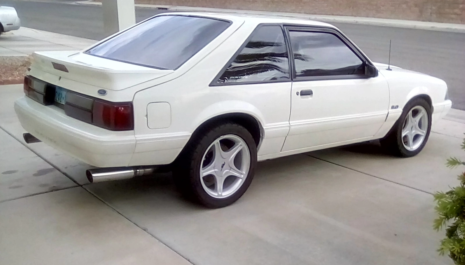

I know the limits are higher for my 93 but I got it with two cats removed(12 years ago) and passed
sniffer test in Nevada every year,even after putting 109,000 more miles on her.
Reactions: DeepFriedAsparagus
