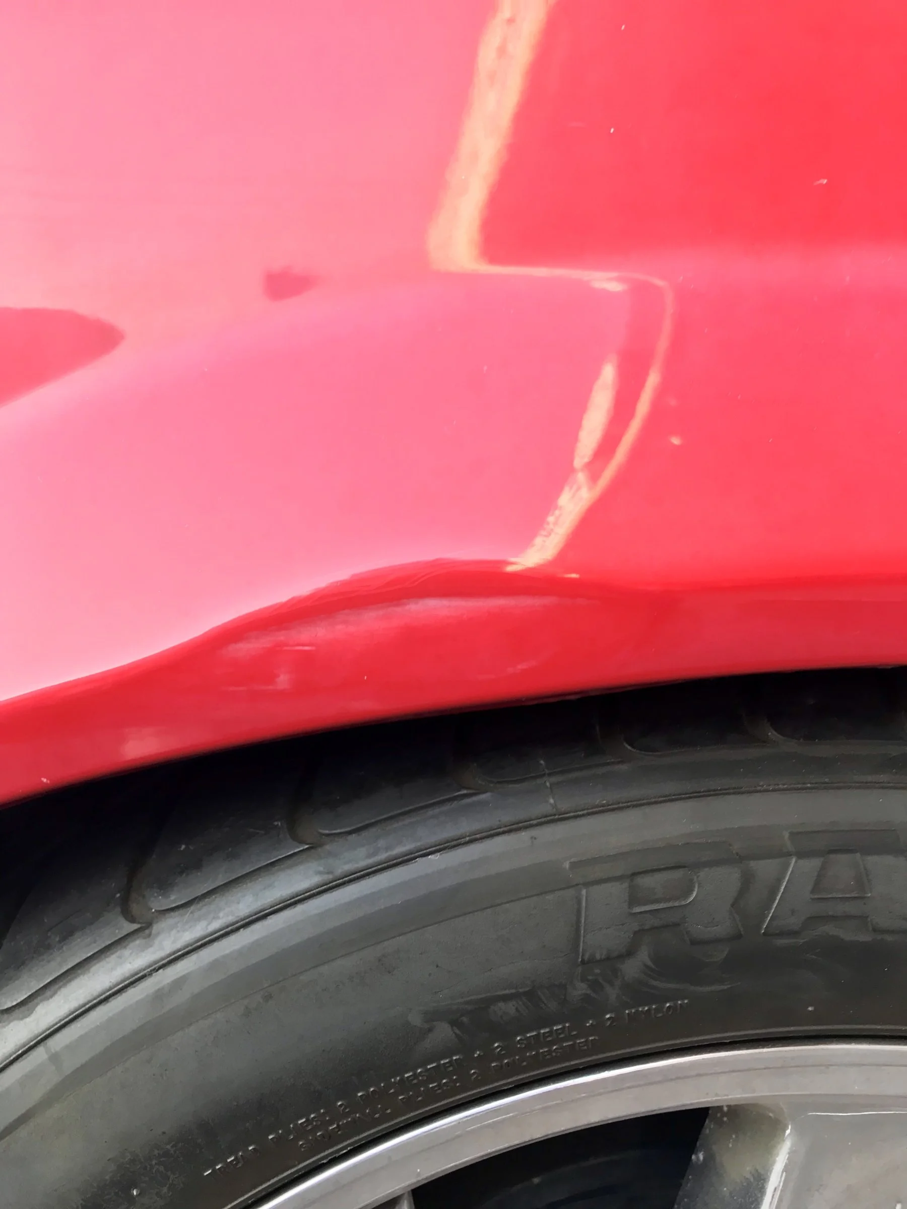

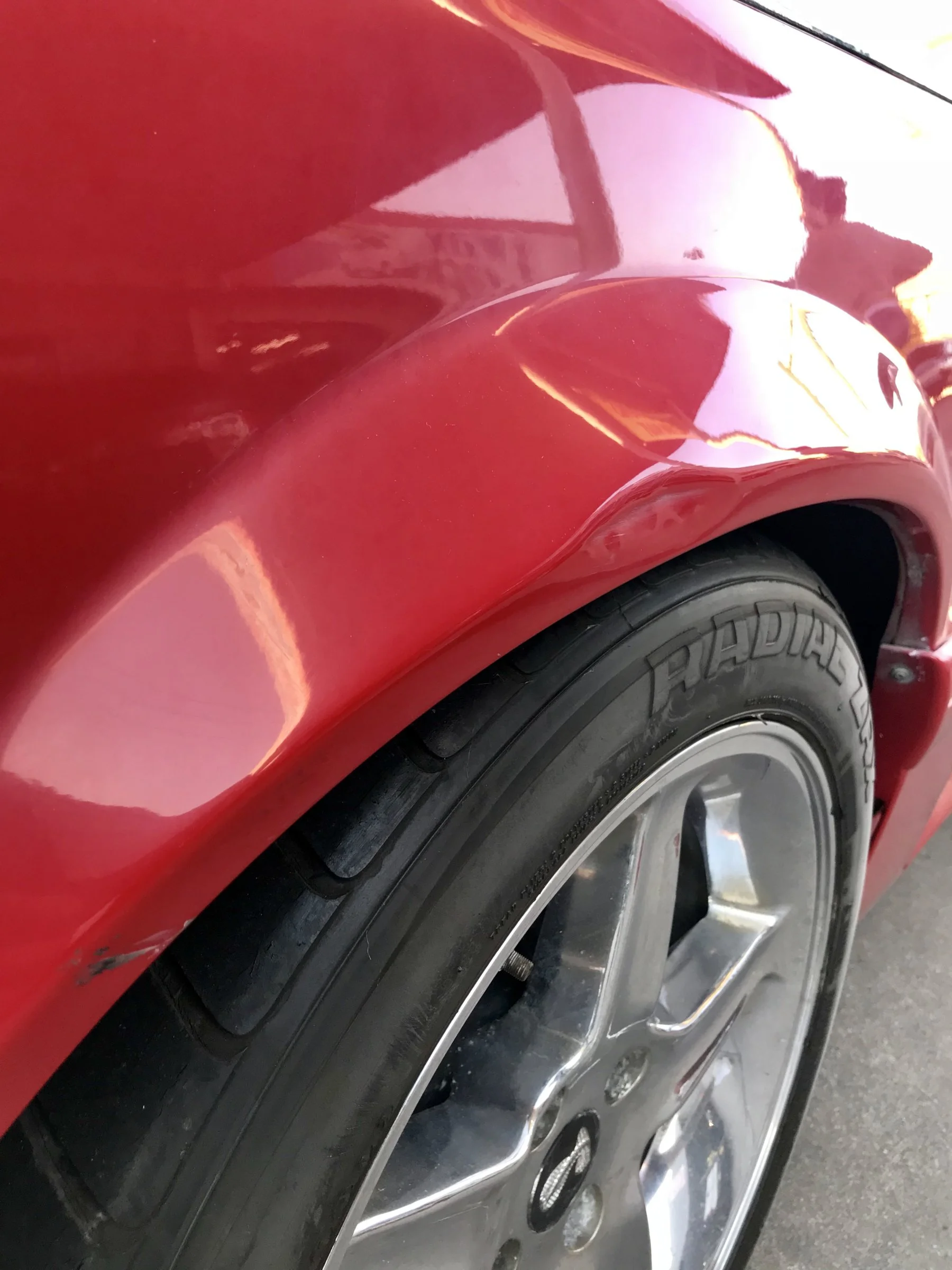

Ok so one more on the boards, so back in the day someone bumped me on my back fender, for those who are more body mechanic or painters etc can this be saved or how would one go about fixing this little nuisance that in such a bad spot!!!
Unfortunately that will have to be worked out by a bodyman, primed and refinished at a body shop. LT Tail lamp and bumper, and moldings will have to be removed for proper refinish. That dent is just in a bad spot. Bummer man. 20 year body shop vet here.
It sucks bc of where it happened on the lip crease. Just haven’t been sure but figured it wouldn’t just be an easy hammer out. Planning on getting some fresh paint on the car at some point so guess I’ll just have to get it worked out at that time and good call on rolling the fenders. Thanks for that input
