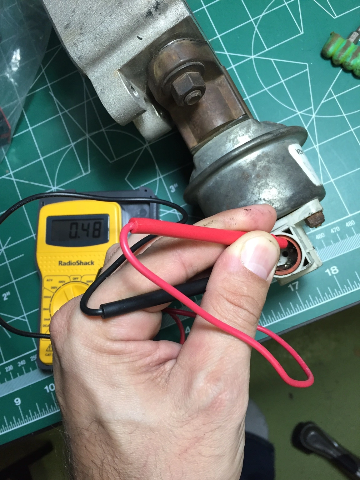

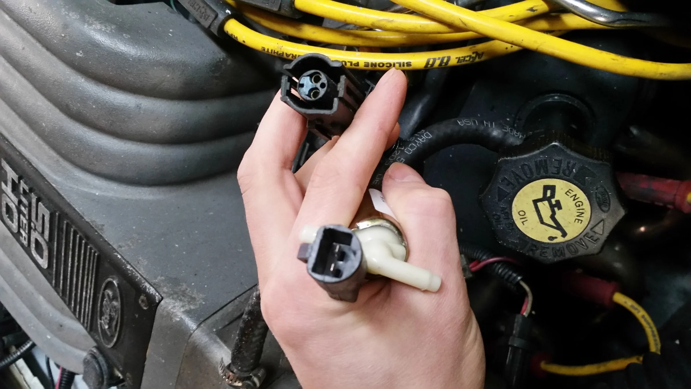

I'm getting ready to pull my engine and removed all the front accessories and saw my charcoal canister and purge solenoid and remembered this thread so I took a couple pictures for you. Hope this helps.
Thanks man, that's very thoughtful of you! I have actually already located all the components. My question now is if I can use the solenoid without the pigtail, the one without is the only one they had at Lordco, I can return it and get that one thou if I need too and than I am good just have to hook it the system back up, is that 3/8th vacuum line being used from the intake to the canister?
Also, my picture shows how I used safety pins to probe the rear of the connector for the ect sensor right next to the clip for the solenoid you are holding in your picture. I just wanted to confirm with someone if this is the correct way to measure the resistance on the ect sensor? I tried to measure it on the volt scale as shown by jrichker and I got 0. I need to know if I did the test wrong or if the sensor is done for.

If you are measuring Volts, what you did was right. If measuring resistance, it's incorrect, you must unplug from wiring and test sensor.
If you tested resistance, make sure you test with the scale large enough. If you get an open connection, the sensor is toast.

This is how you test resistance of a sensor. Disconnected from factory wiring
Sent from my iPhone using Tapatalk
Can you do this for say the ECT sensor with it still in the car with the battery disconnected and plug removed so I can probe the pins? Here is a photo of my particular dmm, which of the ohms setting should it be on? And than do I just refer to jrichkers chart?It is confusing because different people are saying to test it in different ways. I don't get the voltage chart for checking the sensor that I have seen on here if others are saying it should be measured only in ohms? Is there a test measuring voltage and a separate one for measuring resistance in ohms that both will let you know if the sensor is toast? I learn quick and the car has come along way in the past month but its tough when you get told different things!

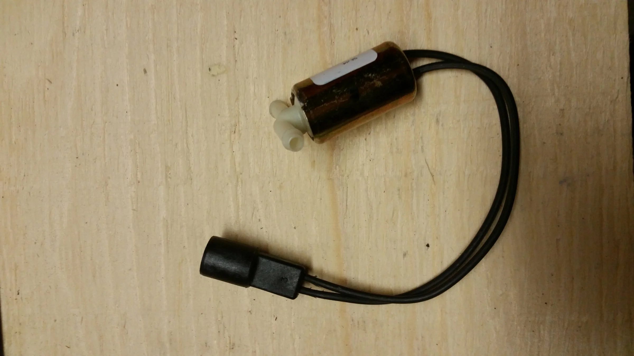

And now back to the original purpose of the post. I went and picked up the purge valve solenoid, there were 2 options. One with the pigtail and one without. I originally got the one without as this is all they had, but returned it for the pigtail one as that is the one shown in all the photos provided to me on here. I have attached a photo of me holding it next to the plug its supposed to plug into. Problem is they do not match, so now what? Do I need to order one from a different manufacturer?
I looked up a few on Rockauto.com and they look to be the same type of connector. I see them for $25-40 on Rockauto.
I'll look tonight at how mine is hooked up

THANK you! I feel like you just shortened and simplified 10 posts into one. I have the new sensor as well so I will do what you just said and compare the 2 as well. The photo of the plug you just sent me looks to be the same as the one I got, the male pins are flat instead of tubular so will not clip into the harness in my car which looks practically identical to the ect plug it shares a harness with.
