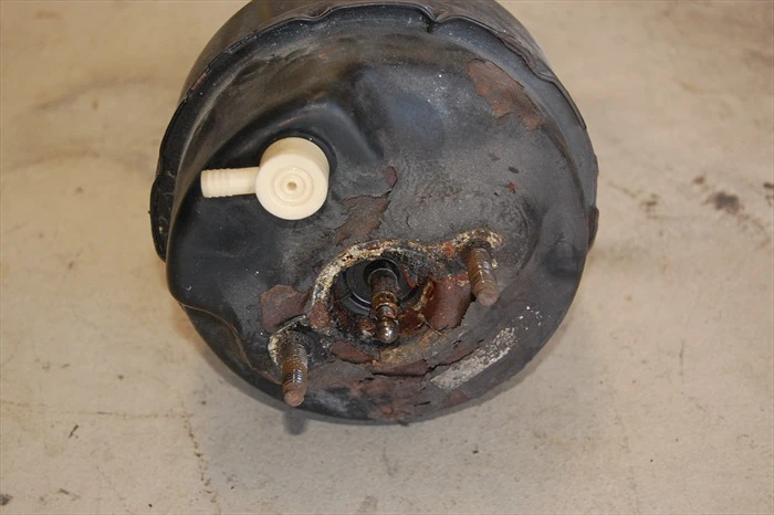

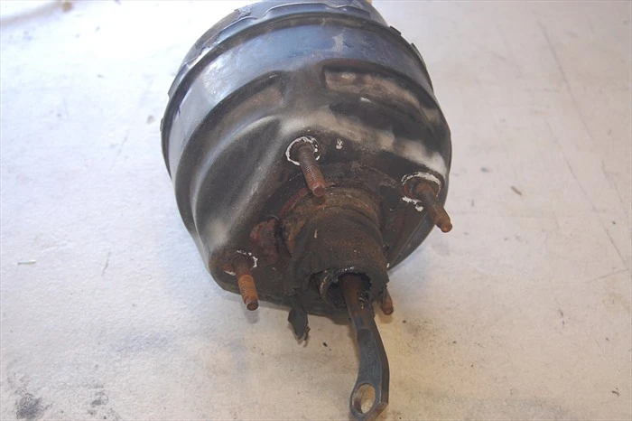

Here's a couple pics of my old booster.
Exactly what I thought after pulling it out.
After coupons and returning my core I paid $65 for the booster. So for that amount of money, the 2 hours it took me to swap it out, and not hearing the hissing anymore it's definitely worth it.
