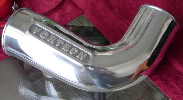

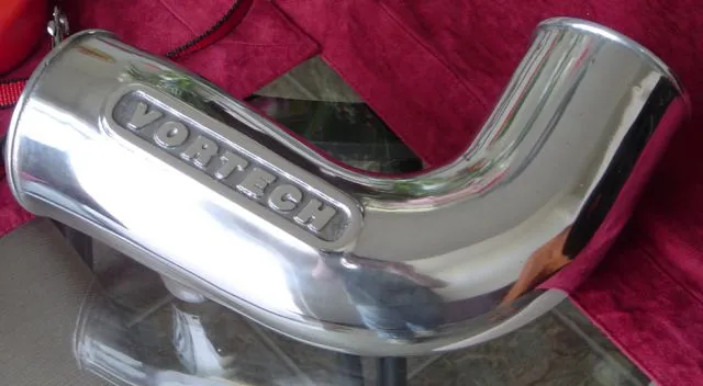

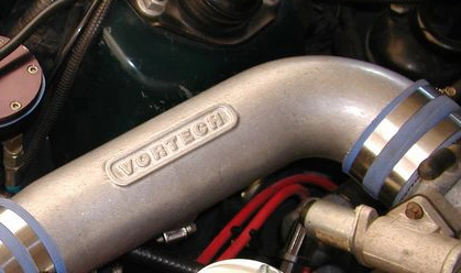

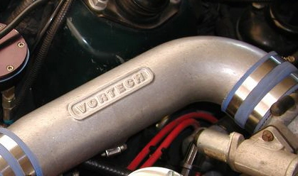

Polished my friend's Vortech Intake Pipe this weekend.
BEFORE - (not the exact one, but is the same material and condition as his was)
AFTER
I swear, one of these days I'm going to start a side business LOL
Just wanted to brag a bit :)

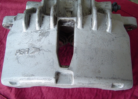

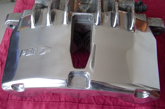

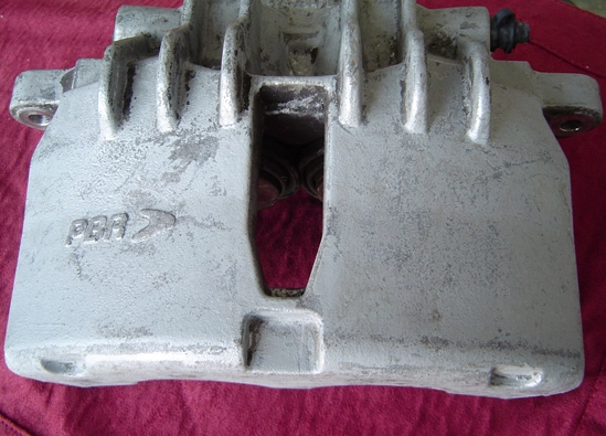

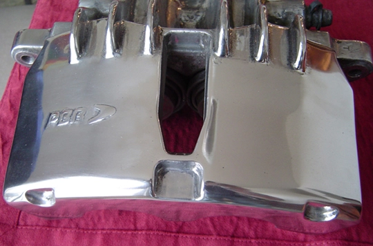

Got bored and did my calipers too. lol
Still have a little work to do around the fins but overall I was pleased with the outcome.
I just clean them off by hand (de-grease or whatever)
And then take 220 or 320 grit sandpaper to them, that's what takes most of the time, getting all the casting marks and flaws out. The actual shining process once sanded only takes about an hour.
