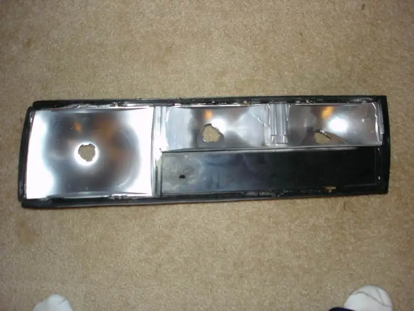

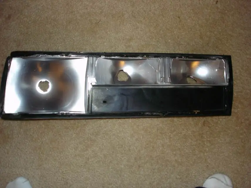

For some reason my passenger side taillight has been dimmer than the driver's side. Both bulbs shine the same brightness but it wasn't reflecting as well. Since the car is down i decided to pull them off and respray the reflectors.
As you can see, not really much inside that would shine. These are 1983 taillights...so 23 years of heat has taken their toll on them.

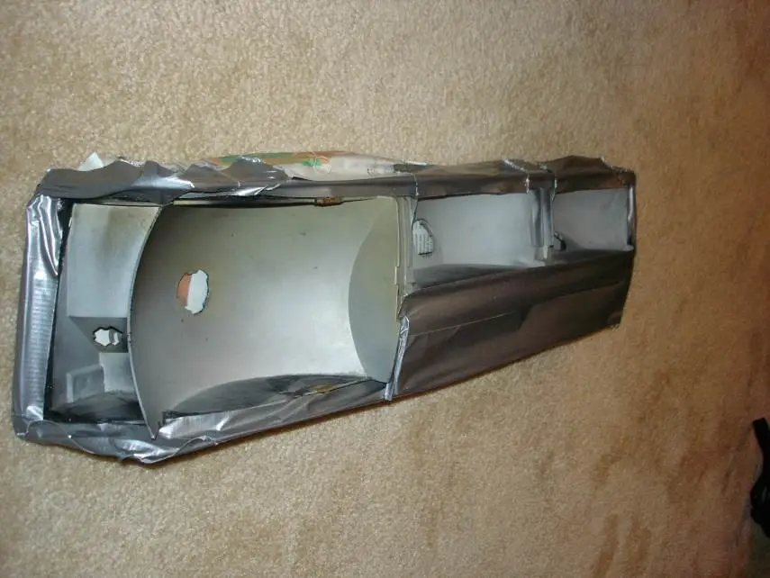

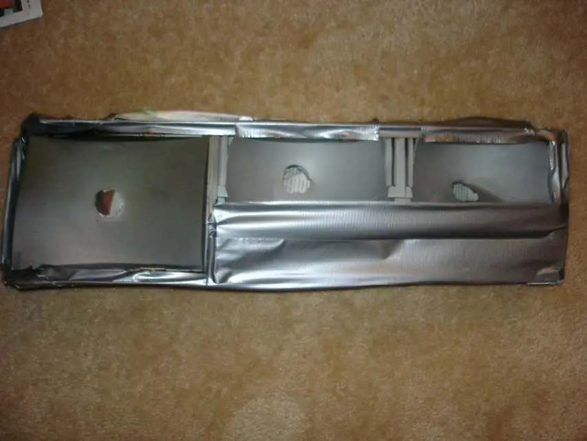

After a few coats of chrome paint. For some reason my camera shows the chrome a little more dull than it really is.

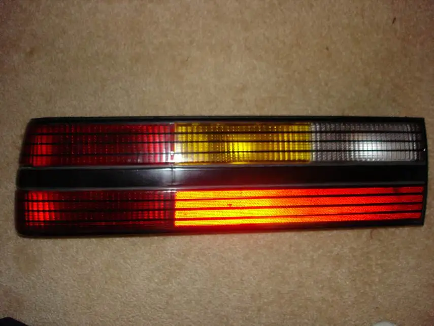

And final product. I polished the lenses, painted the center bar and restriped. Some fresh Butyl Tape to seal them back up and good as brand new. Not bad for 23 years old.
I paid $25 for the pair of lights 3 years ago :)
