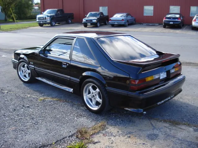

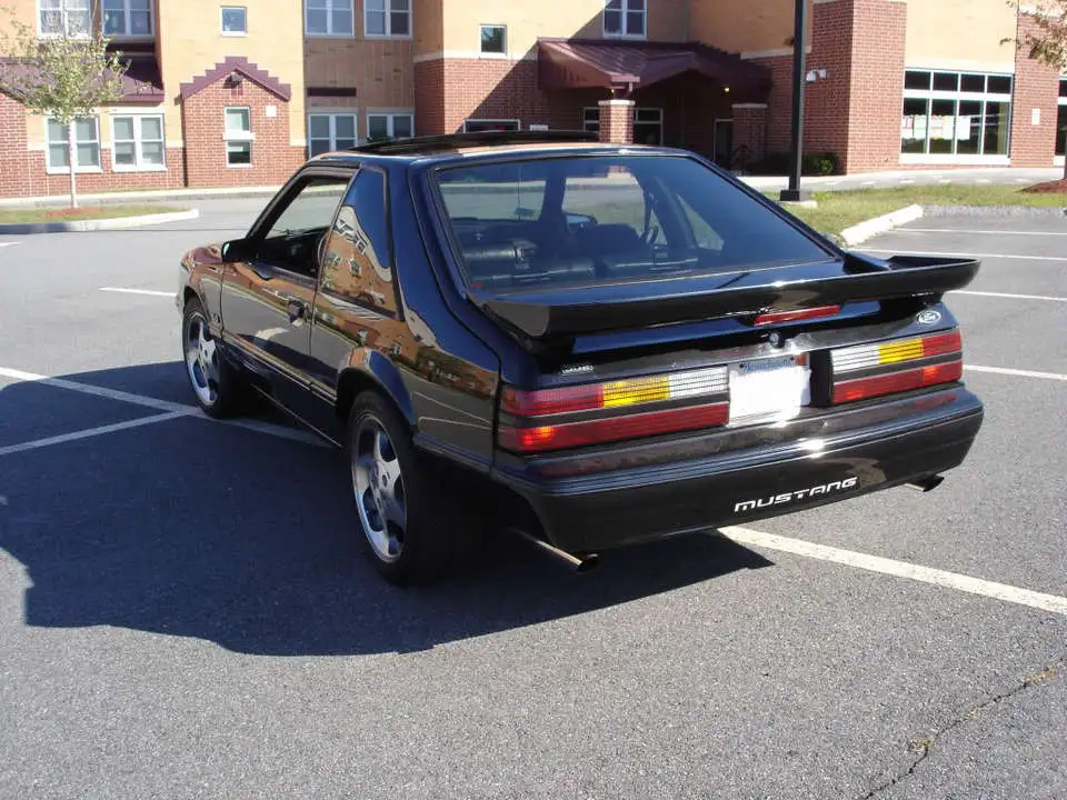

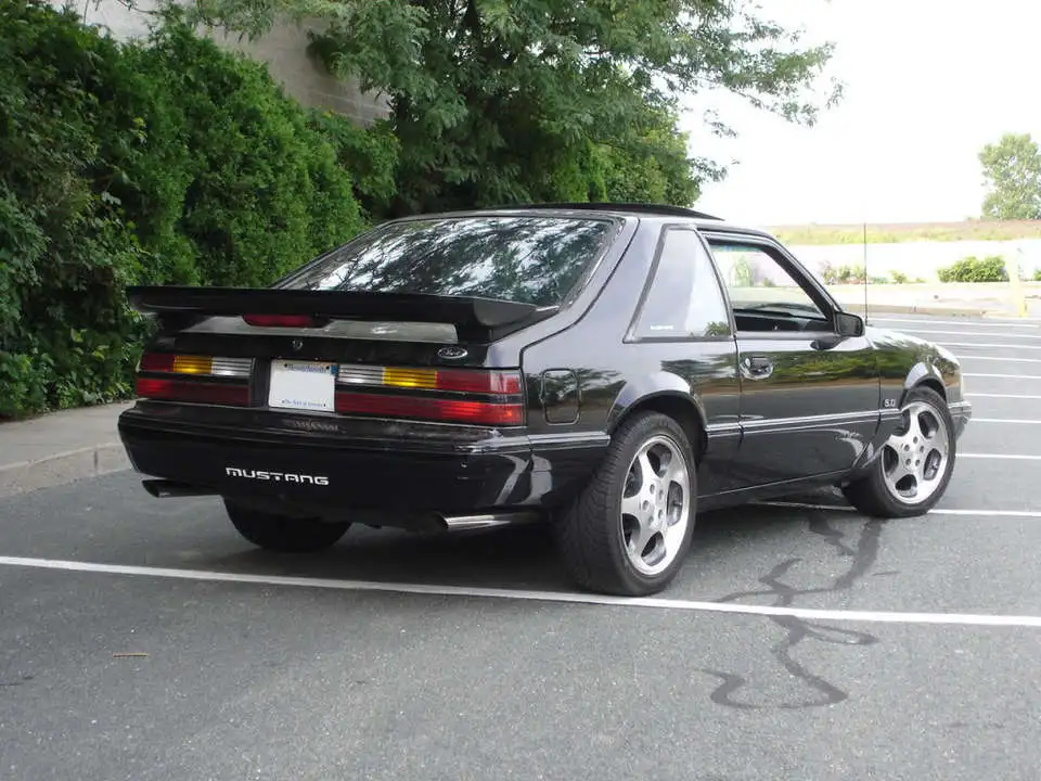

Hey guys. Im new here and would like to see an example of this installed on the car,day,night,off,on.. Whatever you guys care to post! Thanks
