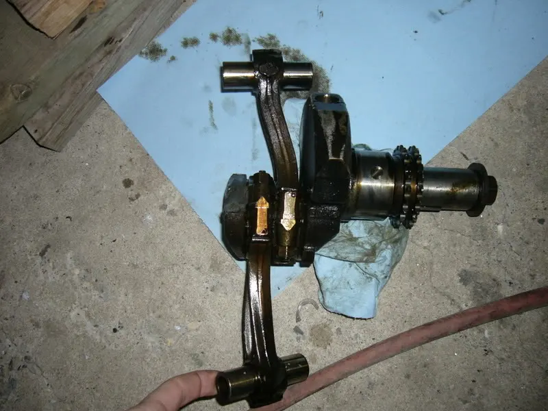

I had a similiar problem, Oil gauge at idle would flutter with RPM when it was hot, anything over 1200rpms and it was golden. Thought the motor had a slight knock at idle, but couldnt pin point it. So i kept driving the car and everthing seemed fine, figured the sender was just going bad or something. Then one day i pulled out to catch up to a 350Z, and bam. see pics for results.
Save yourself time and money, and just pull it now, before it makes a mess
Jay, I'm beginning to realize just how much you like sharing those pics! But they are a very good warning about what can happen in situations like these. you should clean that crank section up really nice and proudly display it when you go to hangouts or shows!
After i posted i said to myself "fack am i picture whore" Haha
That pic is a good warning for people to maintain there stangs! I wish i would have taken pics of the bearings, OUCHHH haha
