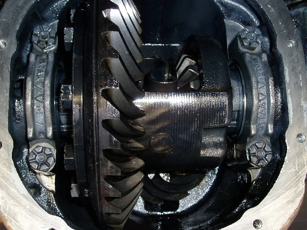

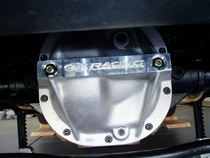

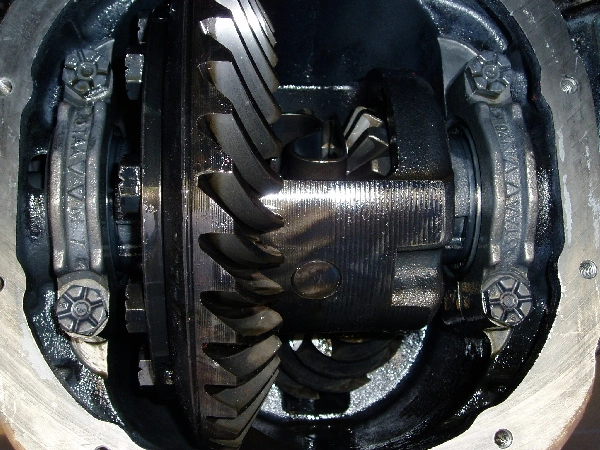

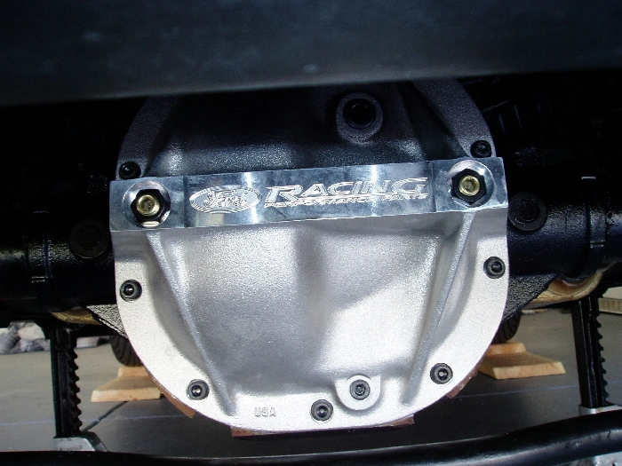

It is normal to have same metal shavings or flakes. as long as there are no chunks of metal you are fine. I suggest using royal purple gear lube, there is no nead to add friction modifier with it.
Put Royal Purple in mine when I changed out the girdle. It already has the friction modifier in it and it takes 2 quarts.

Fast02 said:
Rocketman,
What do those two big nuts do for that girdle?
Thanks,
They are bearing cap supports. See the 4 big nuts holding the carrier in. They put pressure or support to the caps that hold in the carrier and keeps it from twisting during hard take offs.
