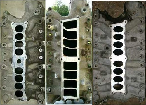

Well the lowers are completely different. The 351 lower is wider than the 302 lower. It won't fit on a 302 at all. This is why it flows better...because it's a wider casting to the runners have more room to sweep and flow.
351 gt40 lower
302 gt 40 lower (narrower)
No idea if the uppers are the same. There are 3 versions of the gt40 upper...so the L prob got 1 of them.
The EGR spacer is different..due to the L having a driver's side TB.

the 302 truck lower is similar to the holley systemax intake (rectangular ports). do they have a 351 lower with those same rectangular ports?
No, the 351 truck lower intake looks like the far right. No other upper will bolt to it.
As a comparison, the 302 truck lower is in the middle and does accept the holley/saleen upper.
302 HO to far left
I don't have the two in front of me, but that 302 lower looks identical to Holley's, and it accepts the Holley upper. I'm sure they're small variations between the two, but Holley developed an intake that Ford was already doing, or was it the other way around...Ford paid Holley for their design? Who knows...thinking about it too much i guess lol
