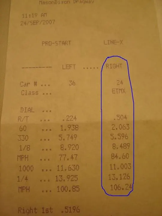

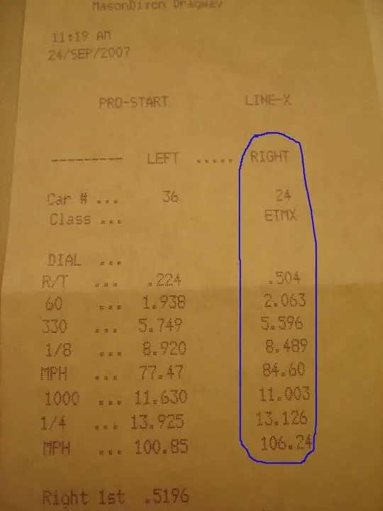

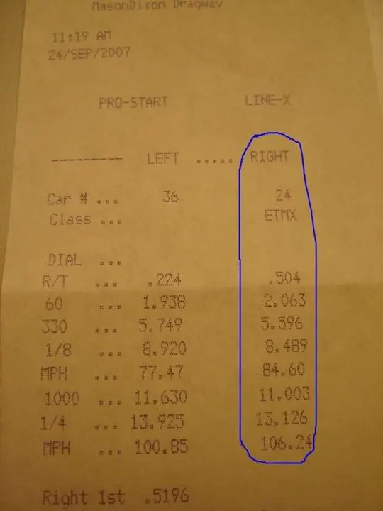

Here is the timeslip for my car(#42)back in April(temp was in low 70s). Not many mods, but fairly similar to yours. I am running OEM 18" tires.
Here is the timelip for my car just a couple weeks ago(temp again was in low 70s). No different performance mods, but the car was 195 lbs lighter than the April run. On the same tires, which with the weight reduction killed my traction, all but my 60' times improved as well as MPH.

Dude those are impressive numbers for a lighty modded car! What all do you have done to your car? I bet with some lite wheels and slicks you would with out a doubt have a 12 second car! Man my wife's 07 GT 5speed needs to run that good!:nice:

Those runs were on the factory 235/50-18s running 33 psi. Next year I will have som MT ET Streets:nice: I took out the passenger seat, back seat, Shaker1000 sub box/amp rack and once to the track, the spare and jack. Read "Put my car on a diet" thread for detailed info.
