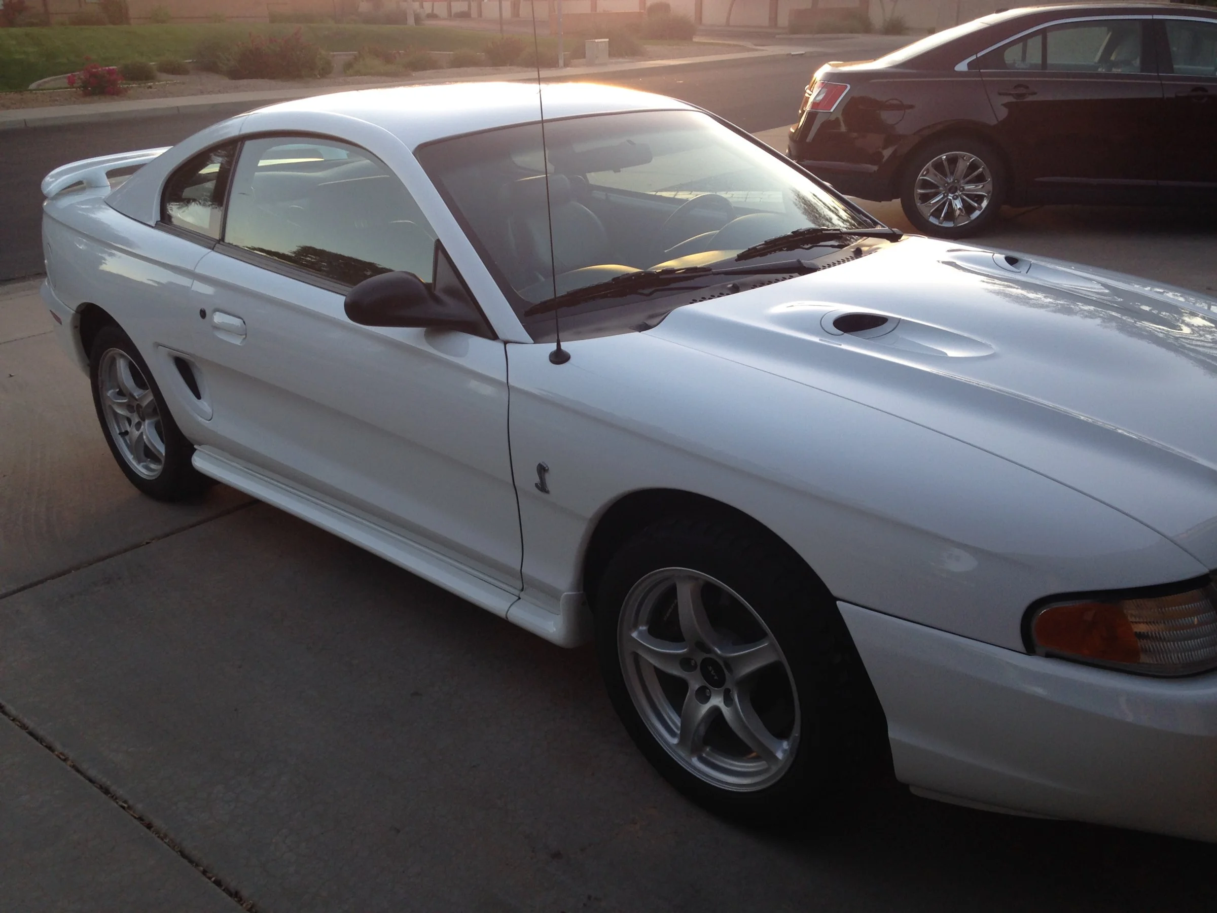

9CB46A49-0A4A-40F8-ACF5-D359C4BFBF29.webp So, I just purchased the 98 and awaiting pick and delivery. Cars were identical, so I went with the 98 being it’s the last year of that body style. The rims and no clock was a odd draw for me also. This will be the first 4.6 ever owned. Never even drove one. Past 22 years always consisted of 5.0s . So looking to keep it stock aside from getting rid all the cats. Any recommendations for a plug in play x-pipe or xpipe. One better then other for this motor.
