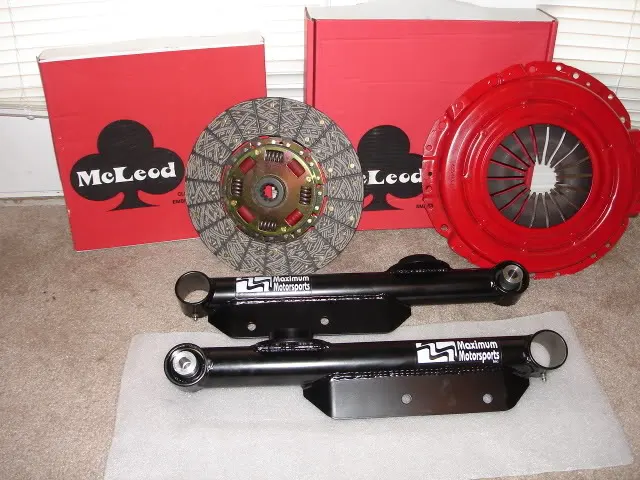

I say MM. Why? Because thats what I have of course :)
Nice to see you around Tom :)
