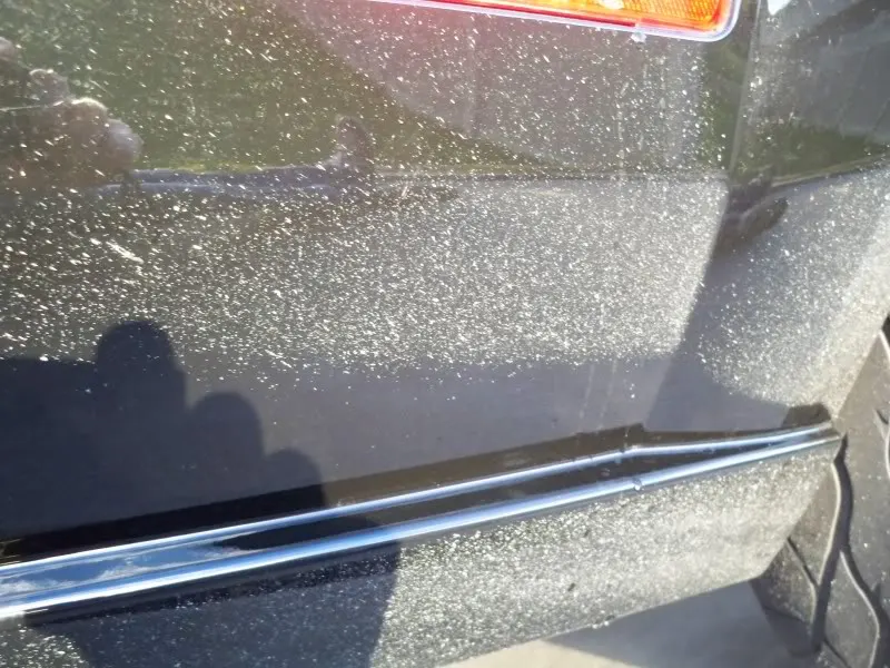

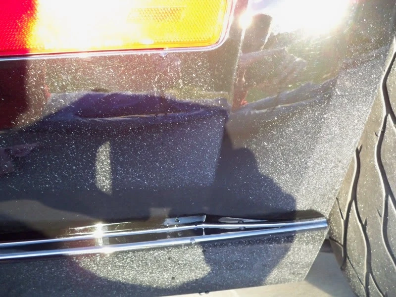

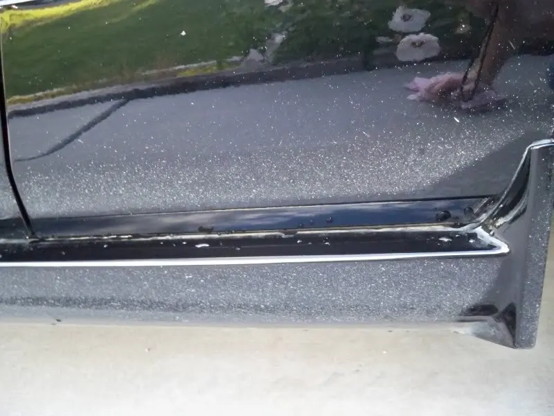

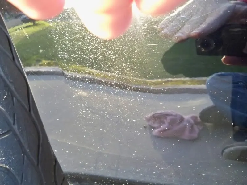

Hey guys, I bought a 2008 Mustang GT brand new 3 years ago, I have been very happy with my car. It is my second Mustang, but the paint on the car keeps me from really enjoying it. It chips so easily, I just can't believe it. It only has 35,000 miles on it and every time I wash it, I just want to sell it.
I know that black is a hard color to keep up and it shows all the scratches, but I think this isn't normal. I took it back into the dealer after I had owned the car for 3 months and they would not do anything. I also have called Ford twice and they don't do anything either.
I bleed Ford blue, it's all that I have ever owned. My wife wants to buy a Edge, but I'm really let down by their customer service right now.
Behind the front tire
Infront of rear tire
Behind rear tire
Behind rear tire
Do you guys think this is normal?

What I see is debris damage on your paint. If it's not excessive debris then it's faulty paint. You should try and gauge what it takes to actually damage the paint by intentionally damaging it. Try using your hand or some other type of soft scrubber that would not damage a normal paint job and see what it would do. I think at this point though, you don't have much recourse.
After looking at the pics again, if the damage is not from gravel, then the paint is defective and would fall off if you messed with it enough by hand. I can't see anyway that damage is just bad paint if you can't scrape it off easily with your hand. It looks like every little piece of debris has taken off some paint.

No doubt its flaking paint like you say it is but have you tried clay baring or polishing it out, honestly it looks like more like road grime or overspray, just by the looks of the photo that's what it looks like to me. Obviously your there to confirm or deny that.
I have buffed it a few times, with the last time just being a couple of weeks ago. It doesn't do a thing for it. I've also clayed it, but that didn't do anything either. When you touch it you can feel that it's chipped.
Ateup, I have quite a few chips in the rear quarters where that body line is for side scoops? Does that make sense?

I have tried that a few times. I even bought some tar and bug remover and that didn't help either. You can catch the chips with your finger nail and feel that they are chips and not bumps. It's weird when I rub the tar remover onto it because it starts to lighten it up, not all the way but it helps then I can slowly watch everything re appear.
Judging by the chipping patterns and the color of the defects, it's obvious to me that it is indeed paint chipping that was caused by road debris. It's so bad, it looks like a bug would have caused it to chip. Did this happen gradually? I really have a hard time believing if it is defective, and that easy to damage with road debris, that you couldn't damage it with a pressure washer. What kind and size tires do you run?
I noticed it when I first bought the car within a couple of weeks. I thought it was just because of the car being black and I could noticed things more. In about 6 months it was pretty bad and I took it back to the dealer. It has gotten worse since then, but it has looked pretty bad since after the first 6 months of ownership.

I would call Ford customer service and complain.... Im a painter for a living, That is not normal..... Rock chips are normally found on hoods, fenders and front bumpers... But its not that in your case...
It could be a bad batch of primer in those areas... or other wise know as delamination.. where you paint starts to come off in areas..
That happened to my Roush on the right fender, I took it to a Ford dealership. The Bodyshop manager came out to inspect my car.. Not knowing Im a painter for another Dealership.. He says to me looks like battey acid got on your car... So OPENED my hood and showed him I have Optima battey it cant leak.. and it has been in the car for 2 two years. I looked at him and said it looks to me like it has delamintion cause the paint is popping from the inside out... He just looked at me .. and said we will get it taken care of ... But call Ford and complain!!!!! tell them your thinking about buying another ford product.. But you have changed you mind because thier not standing behind thier product..
