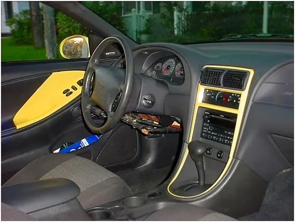

First off, you obviously have to remove the door panels, which are an easy straight forward procedure, which involves 2 phillips screws, one push botton on front side of door panel, and of course the removale of the arm rest panel deal ( pops out with a flat blade screw driver on top edge, and unscrews with the 2 phillips screws holding the window switch on) Then you just give the panel a nice tug upwards, and wiggle it out.. easy stuff, while i was at it, i just repainted the arm rest and center radio bezel deal... easy stuff, it just pops right out, as does the shifter bezel.. give em a tug, evenly and they will pop out.
Mirror unbolts with 3 7/16th nuts, and needs to be unplugged, and the plug and wire pulled through the hole in the door for the mirror.
After that I sanding the mirror with 280 grit until semi smooth.. it still had visable indentations from the mirrors textured plastic.. No worries, the primer and base coat with fill this in. Then i sprayed them with a cheap primer, let dry and sanding with 320 grit, and sprayed them again.. Let dry, and then sprayed the base coat on ( color)... It was late, so i let it dry over night... Then sprayed the clear on in the morning... let dry most of the day, and re installed the mirrors.. easy as shi*
Of course, to do this the right way, you'll need a compressor, gun, ect.. base coat, clear coat, hardner, thinner, tape, cleaning cloth, and 280-320grit paper.

very nice job on the interior, if ya dont mind me asking how did u do it? just pull them out and paint them? ive been looking to buy the whole inside trim kit but if its as simple as pulling them off and cleaning them then painting them then ill save myself some money and do it...

thanks guys, im still also undecided as to if i like the mirrors or not.. No big deal, i have someone with a zinc yellow coupe, that would trade me back for black ones. Im going to wait to see how it looks when im done with the rest of the body work (as in bumpers, wing, side skirts)
The hood on the Red 94 behind the yellow 01 is a Keanen SVO R hood.
You can see more pics of the car in the link in my sig.
As for painting them, its real simple..
Ive actually already had these pieces silver, and decided i wanted somthing new, so i went with yellow... But for the first time around, i basically just sanded them with 400 or somting really light, just enough to scuff the stuff up.. then primerd them, and sprayed the base coat, then 4-5 coats of clear... real basic stuff... You gota use good masking tape, and make it all even, and itl turn out just as nice.
