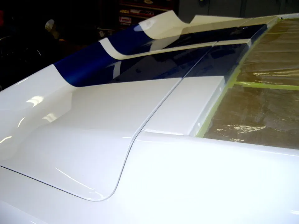

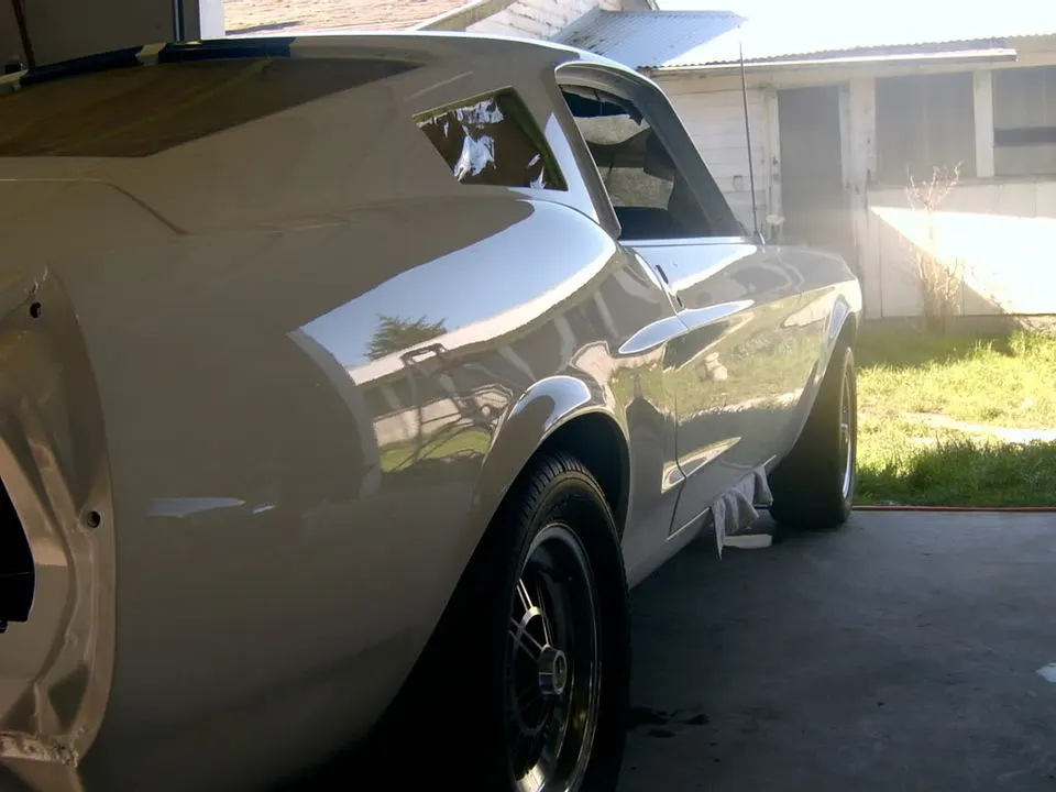

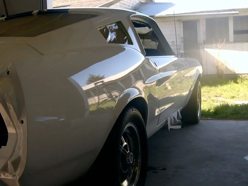

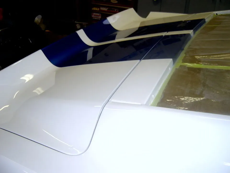

I painted my car a few years ago, and I can tell you it's not rocket science, but it is very time-consuming and a lot of work. I read a couple books, rented a video, then sucked it up an gave it a try. Here's a couple pics of my very first paint job.
There is very little dirt, almost no orange peel and only a couple of small runs. All of it will buff out, and I did all the work right where the car is sitting in my garage. It's just a matter of cleaning your garage out as best you can, get it WARM and be patient.
Also, after using House of Kolor paint, I am a firm believer in using the very best stuff you can afford. I chose House of Kolor primarily because the books I read were written by Jon Kosmoski, who started House Of Kolor. But I was very, very glad I did. First of all, it's very inexpensive price-wise. The Shimrin base for both the white and blue were only (if I remember right) about $30 a quart. Although it sounds like a lot, I only spent about $1500-$2000 on materials, including the $150 Devilbiss gun. Because money was tight, I used the same gun, start to finish. That's kind of a no-no, but I cleaned the gun very carefully everytime and got away with it. The neat thing about the Devilbiss gun is that even though it's made overseas, you can get parts for it at any local paint store. Mine came with two tips, and I bought anohter one for the epoxy primer for $25. I also used a LOT of paint because I did the door jambs, engine bay, etc all in white. I also used about twice as much primer as I needed to because I blocked the car 4 times. That epoxy primer is spendy, but necessary. Give it a try, what's the worst thing that could happen?
