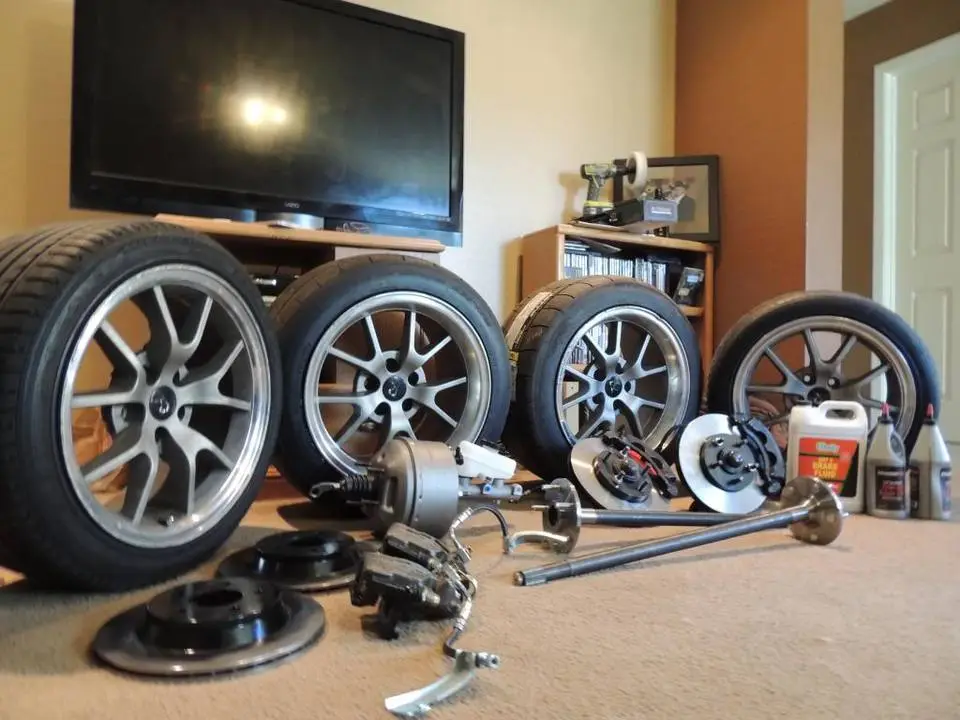

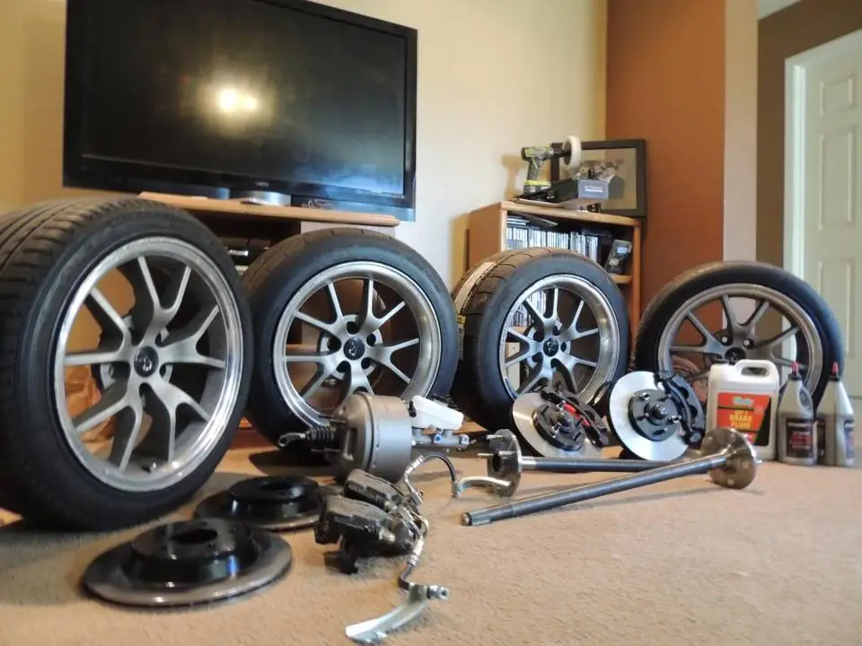

well I think im done getting parts for my 5 lug swap. so just to be sure id like for yall just to double check me. ill start with the front then rear then engine bay stuff.
Front:
95 spindles w/ hub assembles
PBR calipers from 02 GT w/ mounting bracket, pads and rotors
brake lines 95 mustang w/ 7/16m->3/8f converter
Rear:
92 Ranger axles 29.125 inch w/ arp wheel studs
NRC cobra bracket
03 cobra calipers/ brackets/ pads/ rotors
95 brake hoses w/ 7/16m->3/8f converter
rear axle bearings and seals
diff fluid
underhood:
93 cobra brake booster
95 master cyl
MM 3-2 converter
MM proportioning valve elem
MM manual proportioning valve
Other:
17x9 fr500 245/45
17x10.5 fr500 275/40
my total for this swap is currently $1800 including wheels and tires.

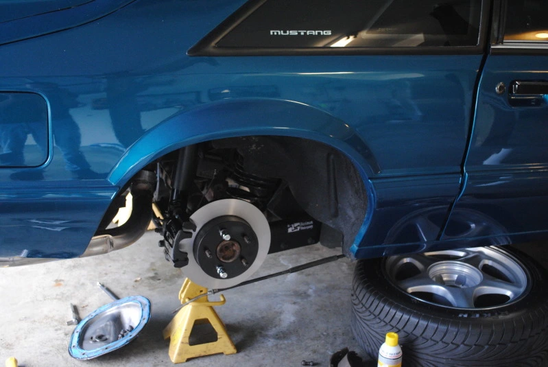

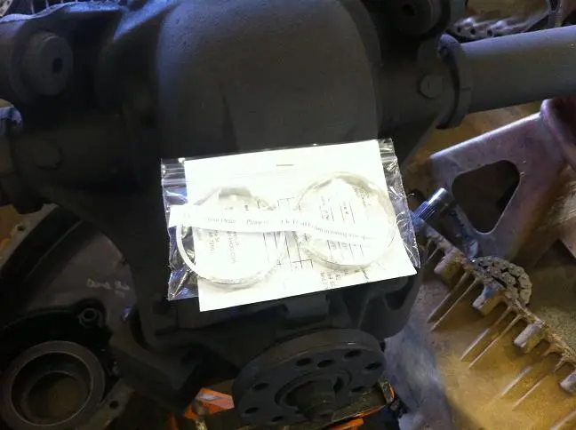

I think ReefBlueHatch is talking about these spacers.
I can't for the life of me remember where I ordered them from.
Yes, those are the ones! I ordered mine from Disc Brakes R Us. Nice people to deal with and the spacers worked great. $30 including shipping, I'd rather spend $30 than trying to make my own.
http://www.discbrakesrus.com/make/ford/axlespacer.htm

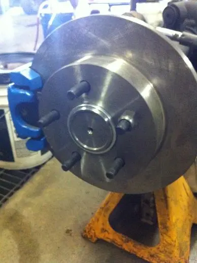

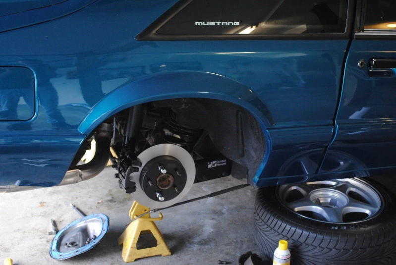

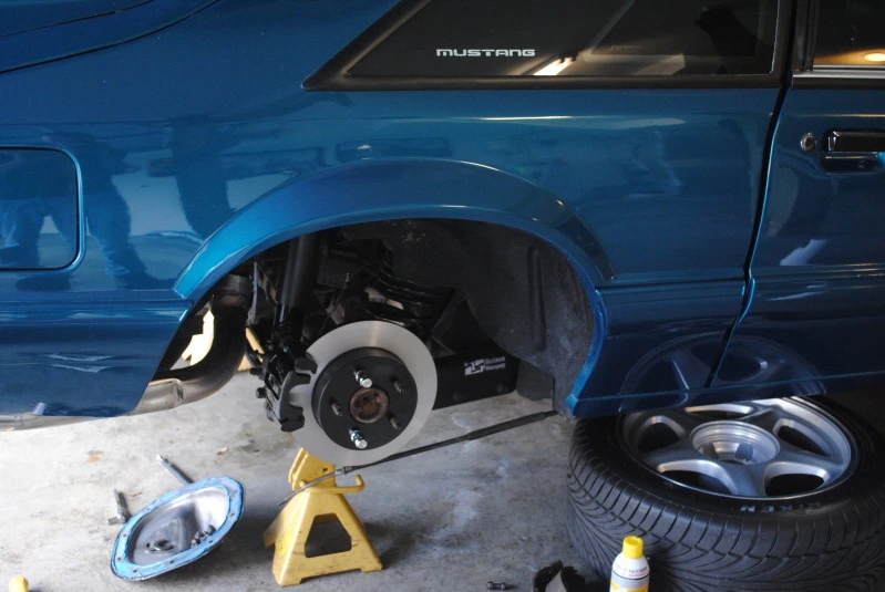

Here's a pic of my swap, there's a pretty big gap.
