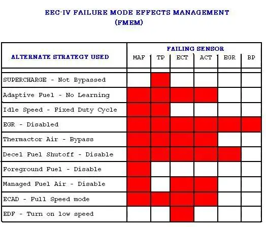

That's even worse than unplugging the EGR and leaving it all umplugged. Now the computer will think it's functional and pull timing and fuel at part throttgle settings and run lean.
Personally, i don't see why people remove the EGR. Whoever said it robs HP is just spilling a bunch of baloney. It only works at part throttle and does help slightly with fuel economy. The minute you whack the throttle it shuts off.
I've seen more problems associated with the removing the EGR and tripping the light than leaving it be. I'm not entirely convinced that when the light trips the computer completely shuts off the EGR as i usually see guys having lean or backfiring probs with a disabled EGR as well as other drivability probs that were solved by repairing the EGR system.

The ECM doesn't pull timing, it adds spark advance based on the opening rate of the EGR valve as read by the EVP sensor. If the system detects an EGR failure, it automatically shuts its function down, and the EGR spark adder function is not used. That is normal Failure Mode Effects Management (FMEM) strategy when the EGR fails. Again, the light doesn't have to trip, if the system doesn't "see" the EVP voltage change when it activates the EVR solenoid, it logs code 33 (EGR not opening) and the EGR spark adder function is shutdown. JIC, so you believe that is the case, here is the single sentence section of the GUFB strategy that explains it + the FMEM strategies/sensor failure.......
