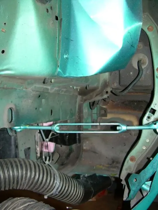

This is looking forward in the passenger side wheelwell.
