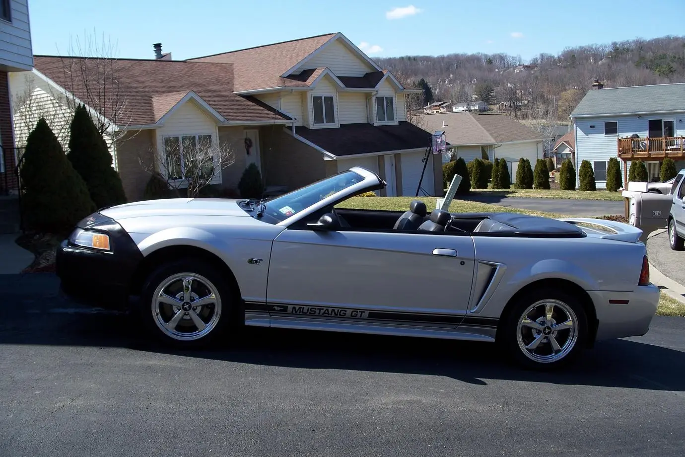

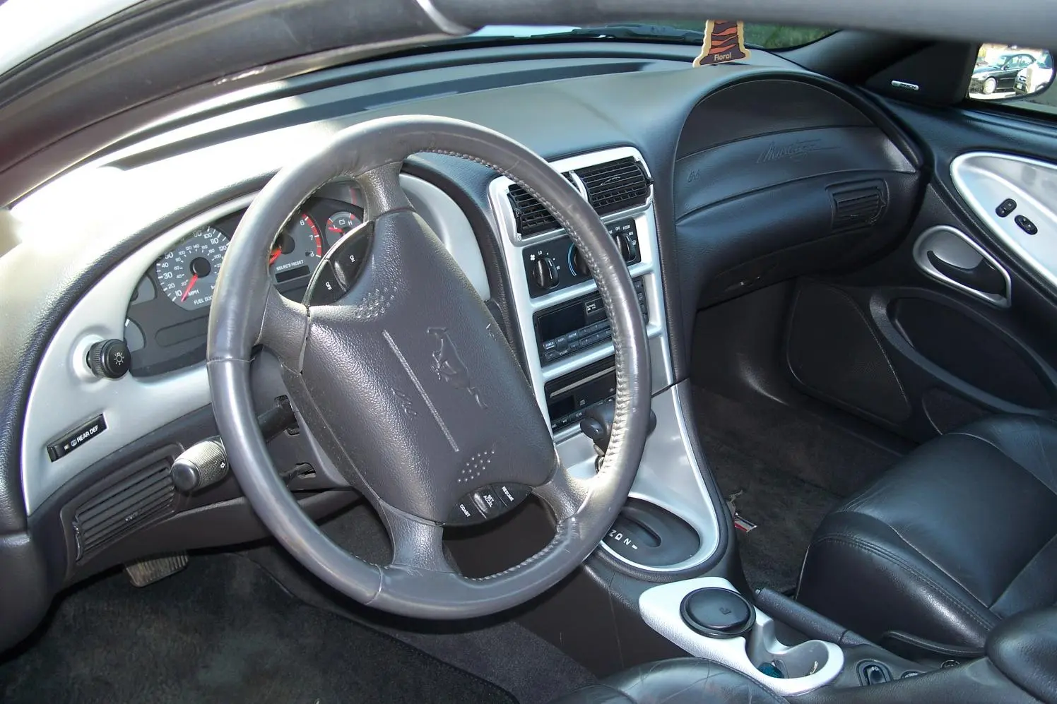

If the pic uploads, here is what I have done to interior so far. The panels were taken out, cleaned, roughsanded, primed painted and clear coated to match exterior pait. All came out ok, but had some difficulty with cup holder and arm rest. I ended up suspending them from wire and painting them upside down a little bit at a time to eliminated drips. Just put a new top on in November, maybe light bar if I work up the confidence start drilling holes in my panels
