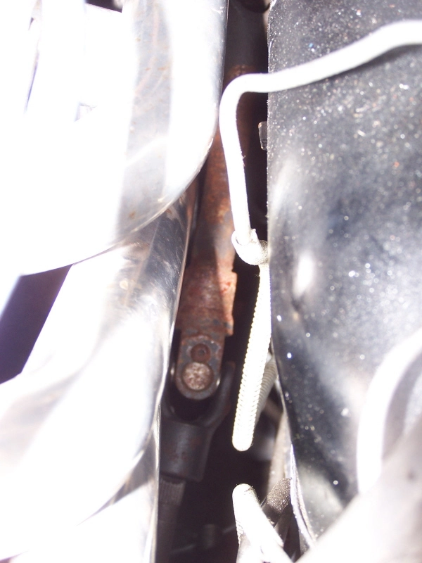

I used the same, here is the only shot I have of it. Hopefully this is what you're looking for!
100_1695
If you look closely, I ended up turning the smooth side OD down a little bit to make sure I had clearance with the headers. Also, when you cut the shaft, it will need some cleaning up to be able to fit the smooth side - as I'm sure you probably have already figured out!
As far as tie rods ends, I used stock ends and haven't had a problem in the 10+ years I've run this setup.

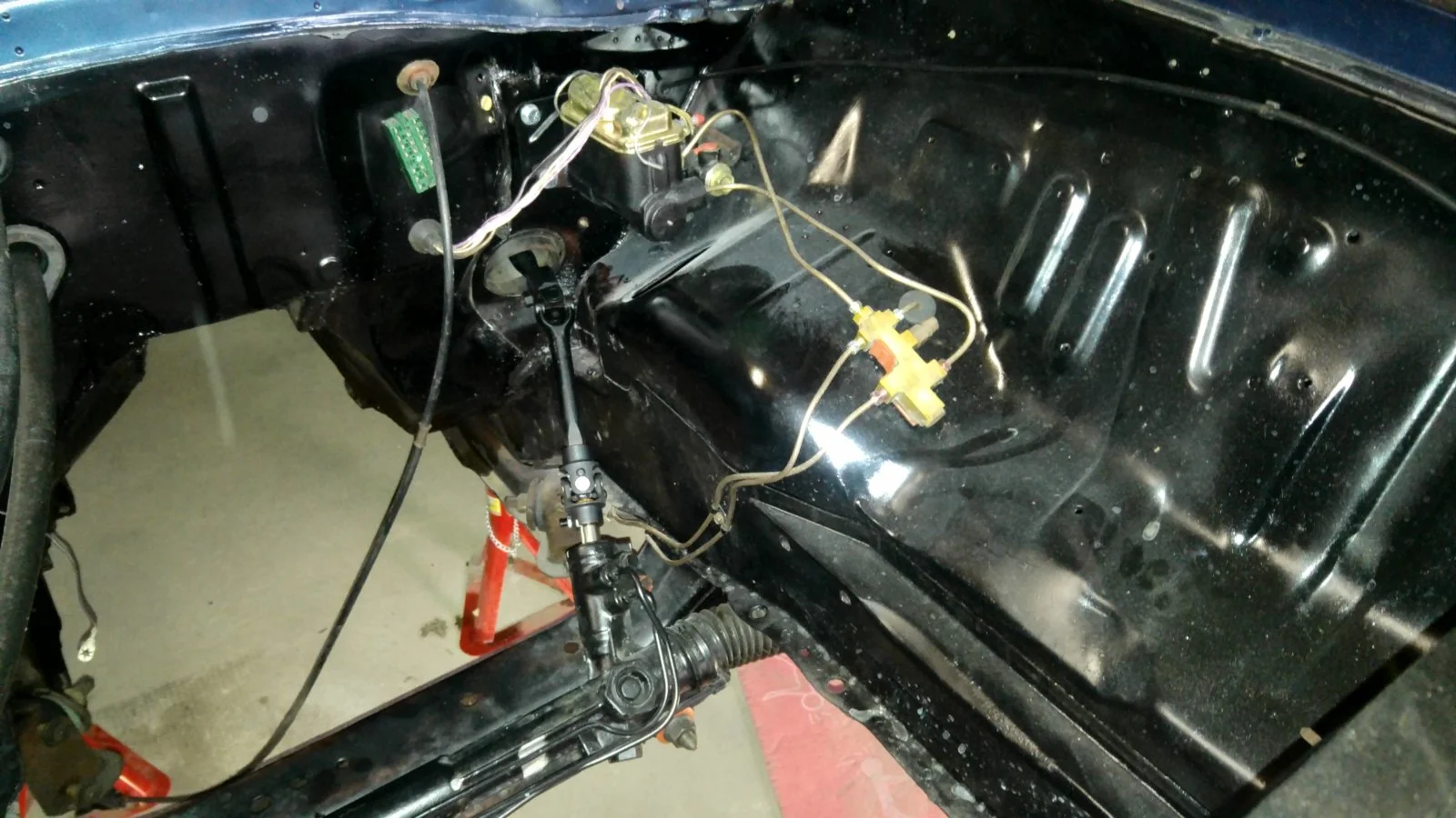

I also removed the rag joint and replaced it with an U joint that has a DD-profile on the "steering colum"-side. I ground it down with info from this PDF:
https://www.ididitinc.com/files/pdf/howtomakeaddshaft.pdf
Now im able to exchange the U joint if its getting loose, because it is still removable. The u joint has two adjuster screws (on the DD side). As I torqued them down everyting is without endplay.
Here is a photo:
A mate - whos driving on historic motorsport events (manly rally) with american classics - recomends to use borgeson parts because of their good quality.
Best regards
Bernhard
ps: i used a cheap u joint from ebay, but with the DD-profile i'm possible to remove it and replace it by an new one (then from borgeson), if it gets loose
