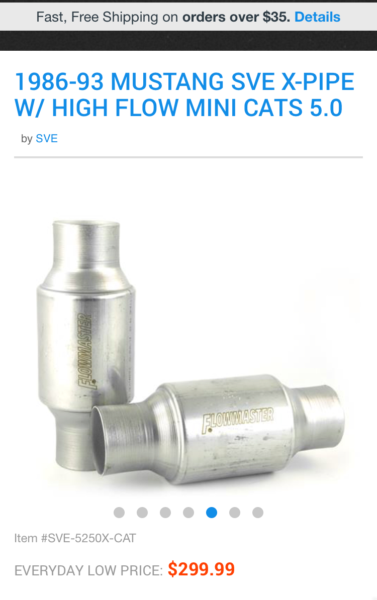

Came across this video today, thought it was relevant to the discussion here. If Flowmaster is condoning the installation of their universal cats on a pre-emissions car, then I would guess running them without an air pump is not significantly detrimental to their lifespan.
Also, @MFE92 , thanks for your input. Great information!
Reactions: Black1987 and lizzard
Mmm might be worth a try

Christ almighty, is that for a pair?
Oh wait, I see it's for the whole X-pipe.
These are what I have https://www.summitracing.com/parts/mpe-59926

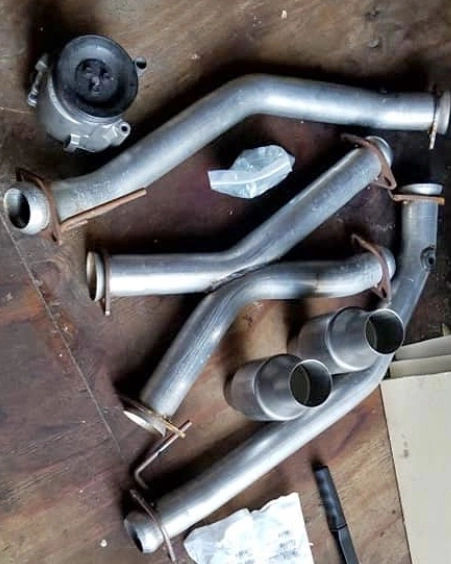

Well as the Mustang Gods would have it. i found a new (or barely used) kit for 50% off local.
