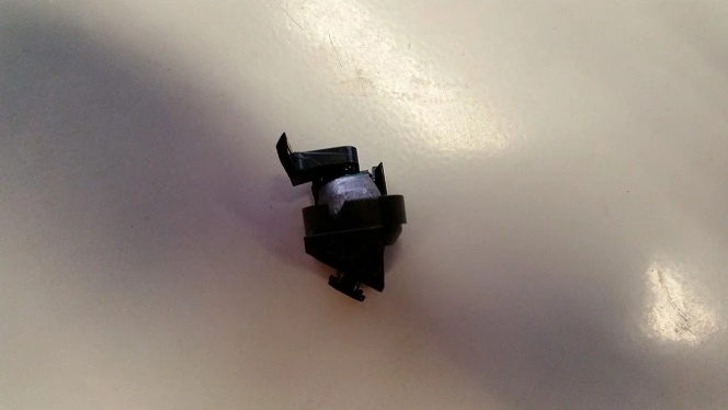

In my case I just removed the pendulum unit from the lower retractor, and I can pull out the belt now. The upper retractor still locks when I do a quick tug, so that is still working. Yeah its not a great solution, but it works.
I might when I get time order in a passenger belt for an 2002 convertible and see if it is possible to mount it in our car. I will lose the lower retractor, but again it better than having a non working or used belt that might or might not work when needed.

Here is the a fore mentioned picture of the pendulum latch that is the cause of my misery
I would strongly discourage disabling any part of a seat belt system, because you are very likely disabling something that will save your life in a crash.
I would also discourage using used seatbelts in your car... You just don't know where they've been.
