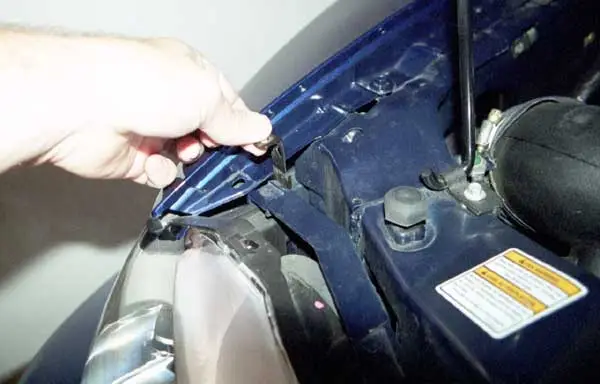

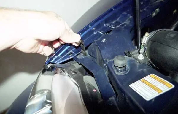

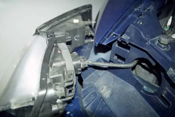

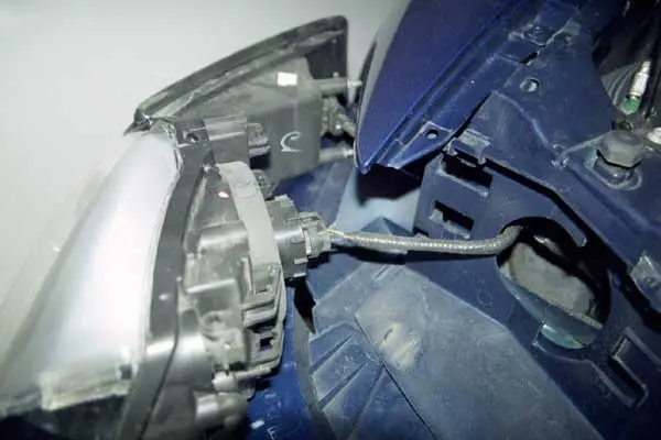

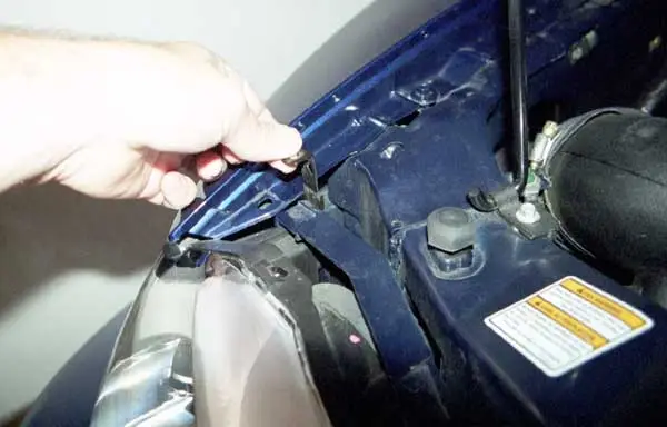

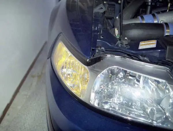

I thought id be nice enough to walk you through it to show you how simple it really is:
The Dreaded Light:
Lift hood and pull the two pins that hold the headlight in place.
Once removed, you can un-clip the two wire harnesses to go to the bulbs.
thank you fnsweet.com :)
The Dreaded Light:

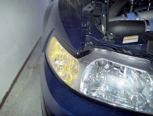

The procedure that you just walked me thru is simple enough to follow. That's not the problem. The problem is that when the headlight assembly unit is taken off and then put back correctly into place inside the header panel, the gap is still there. The headlight unit fits correctly in its place but the gap is still present. I don't understand what is causing the gap to still be there if all your disassembly and reassembly procedure is followed correctly?
I still haven't been able to narrow down the cause of the gap problem.

I bent a retainer clip on my driver side a bit and it makes mine sag about a 1/4 inch. I'm buying a new retainer clip to fix this. Stop being such a vag about the magical paint thats "bubbling and orange peeled" (great work there btw) and pull the two clips out.
If the clips are difficult as hell to get out...THEY BENT THEM USING FORCE LIKE MONKEYS! I know this because I did the same thing. :nice:
*Edit: If you're telling us that you did in fact pull the headlamps out, then I can almost guarentee you it's the retaining clips aren't securely fastening the light to the header.*
