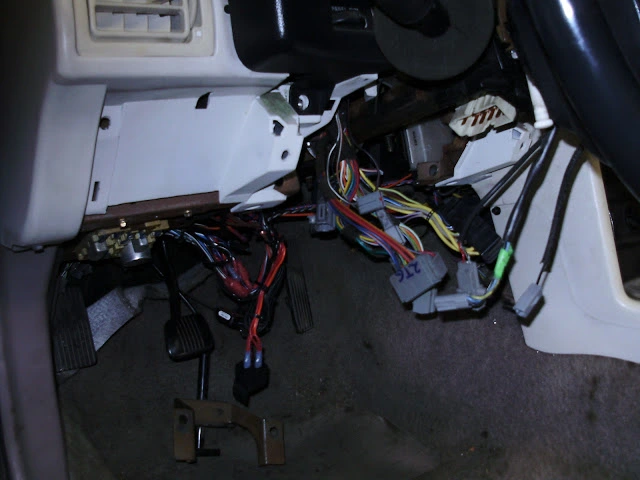

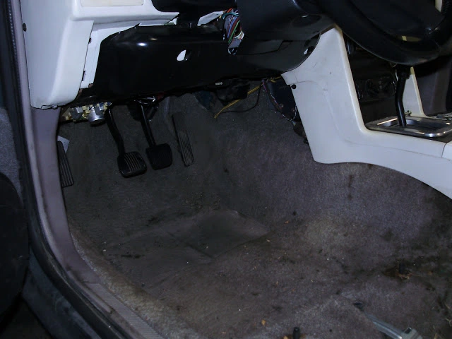

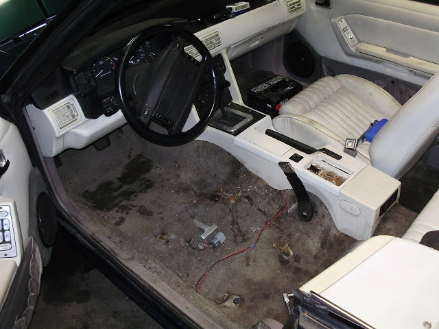

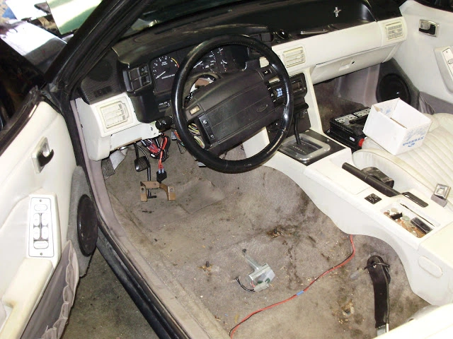

HOLY CRAP!!! When I removed the pedels and the rest of the parts from my 86 it only took about 3 hours to do it all. It took all freakin day just to swap the pedels out and re-route the speedo cable. I haven't even jacked the car up yet. I plan to finish tomorrow. From what some of you that have done it say, the hard part is over. Forgot to take some pics before I left, but the pedels are in, just need to throw the steering column back in, button up the bottem of the dash, put the seat back in, then I can get really dirty underneth. I decided I'm not going to do the carpet with this job, too much extra work. Instead I'm going to wait until my new upholstry arrives and I have to take all the seats out anyway.
Some pics.
Alarm B.S.
Being cramped up on the floor of my car all day makes me wish I had a hot tub.
Seriously.. anybody got a hot tub for sale? LOL

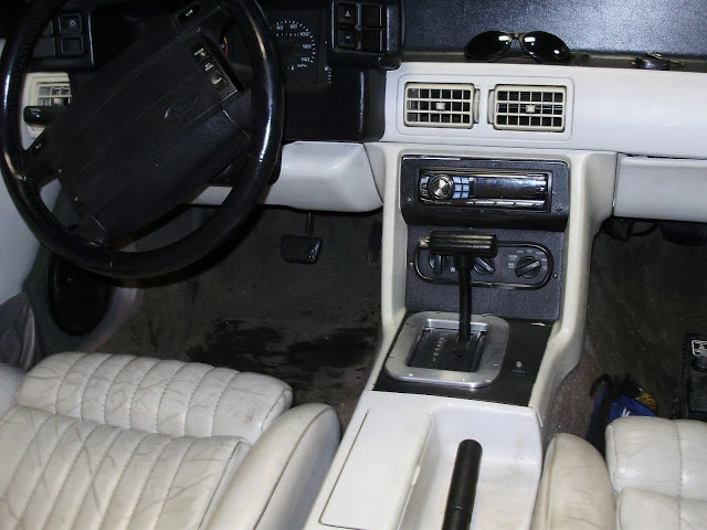

As quick as the 86 went I wouldn't have expected I would be telling you that at the end of day two, it's still and auto :shrug:

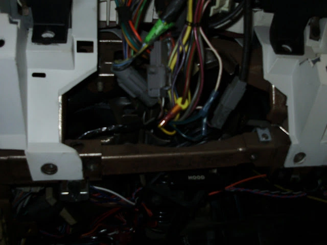

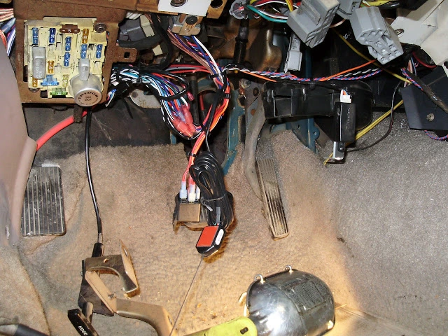

I fought with everything today. First, I got everything back together and tried starting the car. Turn the key, nothing. Turned out the two plugs for the clutch were loose, and with a bunch of alarm b.s. I pulled every muscle in my fingers trying to plug them all the way in. Finally got it started after about an hour of messing with the plugs. Then got the dash and seat back in.

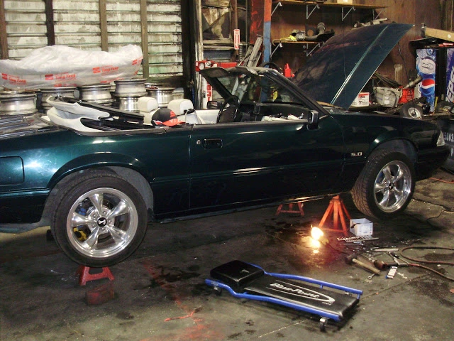

My car is lowered so I couldn't get a jack under either end in a good place to actually lift. So I had to jack each corner and set it back down on 2x4's. 30 minutes later it was up in the air. H-pipe gave me s*** too. I fought with it for about an hour and a half before I gave in and got the sawsall out and then it dropped in 2 pieces. Then the driveline... a normally simple task. Not so in my case. First, the guy that change my u-joints stripped two of the bolt heads. Next the unbolted driveline still didn't want to come loose from the rearend. A little persueding with my Ford tool and she finally gave more than an hour later.
So, end of day two and I haven't even touched the trans yet.
Todays pics.

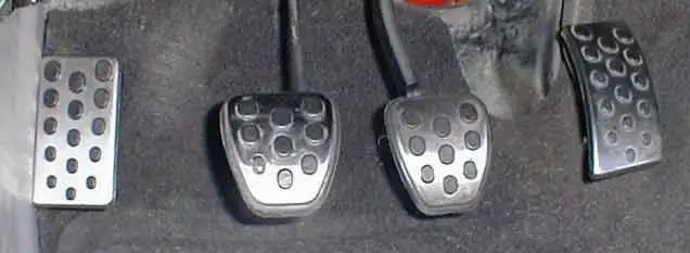

I thought about getting billet pedel covers since I have the billet trim pieces, but that's something I can do later, my local AP store didn't have anything that wasn't ricer looking, or come with a giant foot for the gas pedel. I like the 5.0 ones on LRS, but I couldn't find a gas pedel.
Even those 5.0 pedals seems a little ricer looking. They are just...huge.
I had these in my '03 GT and loved them. Gonna buy a set and put them in my 5.0, but not looking forward to the work required to get them on the brake clutch
