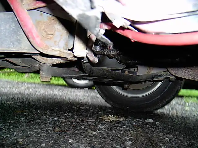

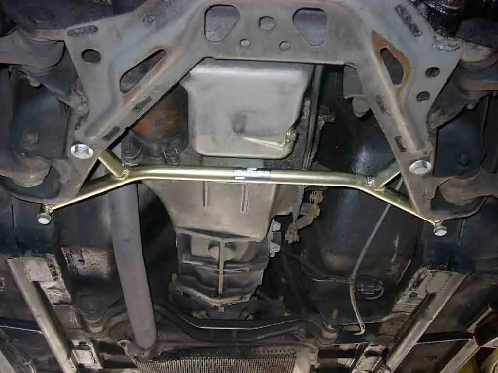

BTW here is a pic of the MM4-point brace on my '90. Pic isn't very good but I didn't really feel like laying in the wet driveway to get a better picture.
Important question Red is your oil pan AL or is it a stamped steel one?
