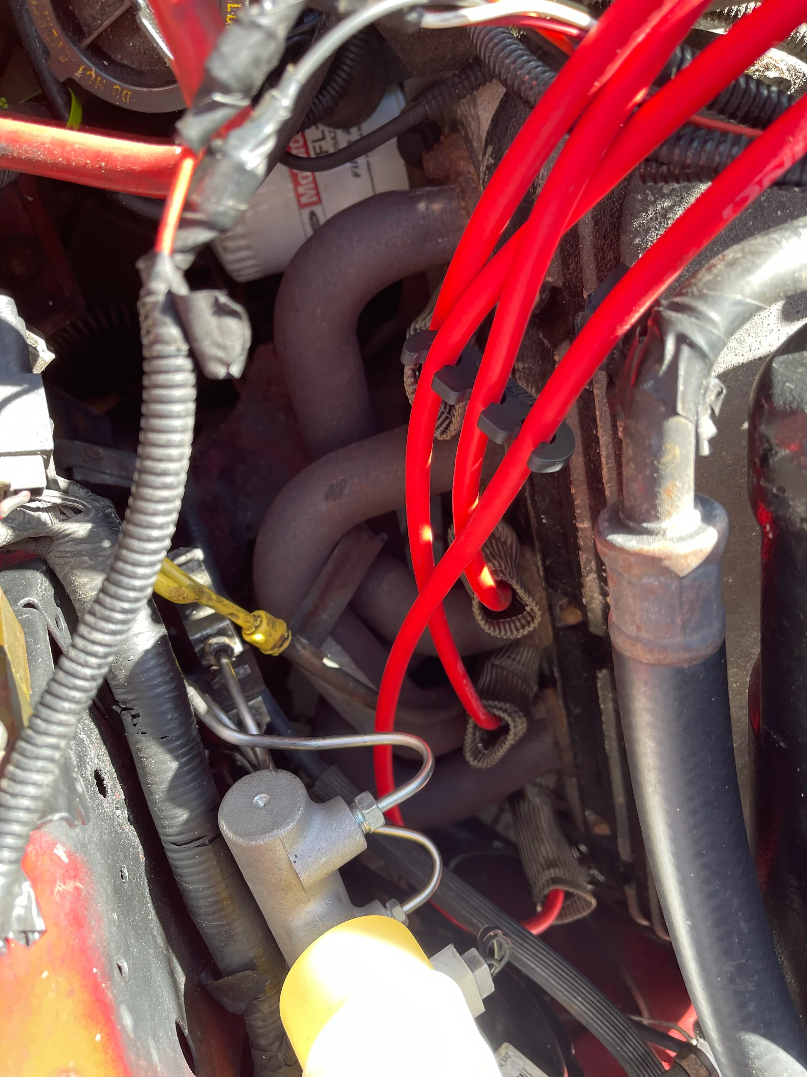

These are my MAC Equal Length Shorty headers I bought back in 03. They don't have a solid flange which made installing them a huge PITA. I wanted to coat them but if they come off I'm just buying a set of coated regular shorty headers.
I dunno man. If you're [really] concerned about the coating then maybe, buy a set of uncoated headers, fit them into the car. Beat, bang, bend, and grind wherever you need to, to make them fit and [then] send/take them in to be coated.
I was told the shorty headers with a solid one piece flange install way easier than the ones without (like my MAC headers).
