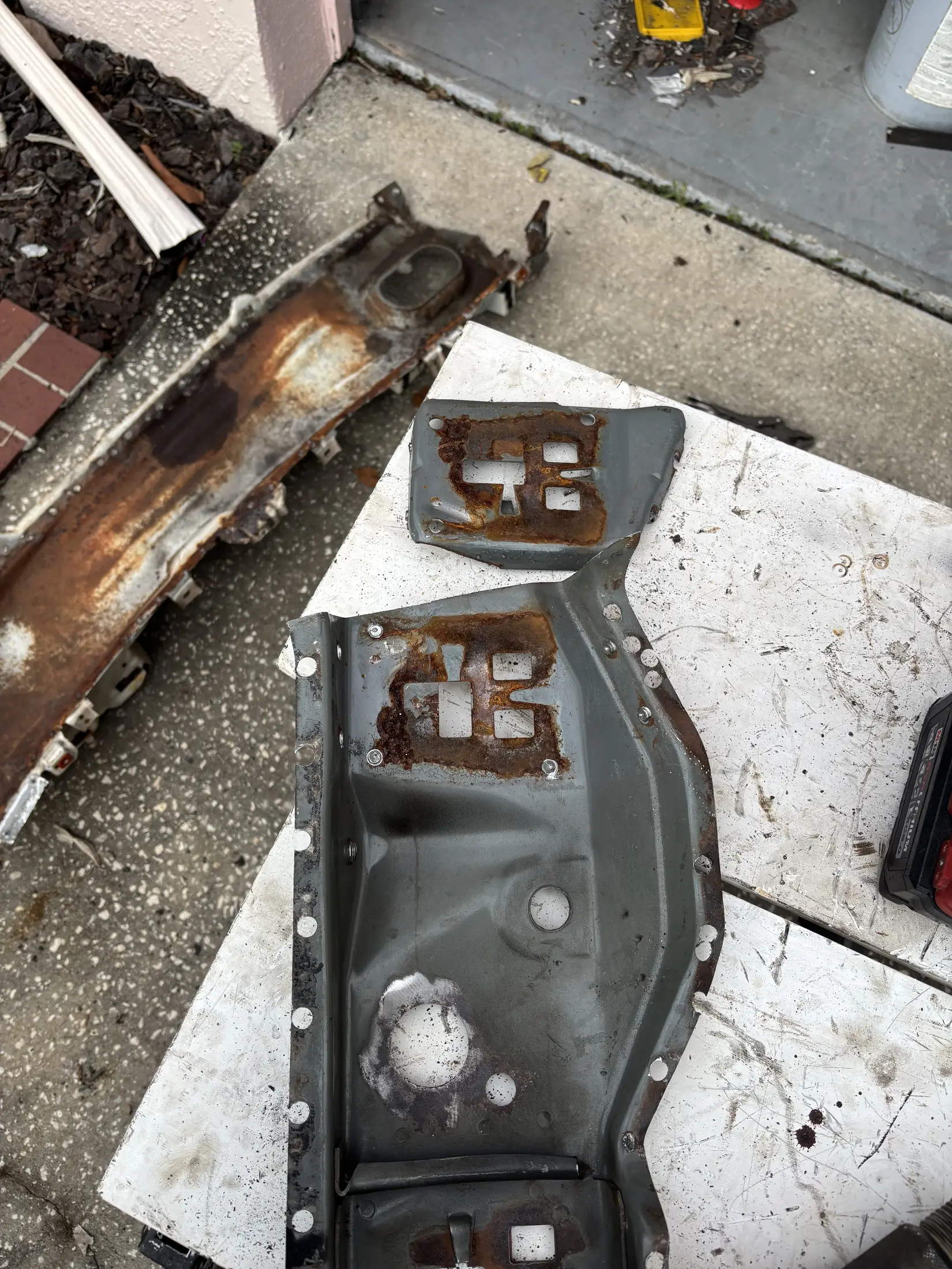

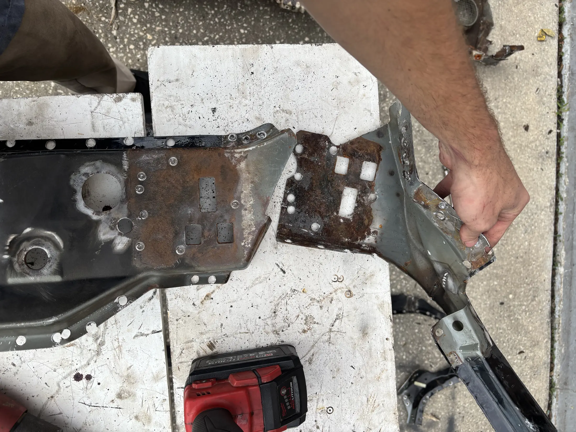

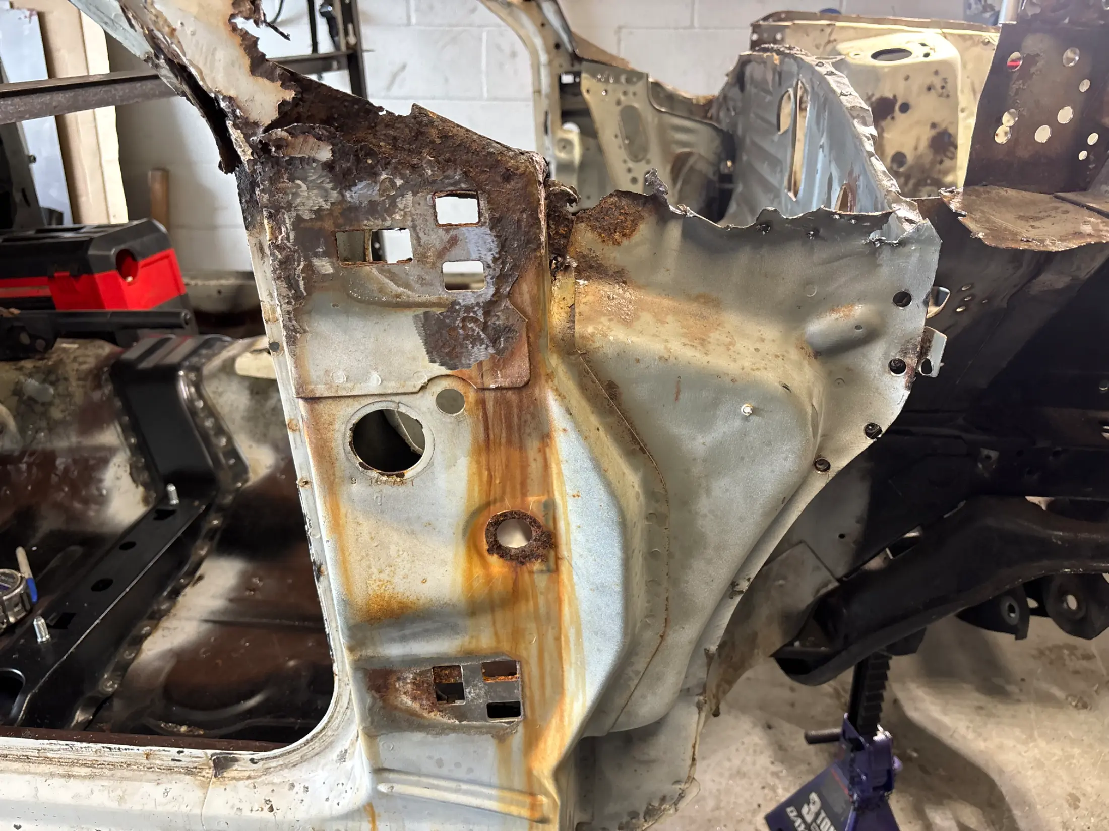

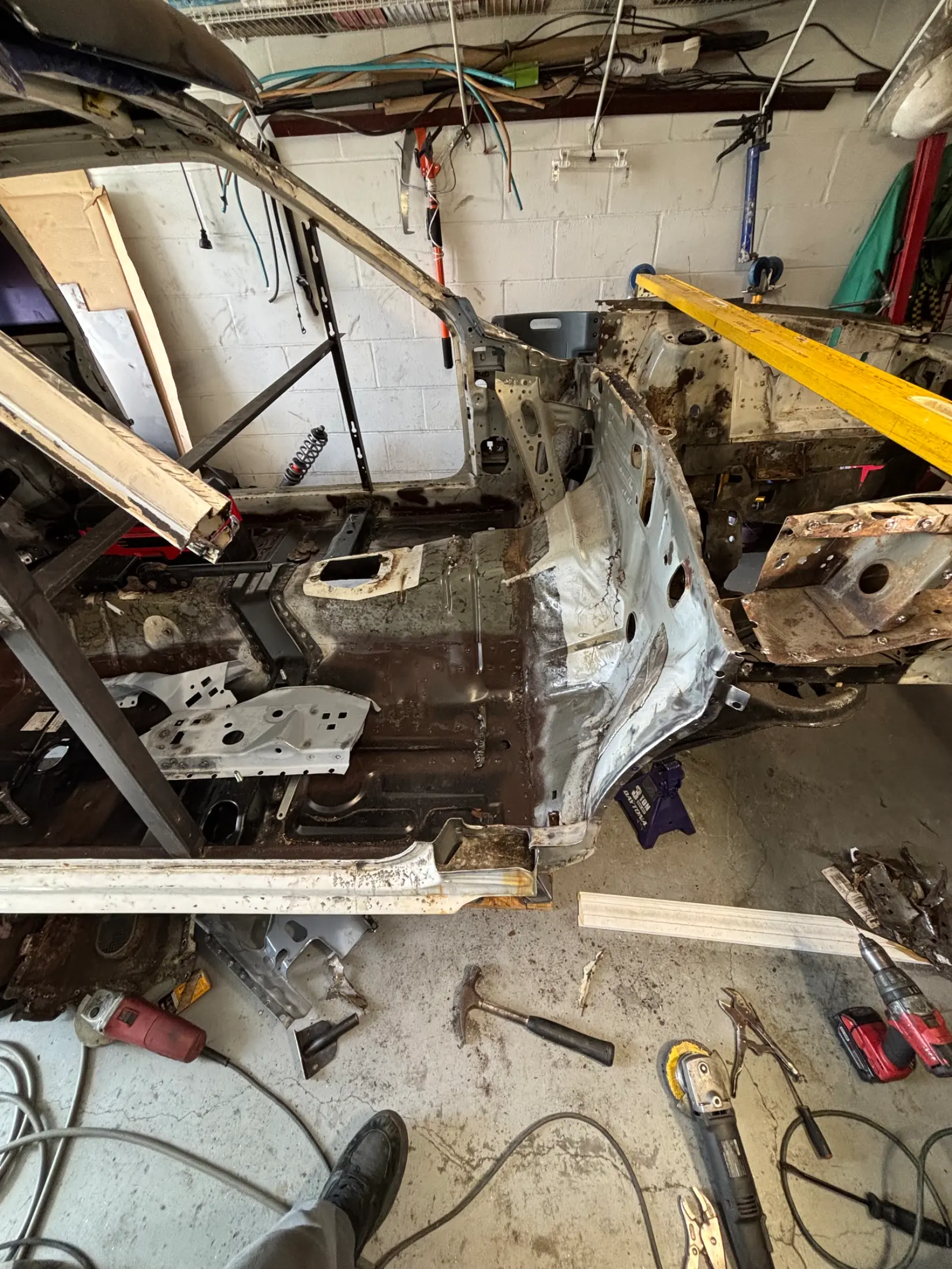

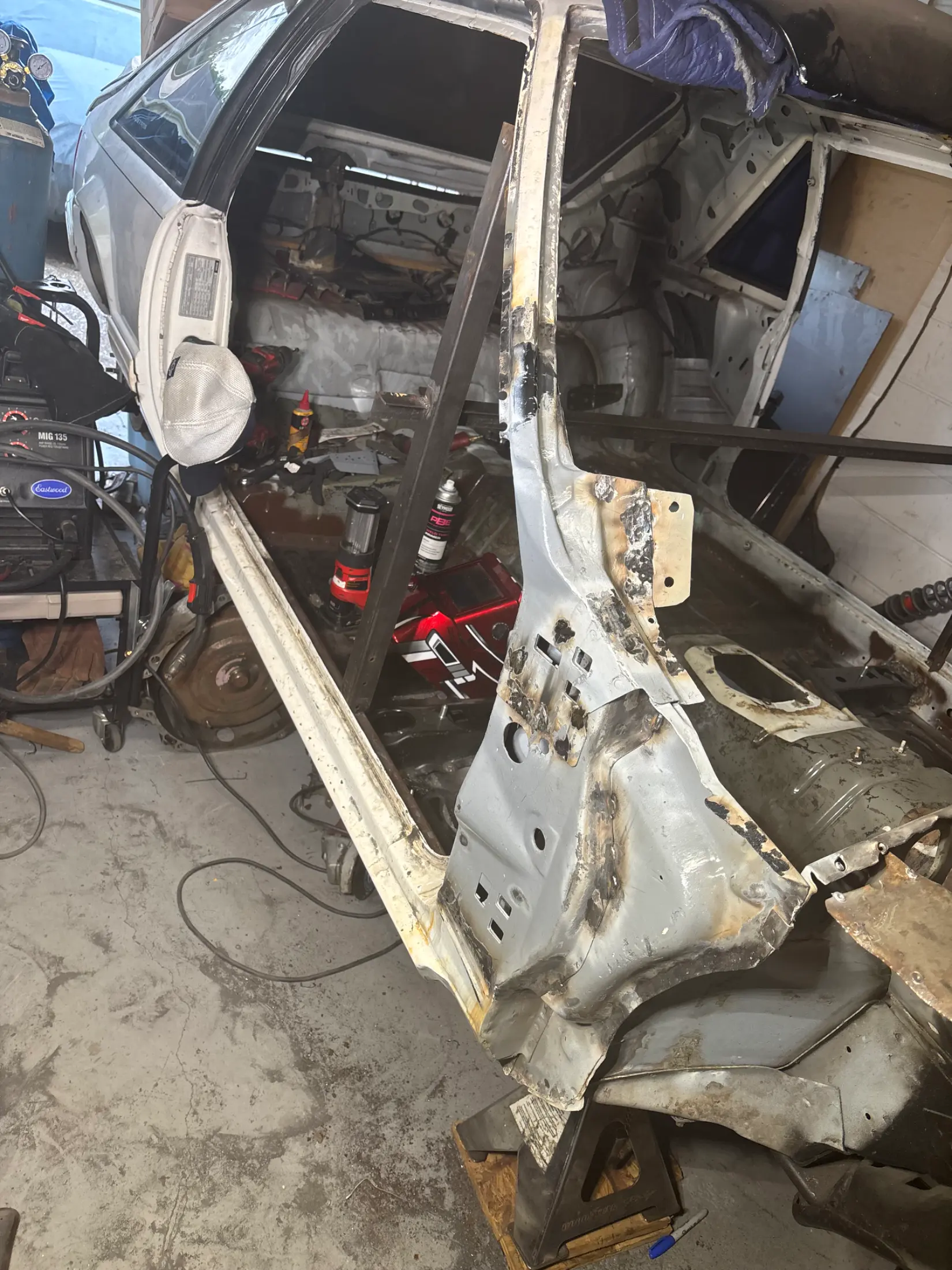

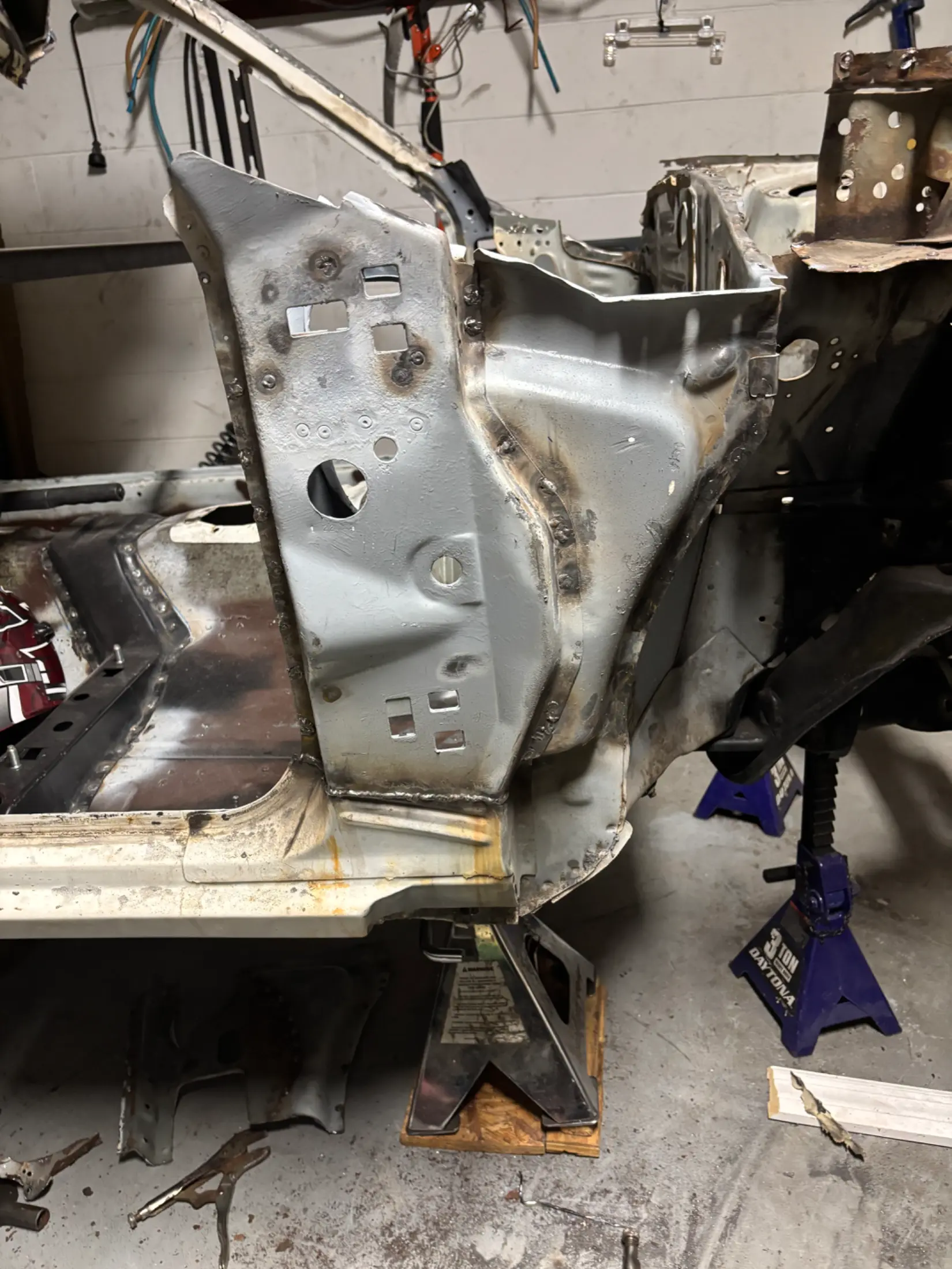

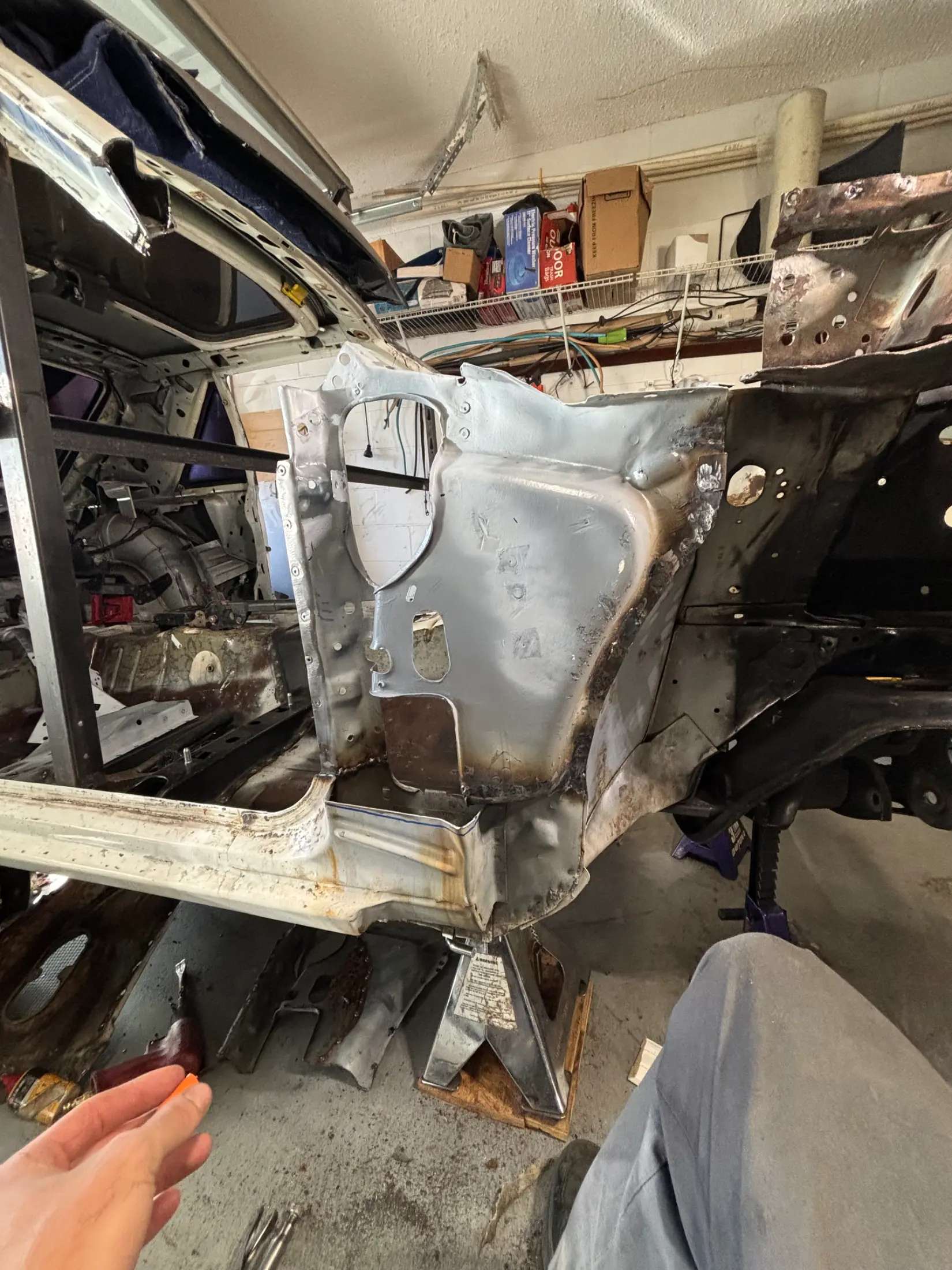

currently replacing door posts and lower cowl on my 93 fox. I fully separated the new doorpost via drilling all spot welds as i need to replace a portion of the passenger a pillar as mine has rusted and i didnt want to stitch weld around the entire a pillar. When separating the replacement post at the overlapping joints theres some pretty good hidden pitting i want to address before reassembling/installing not looking to do this job twice.
My question, im working with eastwood rust encapsulator plus that i plan scuff and apply to the undercarriage and cowl upper and lower and also the engine bay, those areas have minor surface rust and ive cleaned off nearly all the surface rust before applying. Would that be a suitable plan to apply in these overlap joints on the door posts? My only concern is obviously i cant weld through it nor would i want to and if i tape off all the spots for plug welds applying a weld thru primer over pitted rust probably wont last too long. Seems im going to have to cut out the rust and replace it with clean metal before i reassemble guess im just looking to hear thats what i gotta do

Got any pics to see ?

This is for passenger side for some reason is seems the passenger side gets it worse both on my car im repairing and the donors door posts. On the bright side driver side is a breeze to fix

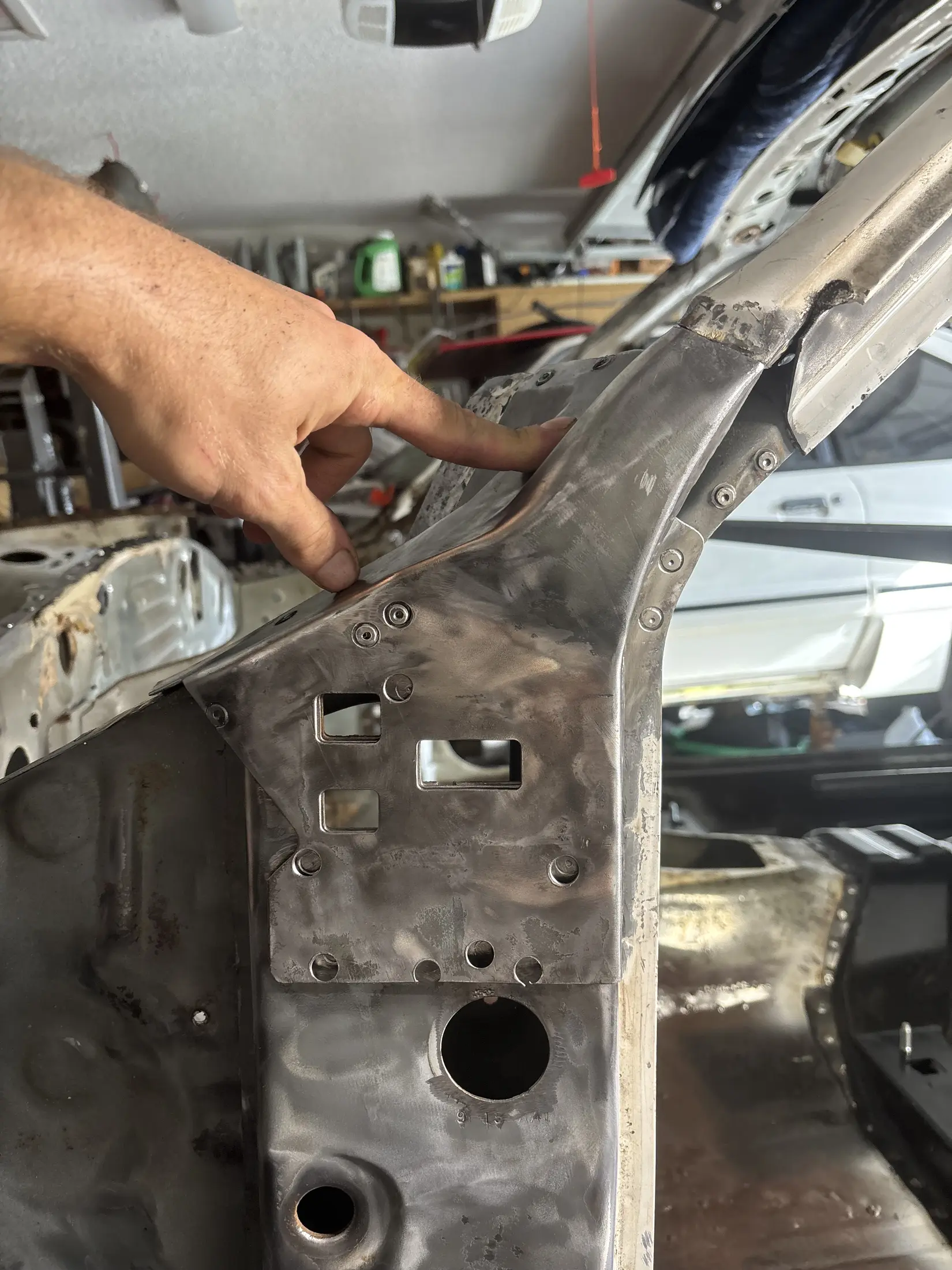

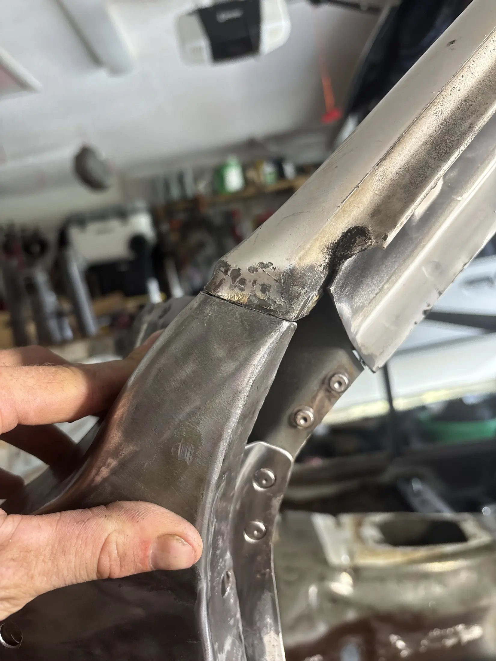

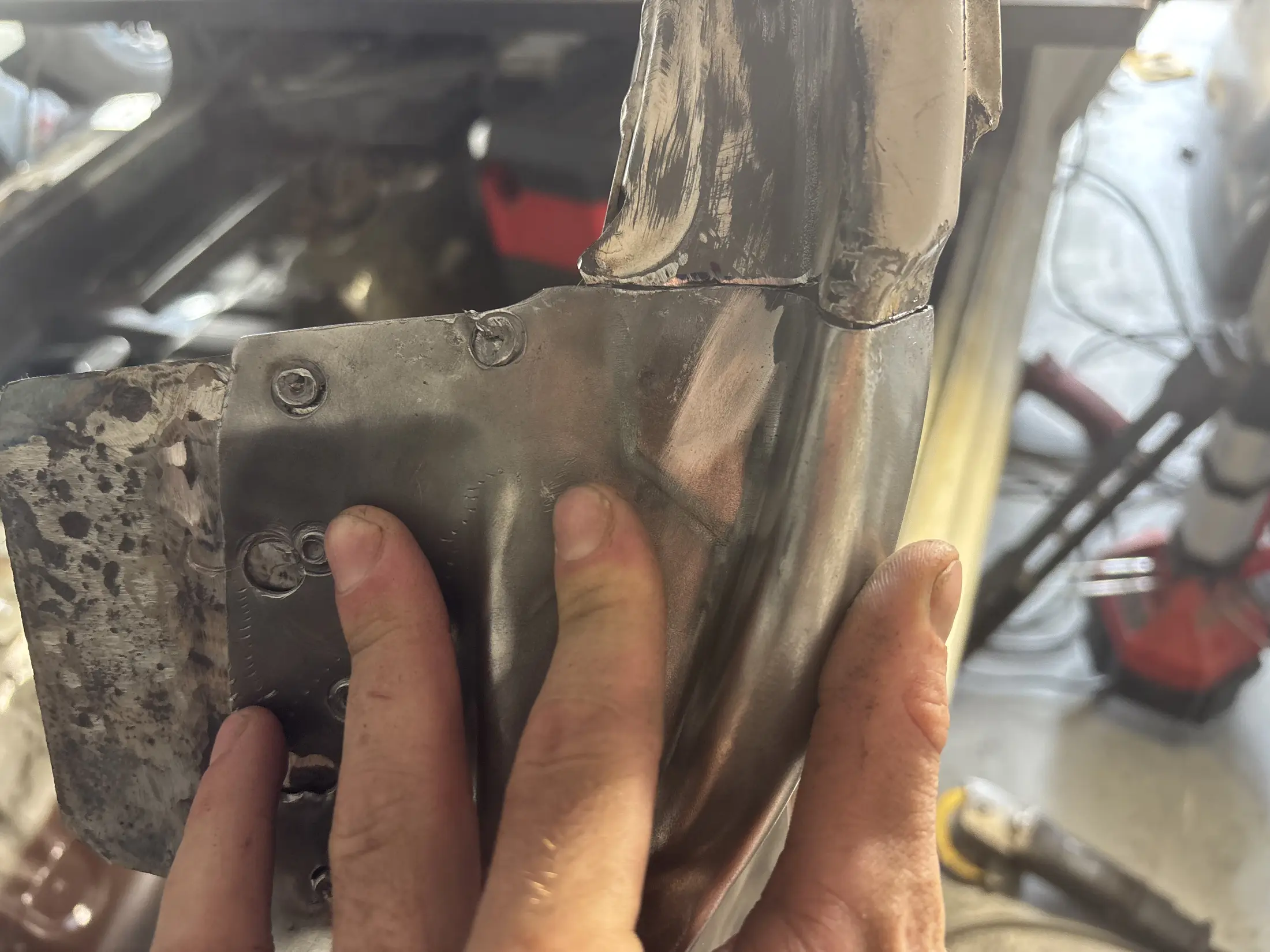

Oh perfect im glad to hear i ended up wire wheeling and lightly grinding down the metal shown in the photos and coated with eastwoods rust encapsulator ground down n sprayed weld thru primer on the spot weld areas im thinking about urethane seam sealing the over lap joints on the door posts in attempt to lock out the ability for moisture to get in smoothed down and painted over id highly doubt any eye would noticed other than my own once finished

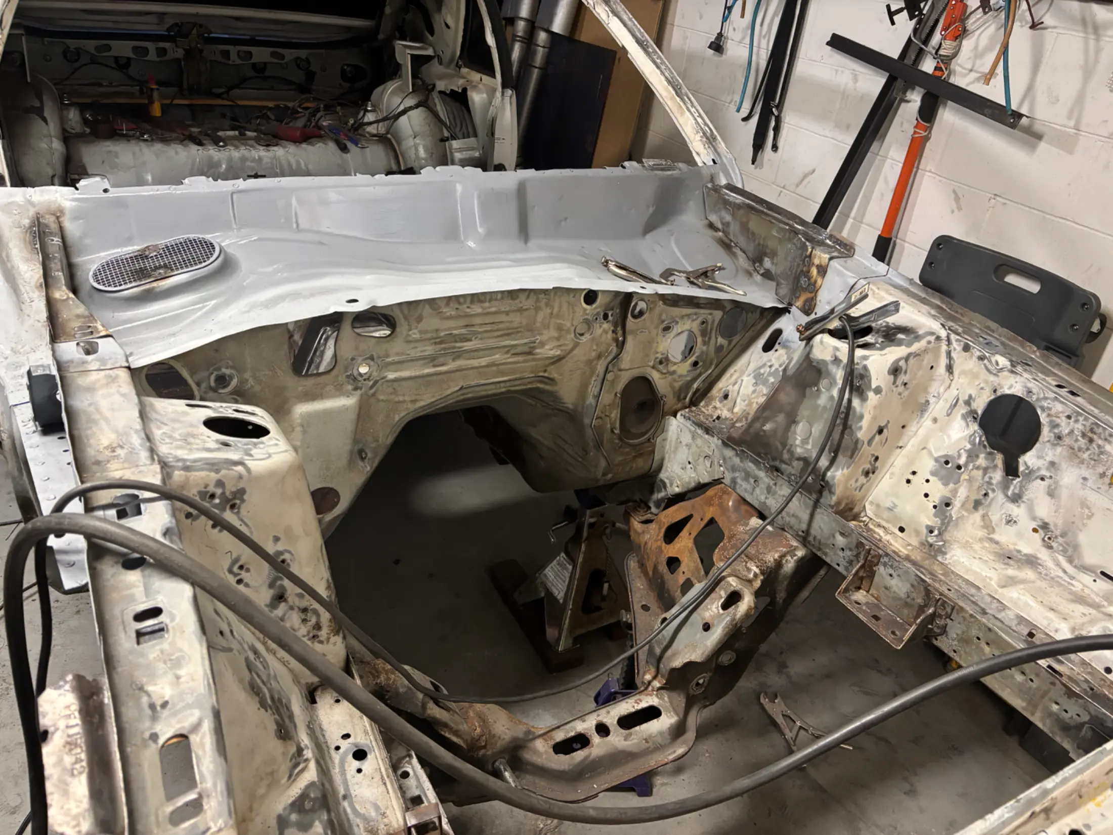

I appreciate it is absolutely was alot of work, 5 12 hours days to do the door post repairs and that was starting with the car gutted. Im big on doing it right one time. Figured id post these up so anyone looking into doorpost repairs knows what entails as i couldnt find anyone showing these photos. Got the lower cowl on almost back to lookin like a car.

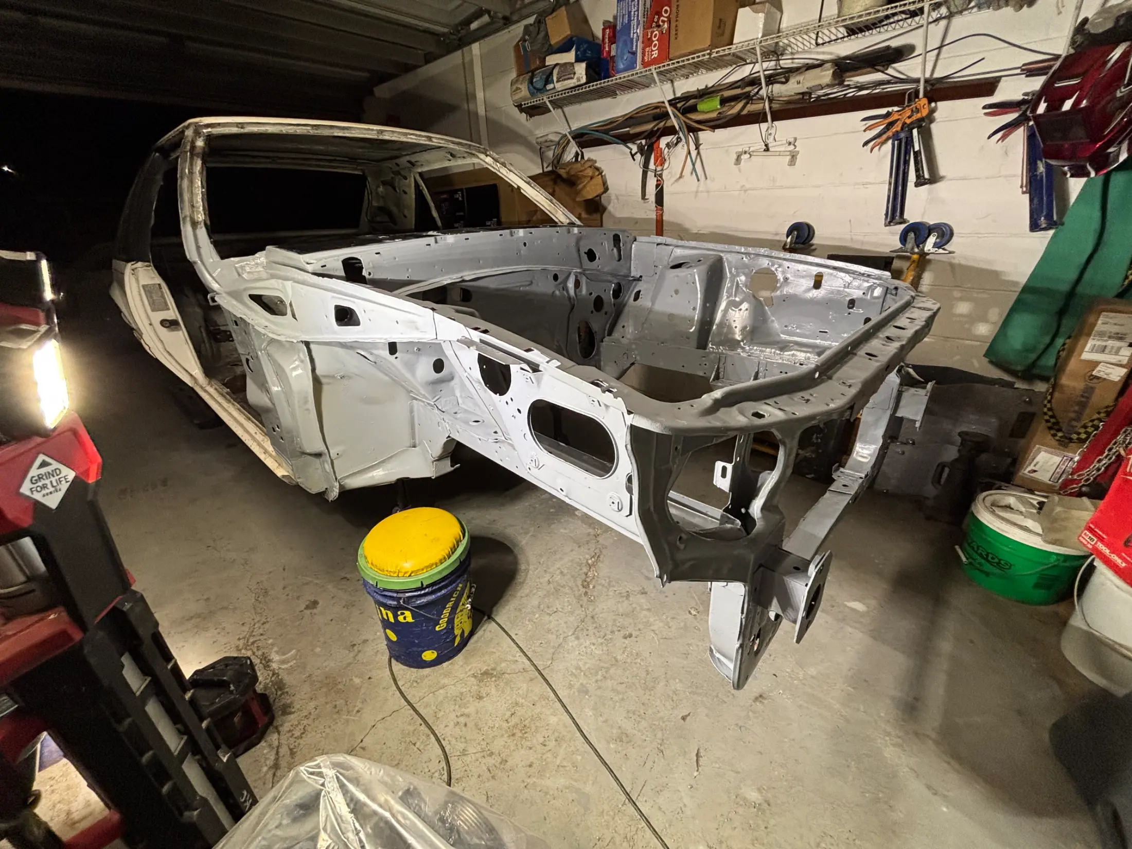

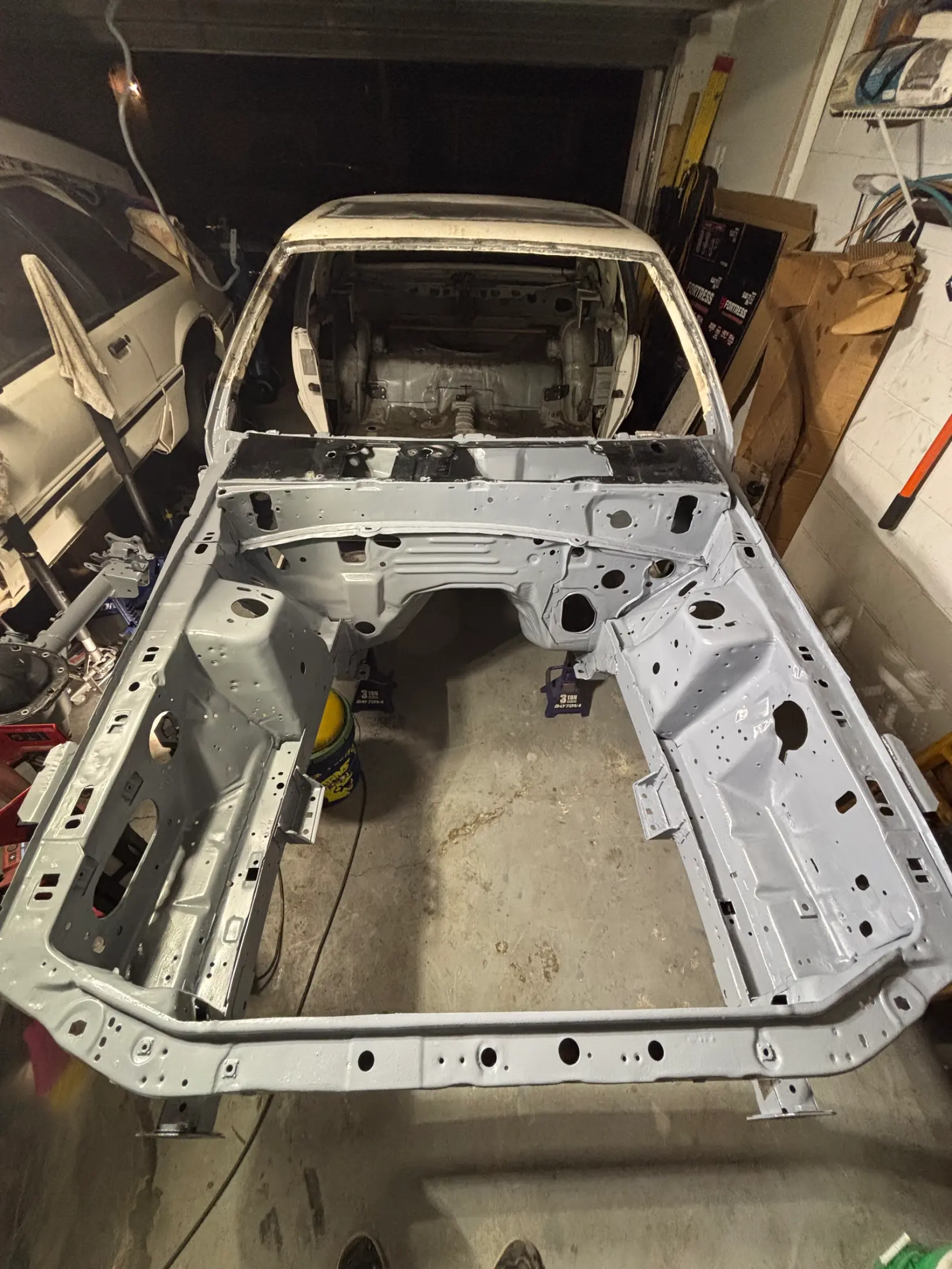

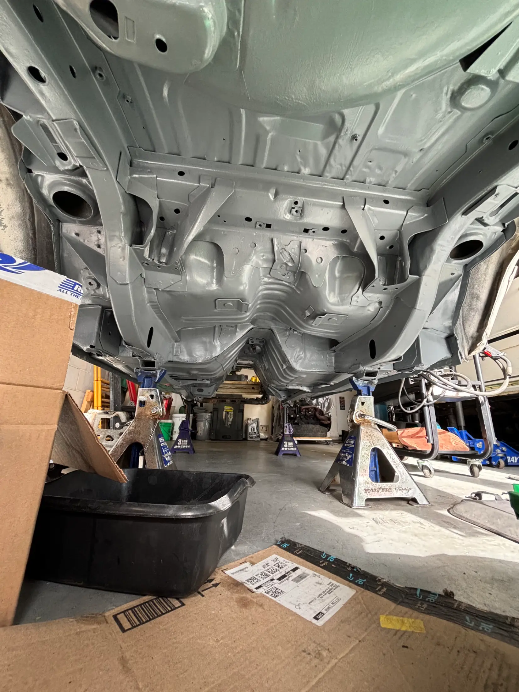

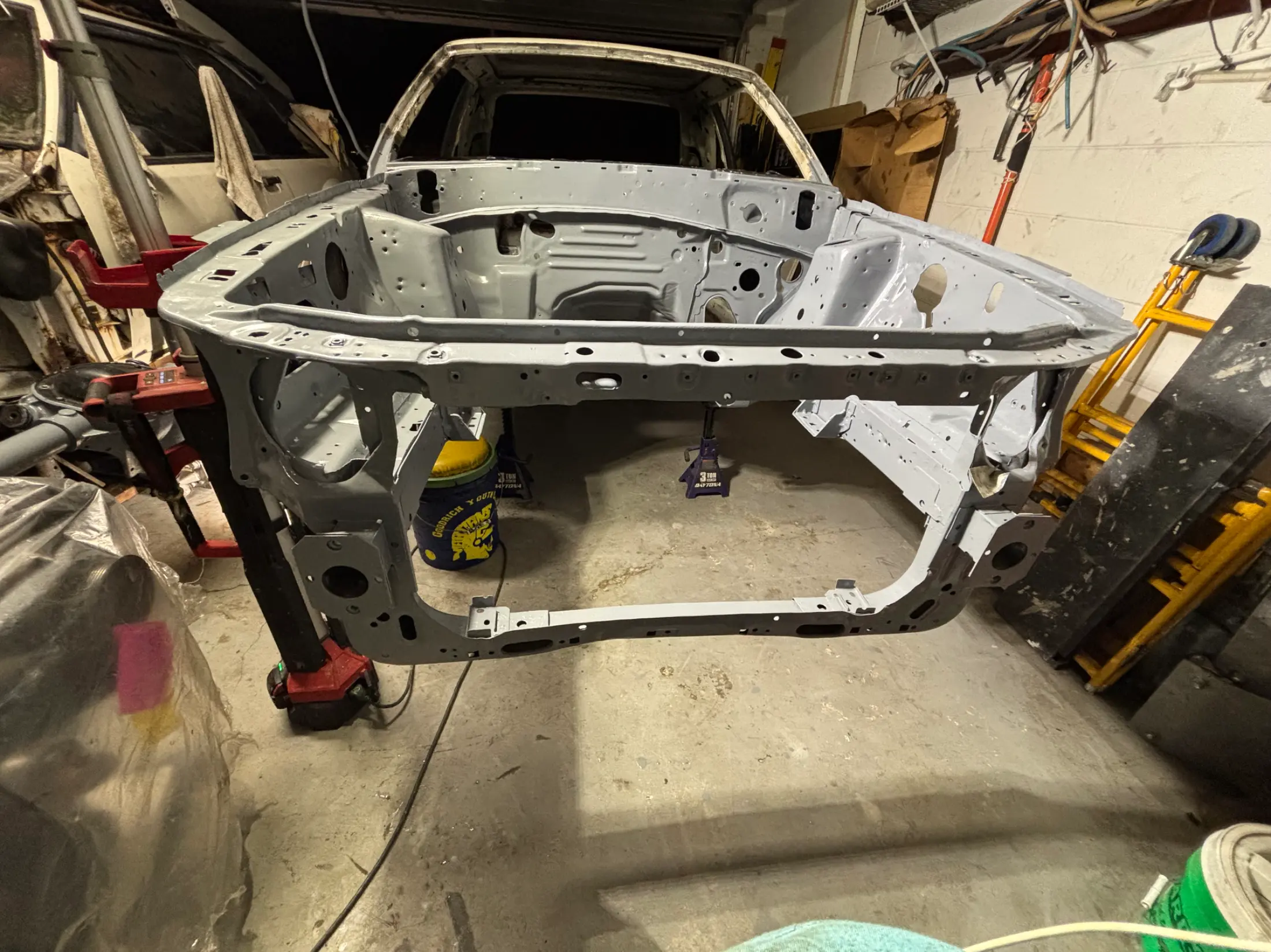

Incase any are still interested in the journey undercarriage and engine bay coated in epoxy after a ridiculous amount of hours cleaning up all the metal. Starting to come together, unfortunately i wasnt able to get my hands on a solid roof skin for a reasonable price to i chose stitch the sunroof closed have quite a bit of hammer and dollying to get it right then itll be time to do the bodywork and prep for paint. Decided on tungsten grey metallic couldnt find any foxes painted this color hopefully itll look good. Will post more when paint is down
