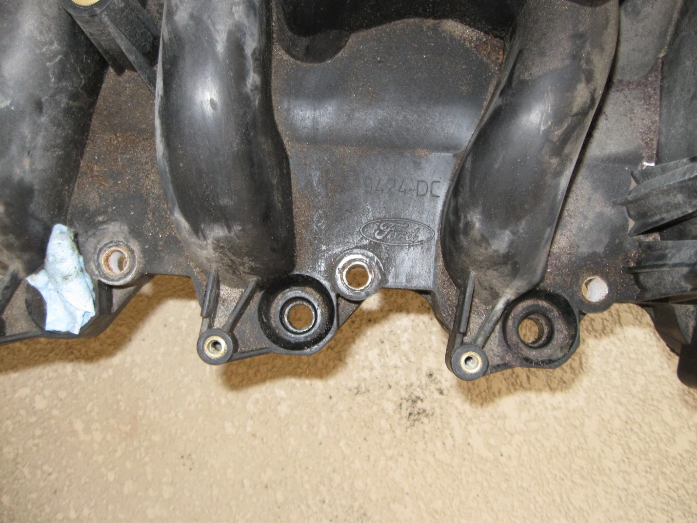

Now, here is a pic of my (formerly) trusty intake. You can see (sorry I had to shrink the image for this site, of course) The squared off interface for the injectors.
On the Dorman piece (and I'll leave it at that), the interface is kind of "cone shaped" , like an inverted volcano.
To get the car running great again should I just "hammer" the injectors into the volcano, or order a new manifold. the vendor probably soes not want a return since this manifold is now "used".

I would not take a hammer to the injectors; that is just asking for trouble. Have you tried tightening down the fuel rails some to make sure the injectors are all seated properly? I can't remember if my Dorman Intake had coned shaped interfaces or not, but I'm sure they did. I'm sure someone else more experienced than me will chime in, but it seems like if you had an issue at the injectors not seating properly, then you would have a fuel leak there. If you don't have any fuel exiting out near this area, then I would say you don't have a problem there (other than maybe a bad injector).

Here is an UPDATE:
I found the huge vacuum leak. A vacuum hose runs from the rear of the throttle body and makes a junction with another hose on the passenger side valve cover (down, and to the rear). That hose looks as if it leads to the HVAC controls.
Thanks to all who replied. Thanks also go out to "RedDaemon" for his excellent writeup and pictorial !!
