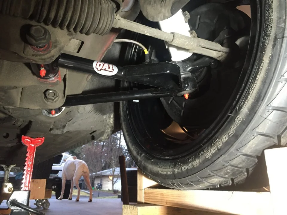

Ok, near the end of collecting parts for the 5 lug swap on my 88. Looking to get double checked before I do the job. * = parts I still need .
Parts list
01 bullitts with tires
Lug nuts
94-95 spindles
94-95 front and rear calipers with brackets/dust shields.
Front/rear soft lines/ rear hard lines off 94 -95
Passenger side line adaptor
95 gt master cylinder and booster
* proportioning valve plug
* adjustable p valve
* 3-2 adaptor
* e brake cables for disc.
* fluid
* rear differential cover gasket and fluid
I think once I get the last few things I should have it all..
