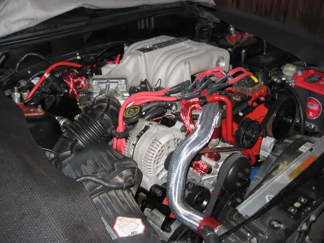

Agreed, they give no real advantage over rubber hoses. But you can get them in different colors, so it's one way to pretty up the engine bay. I bought a kit to replace my vacuum lines, you can see one in red in the upper-left corner of this pic.
