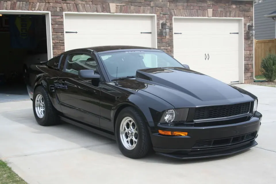

front rims are 15x4 jegs stars, with a 7/16th spacer. could of went 3/8's but a little grinding is involved of the caliper. front tires are 165/80/15, kumho power stars, 45 bucks a piece. rated to 118 speed rating. i'm running ET lugs on the front and i recommend them with the jegs wheels. you can use stock lugs if you want though. no harm.
back rims are where it got expensive. i wanted a 15x10. no one makes a cheap 15x10 that will bolt right on. so i went bogarts. 450 a piece for the back wheels. then 209 a piece for 325/50/15 nitto 555r out back.
you can get away with a 15x8 from jegs, that will bolt up. i think 6.5 back spacing. then run a 275/50/15 for 26 inches tall, or a 275/60/15 thats 28 inches tall.
there are more companies out there making bigs and littles for these cars, but alot of them don't recommend street driving, and alot of them are expensive as hell.
it can get pretty exciting with the bigs and littles. drove about 100 miles to the beach yesterday with 3 other people in the car on some pretty crappy roads. we managed. you just gotta be careful.

the fronts i know some brands will have same backspacing and everything, but some brands will fit and some wont. i tried my brothers draglites on same specs as my fronts, and his wouldn't clear my brakes at all with the spacer.
back you can get away with a 15x8 with a 6.5 back spacing, pretty much everyone i've seen use that set up hasn't had a problem. i know the 15x10s i have on mine now the brake is extremely close, but no rubbing or anything.

Here you go....this is a pic of my friends 08 bullitt with drag radials and skinnies:
He had these custom made, the rears are 15x10 running a mickey thompson sportsman tire
That is perfect-like the stance-tire sizes-wheels etc. Can I get some info on tires he used-did he lower it-wheels and sizes--better yet just swap with me.:hail2:
Front: 15 X 4 (26 X 6)
Rear: 15 X 10 (28 X 12 X15)
Rims are Centerline Revolution rims
Tires are Mickey Thompson S/R radials
Not sure the tire info is correct, but thats what he told me.
He has eibach sportline springs on stock shock/struts. And even though he claims the rims were custom made, he said in the rear he had to grind the crap out of the calipers.
