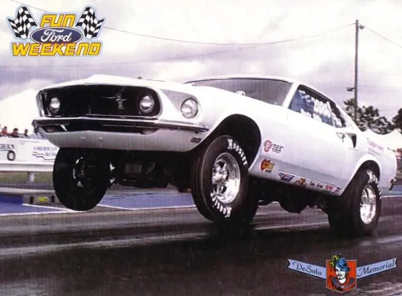

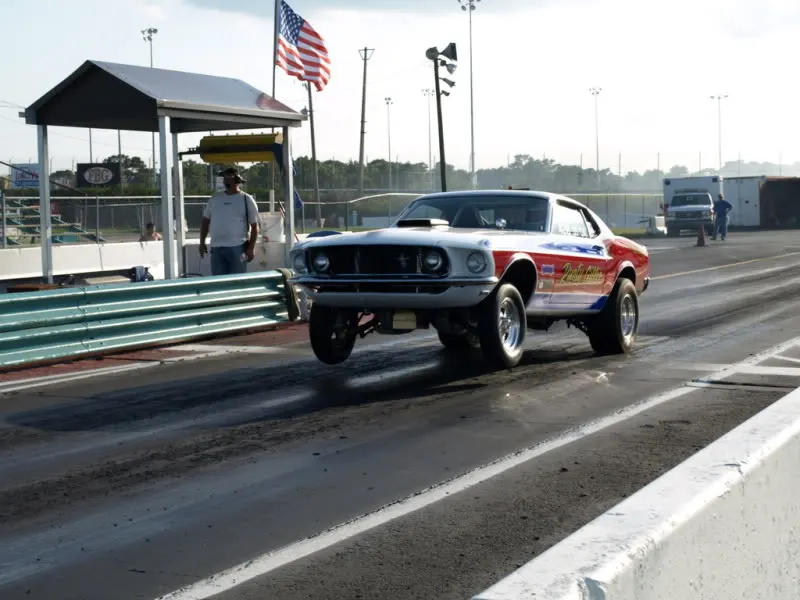

I did the Shelby drop on mine over 10 years ago and it does transfer weight.
After I restored it in 2005 at a track that wasn't prepped very well launching at idle. Opentracker upper and lower control arms and roller spring perch.
