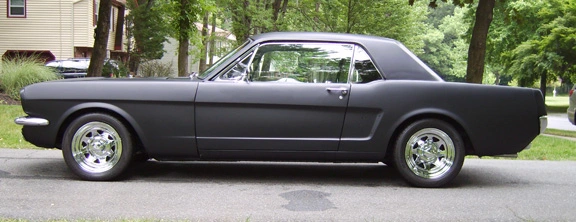

i have my car looking exactly the way i want it to. im in love with it every time i see it. BUT it doesnt fare well at the strip.
there is NO weight transfer to put more traction in the back. im runnin 255 KDW's and tried them at 30,25,20,16 psi and no luck for getting them to hook. i have a limited slip (3.25 gear) and traction bars. there is NO wheel hop and both tires are turnin but im sitting still. with my suspension the way it is, what can i do to help? would it be best to leave the spare tire in the back? put a small kid in the back? (just jokin)

Maybe I'm blind, but I'm not seeing any traction bars in that picture . . .
If you have them installed, but they weren't installed when you took that picture, what traction bars exactly do you have? How do you have them set up?
From what I've heard, read and seen, people with a set of slapper bars set up right can hook with no problems on these old cars, especially with the power level your engine has.
More info needed here . . .
good eye stone cold. they arent pictured but they are weld in under-rider bars. im NOT wanting to use slicks cause i cant run them on the street, although i guess drag radials arent out of the question though.
How much more performance do you think to get out of a 216 hp / 269 tq engine with a 3.25 gearing and a LSD? What kind of tranny do you have? what kind of axels to you have? If you get slicks and your drive line ain't up to snuff, you just might risk breaking **** when you hook up.

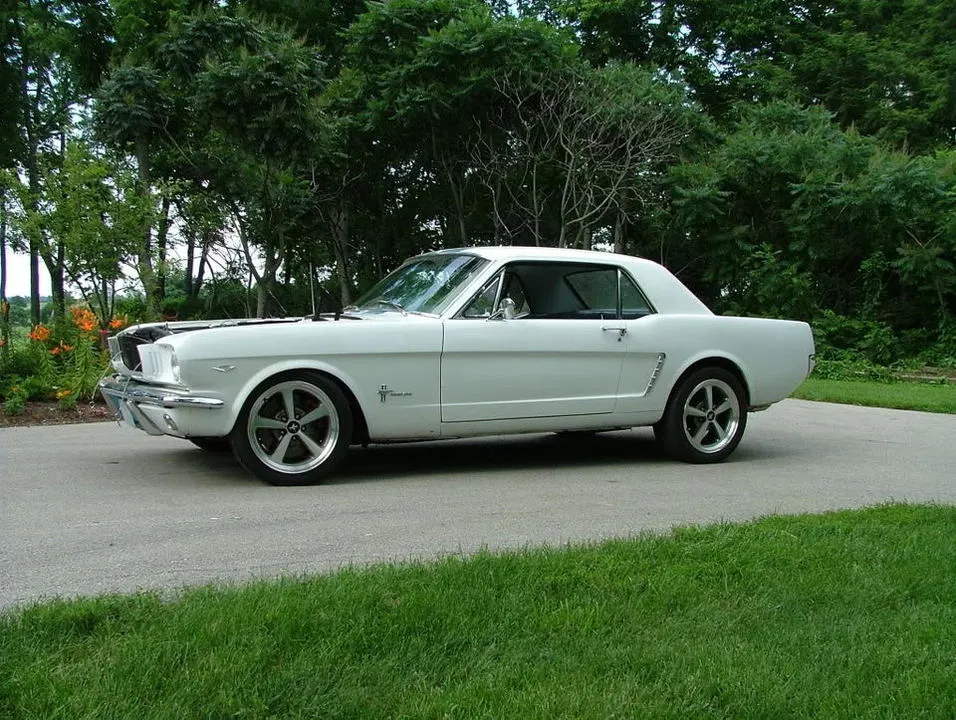

Cobain03 interesting thread. (For me anyway.) I'm running the following.
attachment.php
(1966 Mustang)
1990 302 bored 30 over
Holly 600 4 bbl
1966 Stock Ford Intake
Edelbrock Performer Cam
Stock 66 headers
Magnaflows
H Pipe
K&N 14 inch
1 Inch front lower springs
1 Inch lowering rear leafs
BF Goodrich G-Force Sports 225's
Slapper Bars (not shown in picture)
Limited Slip
Should be close horse power wise. Mine for the most part grabs, but I'm taking off at only just over 1000 RPM due to my tq converter. My best time was 15.1 @ 86mph Also if your tires are spinning then you won't have wheel hop. Once you get the tires to stick then you may have wheel hop. I have wheel hop on the street, but not at the track. Which I thought was weird. I thought it would be worst at the track because of the track being sticky.
