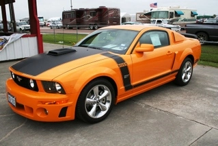

I am trying to research drag radials for the torque thrust 18" stock rim. I belive the size of the rim is 8.5" wide and I am trying to find a drag radial. All the ones I have found thus far recommend a 9" wide rim.
Is anyone running a drag radial on the said rim and if so what size?
